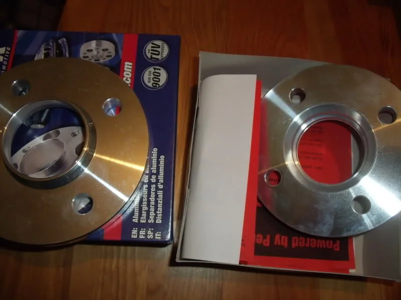

I ordered 26mm hubcentric spacers from FK.
From what I'm aware of hubcentric have 2 sets of 4 holes? 1 set to bolt onto the hub, the other for the wheel?
So are these the right ones?
the type you are talking about are generally reserved for 40mm onwards,they are correct,you need to order longer wheel bolts that are 25mm longer
looks like you've ordered the wrong ones mate :( did you get system b?
mine came today and had 8 holes in, the big holes are for bolting to the hub and small holes for wheel

if you click that (or just go to website home), click wheel spacers and adaters and it asks which 'system' you want
the ones that bolt to the hub are sustem b and b+, i think yours might be a
40mm per axle (meaning 20mm each side :rasp:)
not sure about the bolts but i'd replace them with the system b ones if i were you

EDIT: what a r****d I am, 26mm meaning 12mm either side. Does that mean i will need longer bolts for these?
Id get system be thats what i have (50mm spacing 25 either side) Bolts to the hub then wheels to the spacers !
