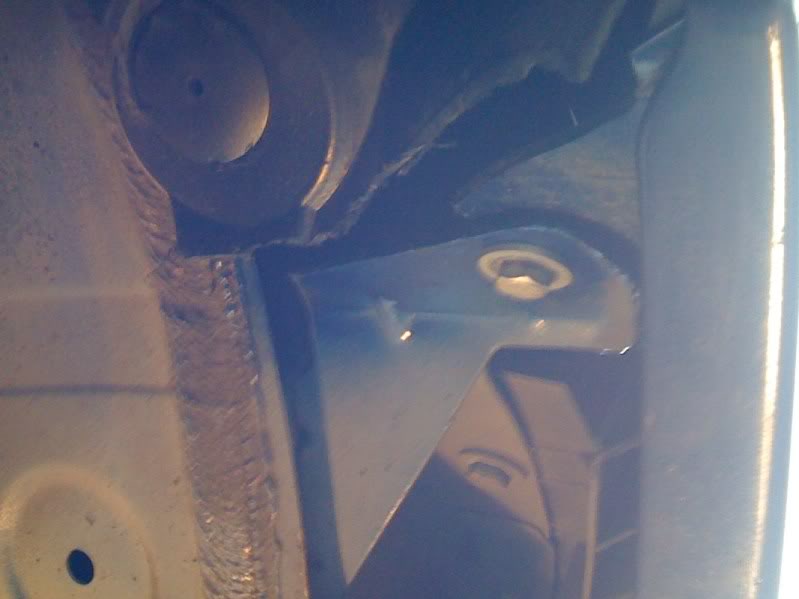

What exactly does the bumper bracket look like so i know what i'm looking for

The bumper bracket cant be missed, look under the front arch and if you have been cornering hard enough it will have broke through the liners ;)

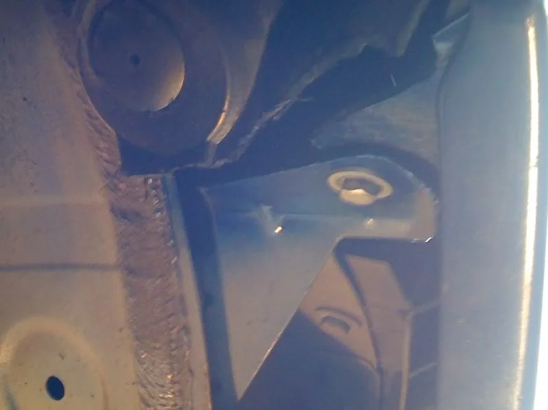

Bracket looks something like this...
I trimmed mine back (as shown) and haven't had any problems since. Hardly trimmed any either! You can also see how awesome my arch lining is. lulz.

So is yours modified si? Did you have to ruin the arch liner much? I've just paid for one from work and it wasn't that cheap for what it is so i'm a bit nervous about butchering it up.
jenic
Dont some people cut it vertically, like where the shadow falls, and sack it off altogether. I have just whacked mine in a bit with a big hammer :D

I wouldn't bend the bracket if i were you... as the plastic part of the front bumper is not easy to modify. If you bend the bracket you'll adversely affect the fitment of your front bumper.
You could quite easily trim it as I have without changing your arch lining (I think :eek:). The only reason my arch lining is like that is because it Jettisoned itself on the way to the Nurburgring!

Si mentions the bracket: you can bend it up without effecting the bumper, ok it's a bit more of a pain to get the bumper seated on top of it, but it makes no difference to the appearance of the bumper. I also think it's worth doing as I have seen examples where people have lowered the car, gone for a hard drive and the tyre has caught the bracket so significantly that it bends it downwards!

At least it gives me something to have a go at. First and foremost I need to sort the bumper bracket out - Does thismean I will also need to cut a slight hole in my brand new arch liner lol
