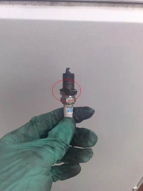

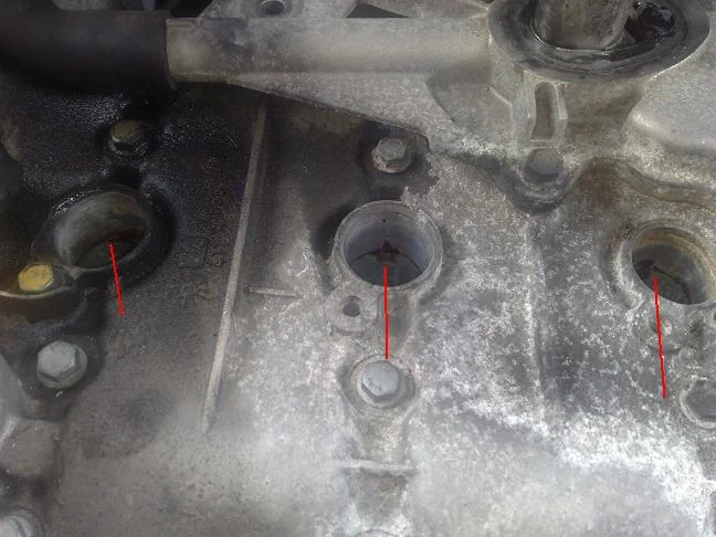

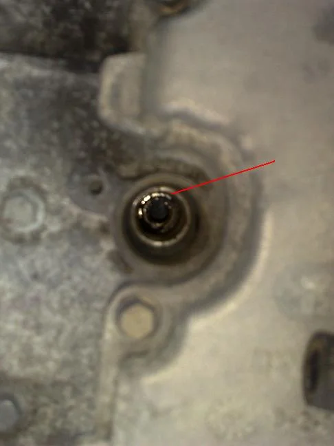

When changing my plugs today I came across what looks like a leak inside the plug chamber?
Also when examining the old plugs, plugs 3 & 4 has some nasty thick mud like substance on them and inside chambers 3 & 4 it looked like there was possibly oil mixed with dirt in the bottom??
Can anyone shed any light or any ideas what may have caused this?

A lot of them have a slight leak there, as long as the whole thing is not full of oil its not too much to be worried about. You also have a small leak near one of the bolts, again this is fairly common and doesnt look too excessive.
