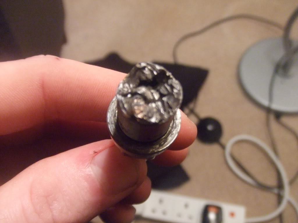

:S Strangest thing I have seen so far on the car. Unsure at this stage whether this is would be the cause of my engine to die or just a side effect of it happening.
Anyway the plug on cylinder 3 looks like this:
Engine just went OM NOM NOM to the end of it looks like.
When I whipped off the upper inlet there was small bits of metal which I now know was the plug.
So whats the story, what would have caused this? And what am I going to have to do to fix if it can be. Would the metal have caused damage inside the block?

I'm now guessing the end of that spark plug is in your engine.

Best to strip the head and see or try and get away with an oil change? Engine flush possible?
  RRS, 172, ST3, VTS
i would say that will have done engine damage, i would be lifting the head of before i stuck a new spark plug in.

s**t, what the hell happend there, could it have been down to a faulty/cracked spark plug that worn out overtime to make it like that...

Not sure mate, i'd say by the way its happened something has just munched into it if thats even possible. Im totally lost as to an explanation

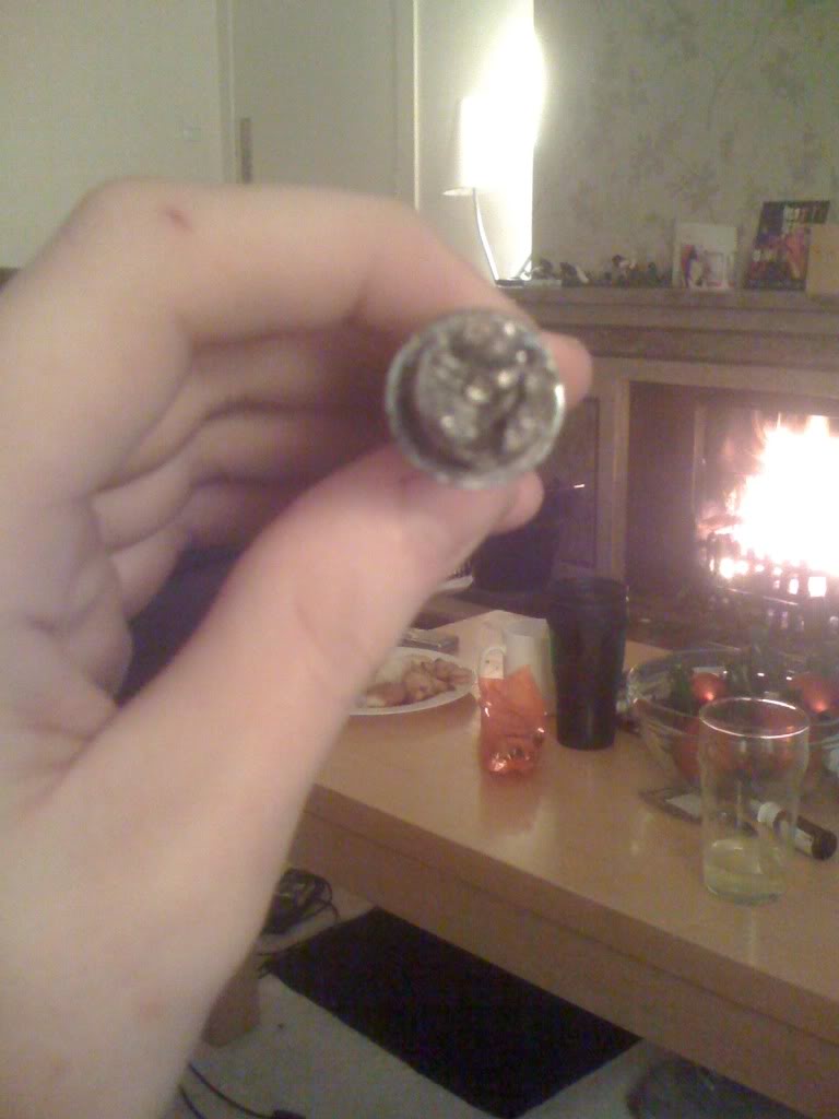

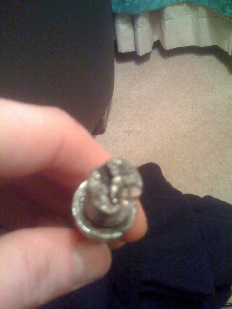

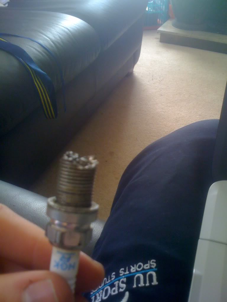

better picture of the end of the plug possible? could be detonation caused by contaminated fuel?
Thats what happened last time i saw a plug like that ( another 172 )!! Even punched a hole through the coolant gallery in the head and lost that!
I had just put in £15 fuel after being well into the red light actually!! I'll get a pic of the end of the plug for you now danny

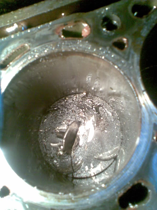

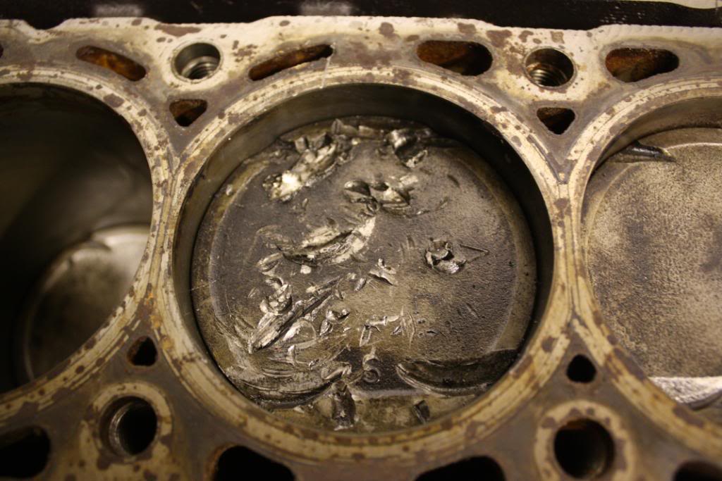

Seeing as we're adding pics of interesting looking piston/valve/head combos I thought I'd add a couple of my own!

So what might have caused that danny? Strip the block and look for damage then or new one you reckon?
  ITB'd MK1

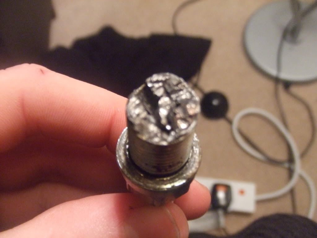

well, in theory it could be over-revving. Seen them go on engines that have been living on the limiter too much. But there's also a fault that renault acknowledged in a tech update

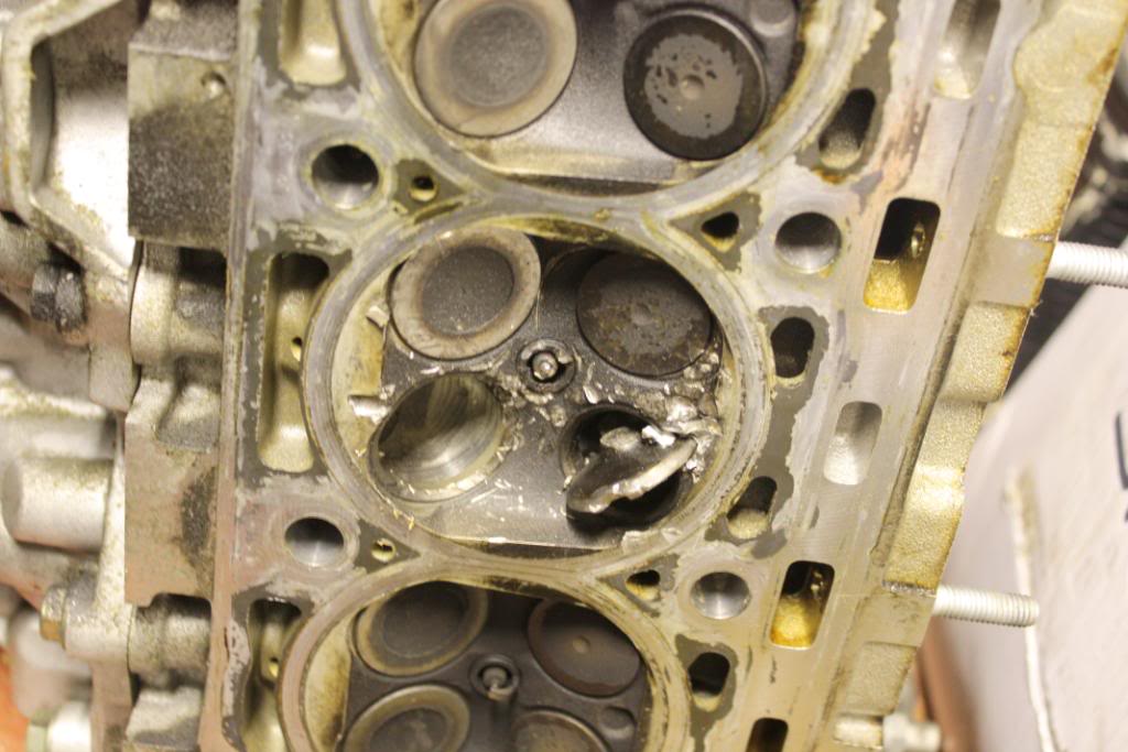

Valve dropped off and mashed the end of the plug is a possible
A guy in Australia just had exactly that happen, but in his case spark plug couldn't be removed.
Here's a pic of his head:
Note the spark plug in the middle still fitted, and valve wedged in sideways!
  Better than yours. C*nt.
Also seen strokers run lean, piston melts and when it stops running, you pull the plug and it's full of piston-metal.
That's usually expensive too.
