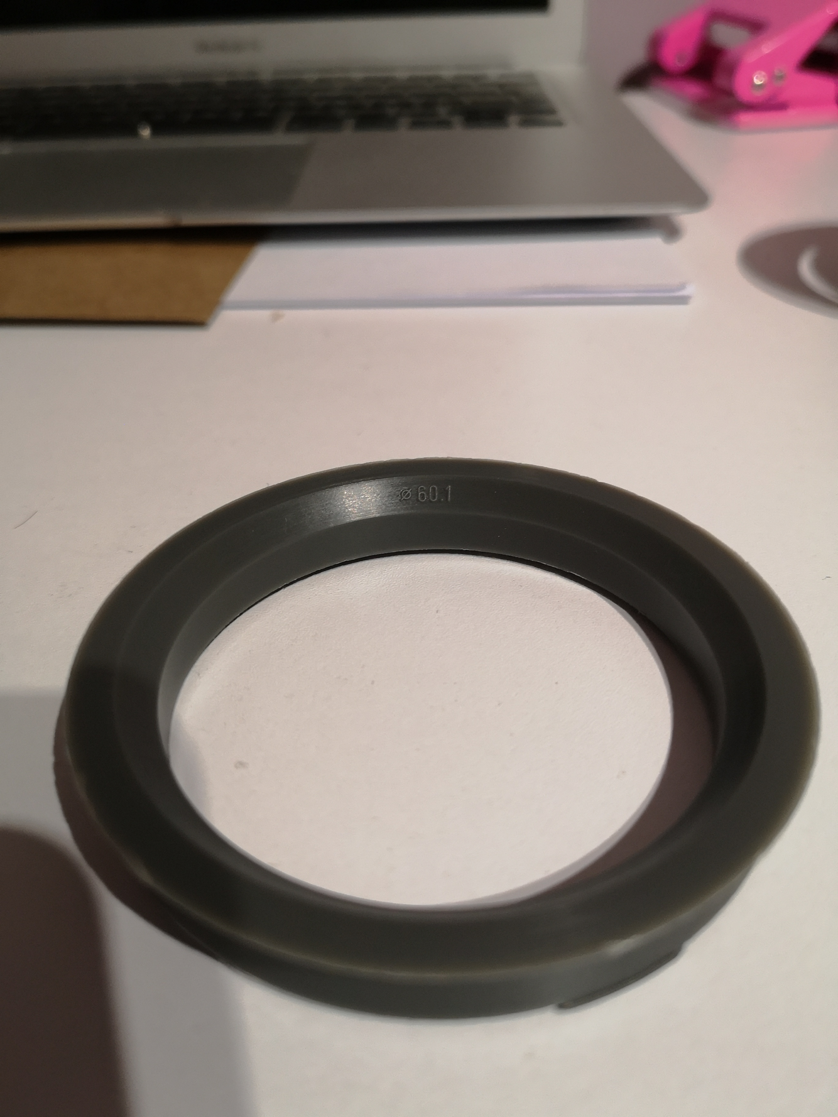

Hi,
I've bought a set of 16 x 7 speedline turinis used on ebay in et35.
I need the spigot rings as the bore on the wheel is slightly larger than the cars centre bore
Could anyone direct me to a set of spigot rings in the correct size?
Apologies if I have missed any info!
Thanks 👍
What’s the bore of the wheels?
You need whatever it is : 60.1 to fit.
I'm not actually too sure, I'll whip a wheel off tomorrow - I assume it's stamped on the back somewhere if not I'll have a measure up...?
Is there anywhere recommended to buy new rings from? I can see either metal or plastic rings?
Thanks
Let me know the size you are after. I have a brand new set of rings that I bought years ago. 75/76ish>60.1
I melted my plastic rings on the track. The wheels did come off, just needed significant persuasion with a boot, which is not what i needed at the end of a long day.
I had to try a few metal rings to get one that fitted, the depth seemed to vary a lot on the ebay ones.
Quick update, took the wheels off today and measured the centre bore. It seems originally they were 60.1 but have been bored out to 70.1mm so have ordered some Bimecc spigot rings which should sort the issue.
Thanks again for the help 👍
