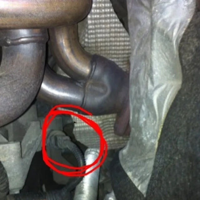

I took this pic of mine the other day to check it was the right sensor and I've been told by the CS gurus that it is!
