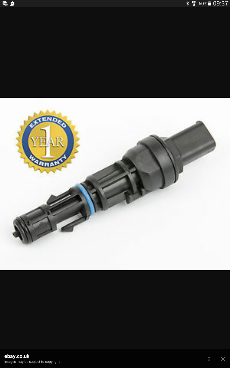

Just a quick question before I order this: is the speedo Sensor the same part on 172 cups as it is on the rest of the range? Only asking as they go in different areas.
Thanks
  Clio 172 Merc ML55
Look like this mate
-Simon
  172-E92 M3-ZT V8
Cheers mate. Have seen them on eBay just wanted to make sure the part wasn't specific to the cups. Thanks.
  Clio 172 Merc ML55
No mate theyre all the same, I bought an eBay one originally which lasted about 3 months, genuine one was about 30 quid from memory
