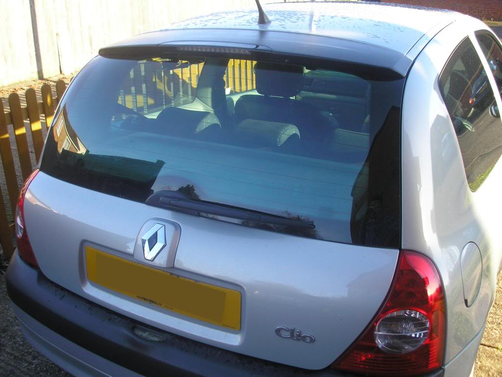

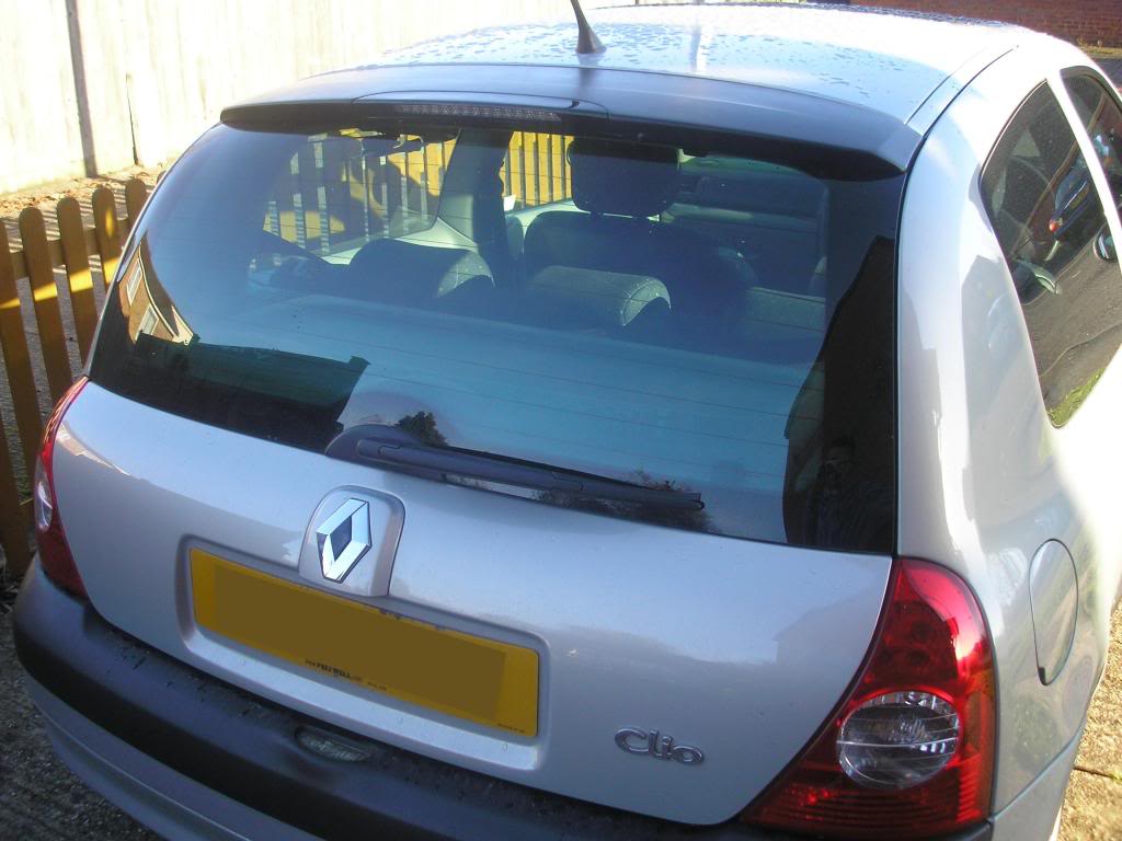

campus sport/dynamique/RS 172/182 non cup style will fit:

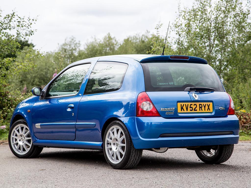

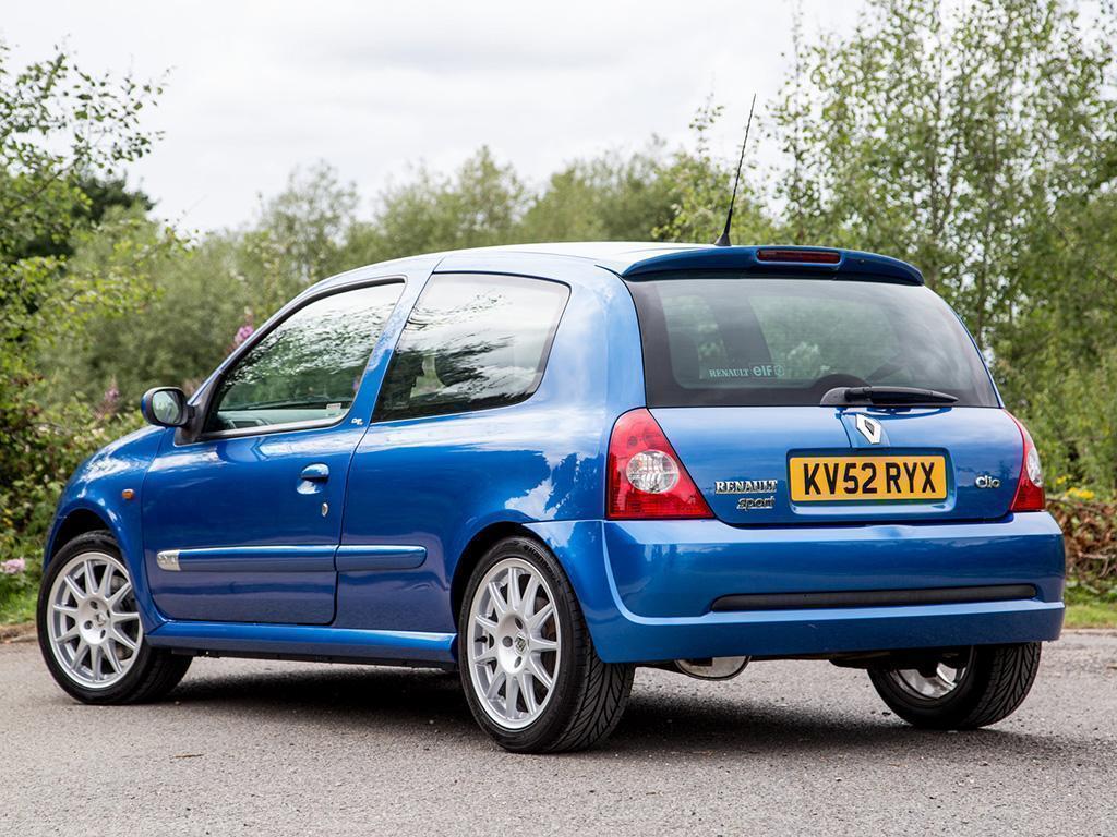

As will the cup spoiler:

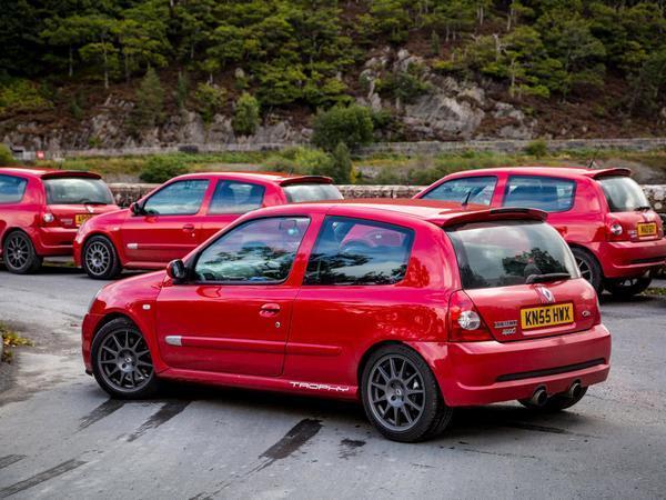

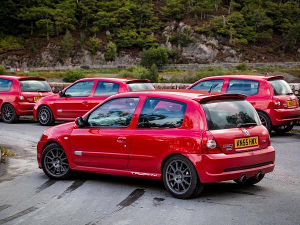

and so will the Trophy/V6 spoiler (if your picky you will want shorter boot struts to stop it catching):
