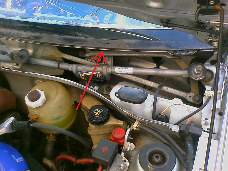

hello is there a Pic to help please
Darren S
Nabbed from another user - it's underneath the bulkhead around here. With the wiper mechanism out, you can easily see it.

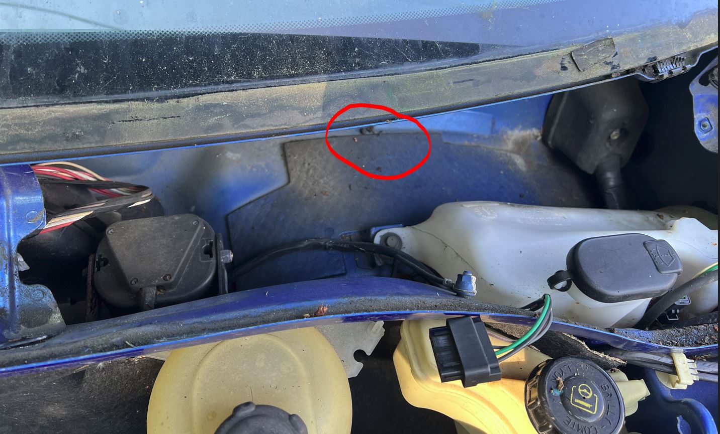

I found this pic from when I cleaned the drins - the spiggot is located here - roughly - welded to the bulkhead
