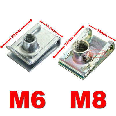

And I know you haven't asked about these, but if anybody wants new clips/fasteners for the front bumper where it meets the wing, you want these (M6 spec).

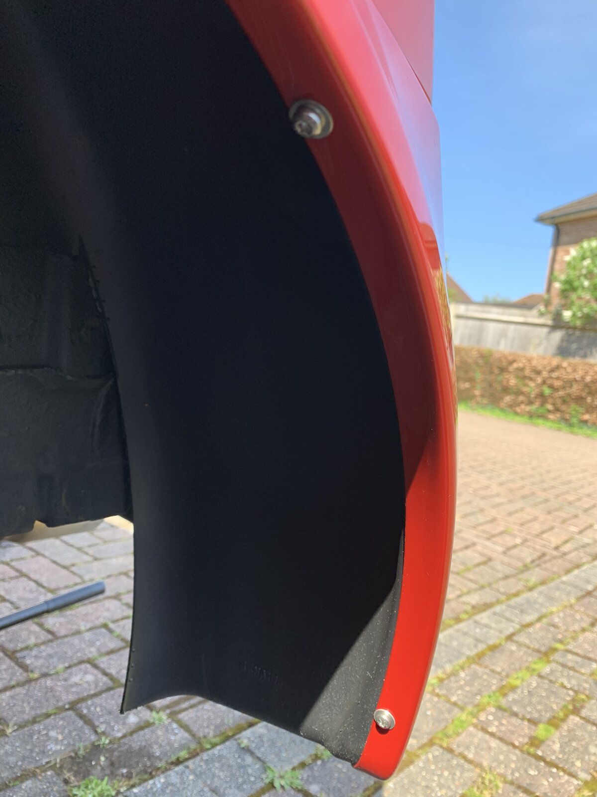

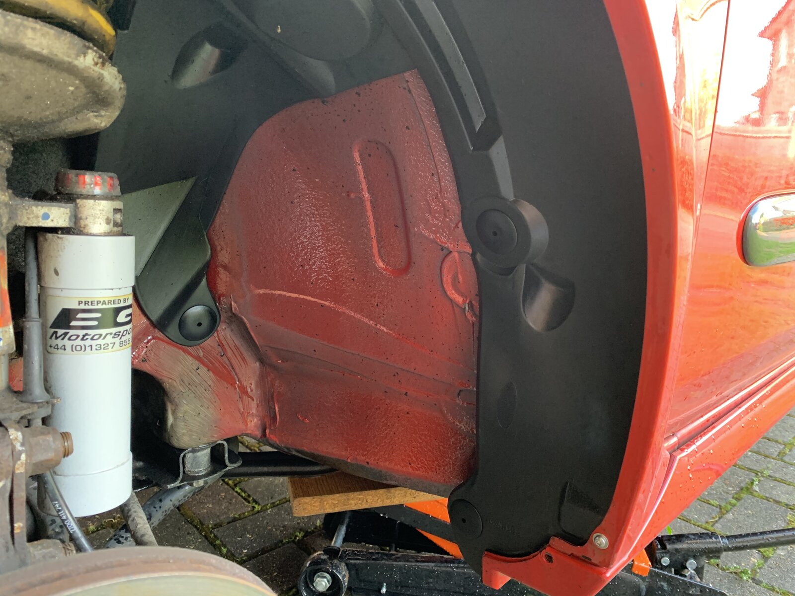

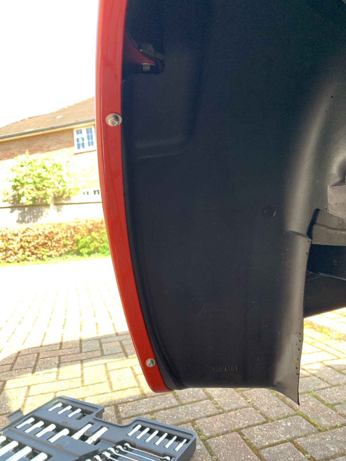

To give an idea of how they looked on my Trophy...

Awsome, thank you 👍
Thanks Ash J, these are spot on what I'm looking for! Needing a bunch of u-nuts for the arch liners to join the bumper as well for my non-cup.
Cheers for posting.
