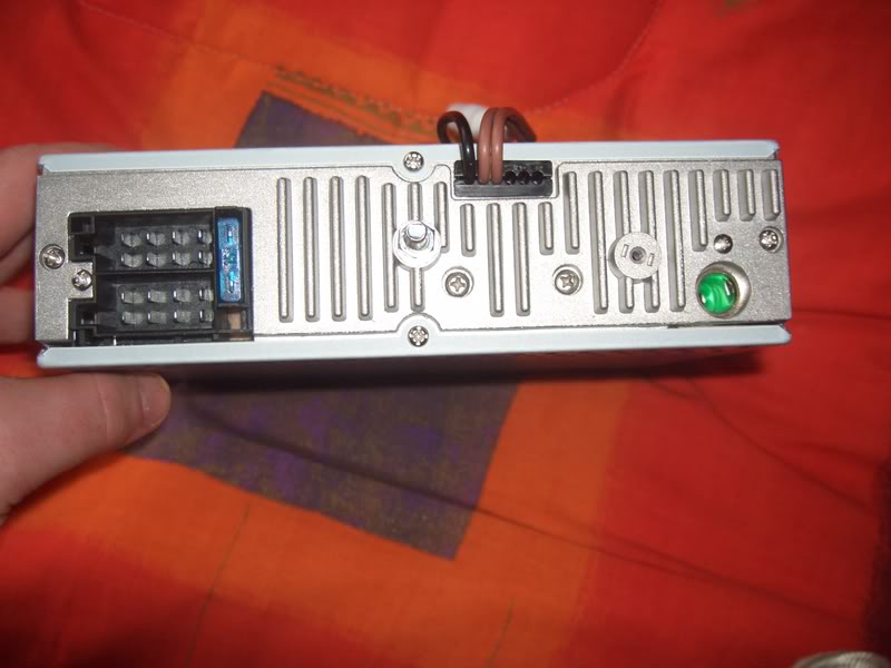

Ok, so made my own keys out of an old wire coat hanger, got the unit out no problem and now ive run into a bit of a problem.:dapprove:
Is there anyway i can get the standard ariel to fit the socket of this headunit?
think halfords sell adaptors, never use the radio inmine tho so didnt bother another credit crunch moment lol
Not my car keyed?! :eek:
Cant find which ariel adaptor I need. Any ideas? theres 3 pages worth on halfords website!
