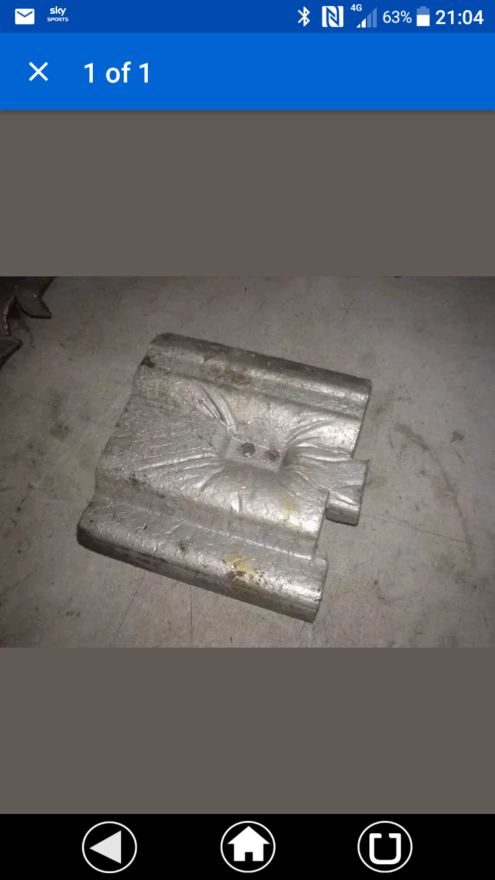

Daft question but is it missing the cover/heatshield ?
I've seen it mentioned previously that they're heat sensitive, and to be fair since I lost the one off mine the starter has gotten more and more problematic when starting

Im not sure buddy, ive had a turbo conversion done so im guessing it might have been removed, where is the starter located and where should the heat shield be mate?

Starter is tucked up under the exhaust manifold bud, well at least it is in a standard setup :wink: looks like this and clips onto the starter motor

Im not sure where mine will be then lol, probably under the garrett, i have zero chance of being able to see under there tbh, i bet its heat related mate as it was in the 20's here yesterday.

As you say, turbo might be in the way of this, but the starter/heatshield is on the back of the block underneath the manifold. If you look back there you should see that heat shield round the back of the block under the manifold.
