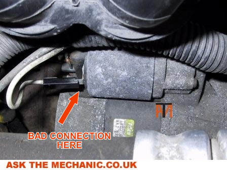

Starter motor solenoid sticking, get your wheel brace and give it a whack, should free it. Time for a new starter motor.
BPY
  16v 1.2
Spade connector to starter motor. Clean connection.
  182 Trophy
What BPY said - that seems to be the most common issue.
It can be hard to reach - I used to find a few wiggles of the corrugated trunking that runs down the back of the block was sufficient to get it started.
Eventually, I ended up replacing the connector when changing the starter.
