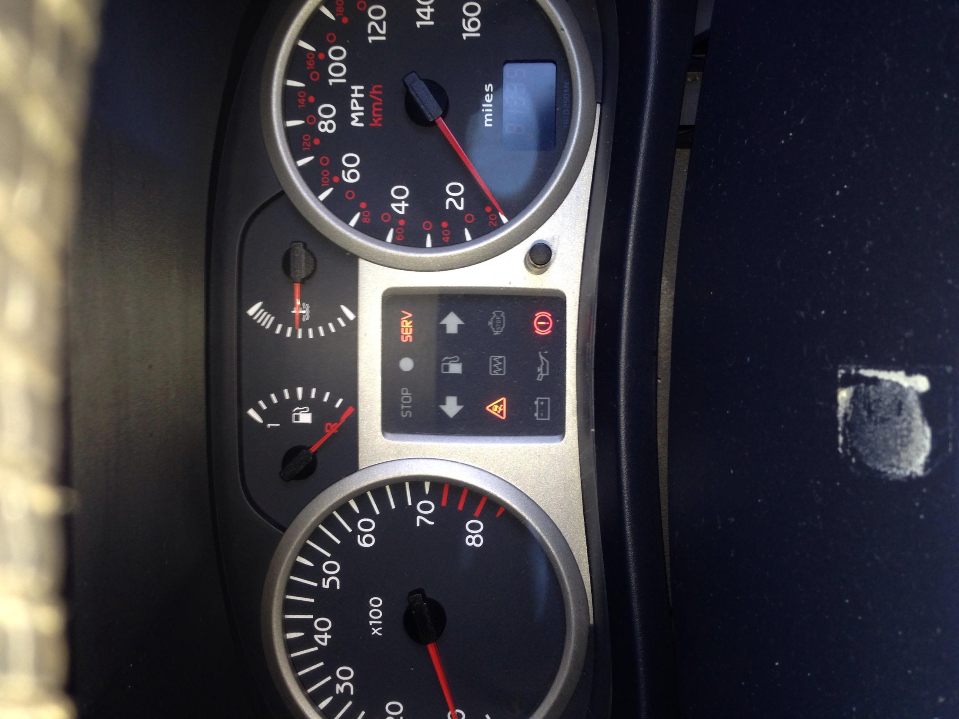

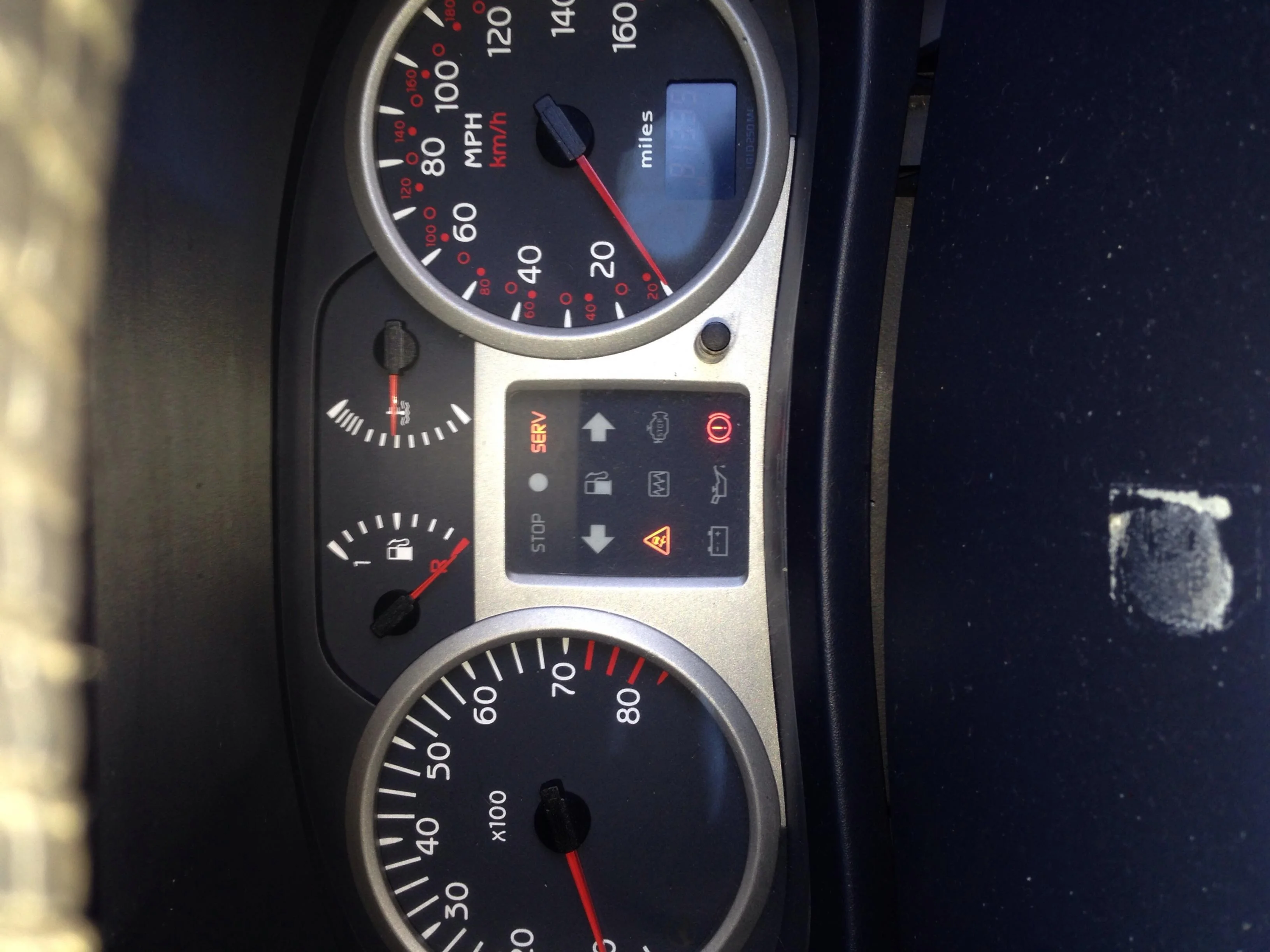

Hi, problem started yesterday when I was at b&q, put the key in and all I got was a random clicking noise, anyhow after keeping the key turned for some time it fired to life but left these two lights on (see pic)
parked end up at home and tried it a few times randomly and it started first time. Got up this morning and it happend again, only took 10 seconds to start.
i will get a video when it next happens, anyone any ideas?

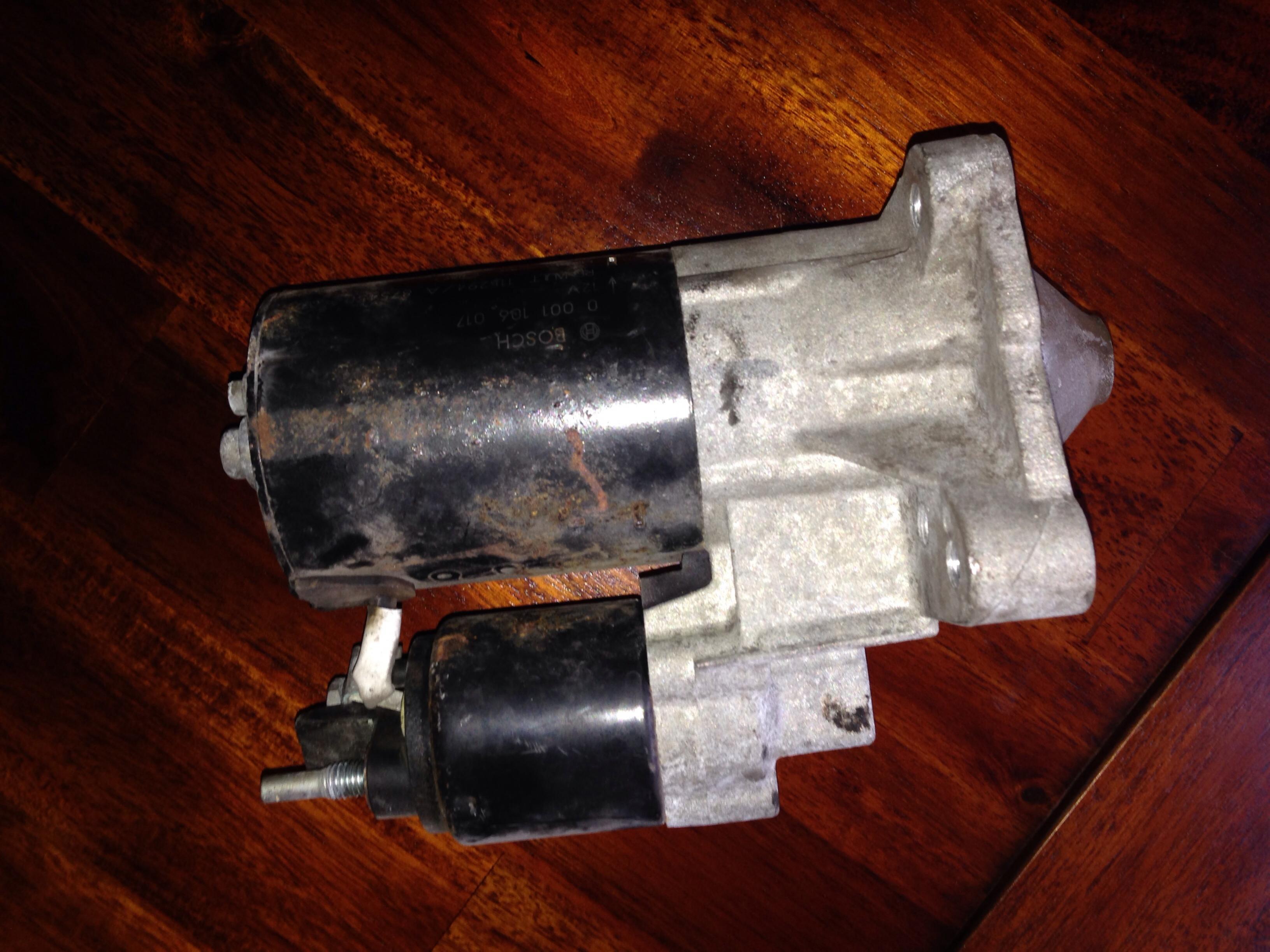

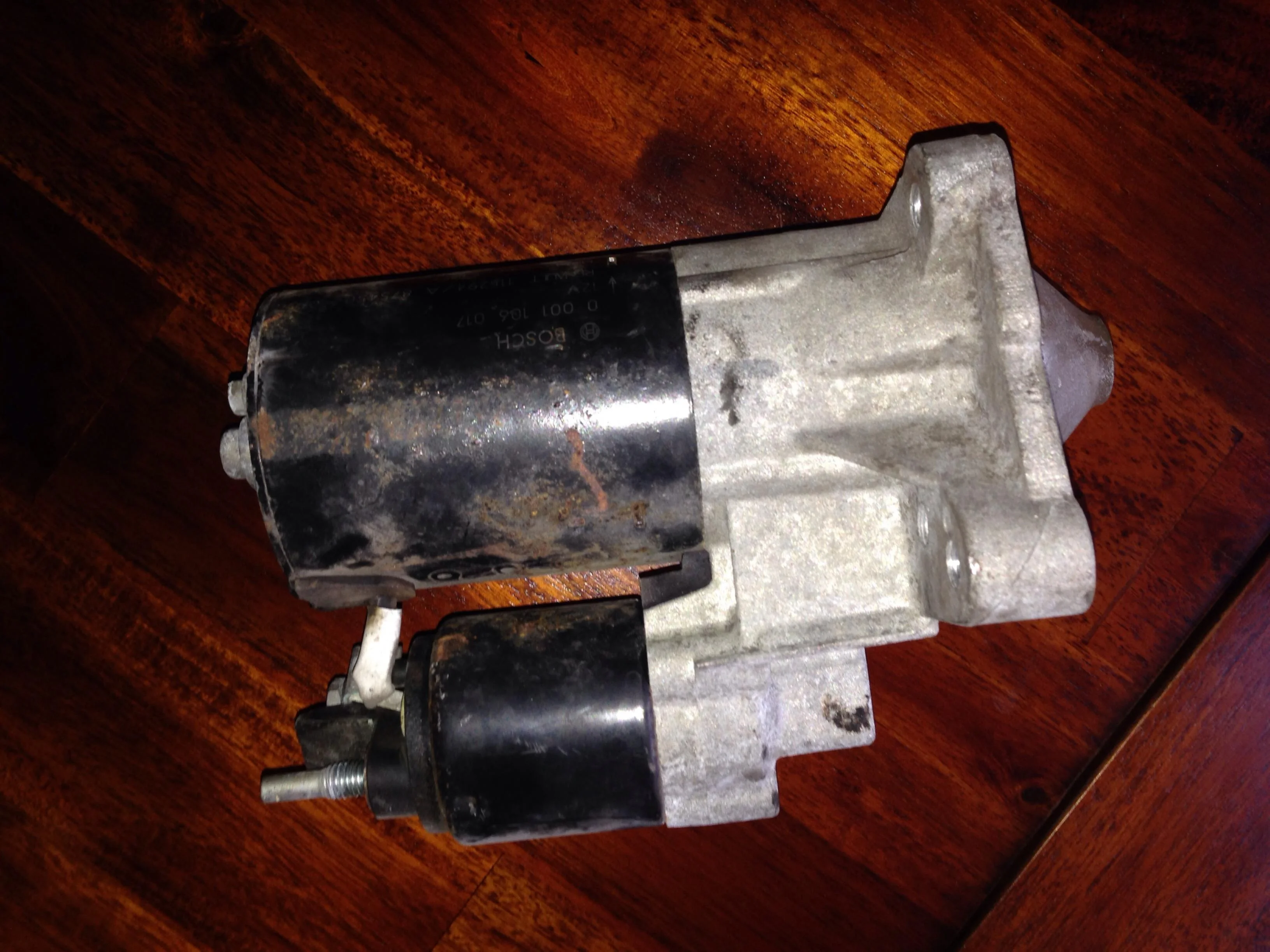

Started after a couple of mins this morning, same old clicking, ran over to the garage and they seem to think its the starter motor too but are busy till next Tuesday, so out come the halfords pro tool kit and 3 hours later BOOM

Quick update, starter motor came today so I poped it in and bolted everything back up, exactly the same :mad: Should have probably done this first but i went and bought a new battery, its currently on charge we will see how that fairs.
Slowly running out of ideas, any help would be appreciated,
