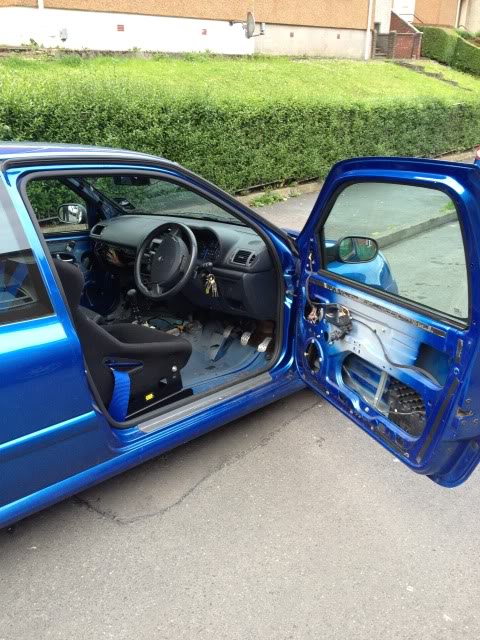

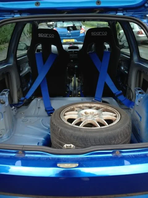

I got the old angle grinder out and took out boot skins, door skins etc
rear wiper motor etc
im now driving the same model car standard but with the exact same wheels and sus that was on the first.
it made such a huge difference I want the old one back!

1) By removing half the things that you're not willing to (EVERY interior panel, carpet, piece of trim etc) because you want it to look standard,
2) Then by replacing as much of what is left with track-spec items which are usually lighter by design (lightweight bucket seat, lightened & flocked dash, lighter stainless exhaust, lighter wheels, foam filter instead of relatively heavy airbox & acoustic valve. The list goes as as you start to modify the chassis, swaged holes & removing brackets/fixtures etc)
