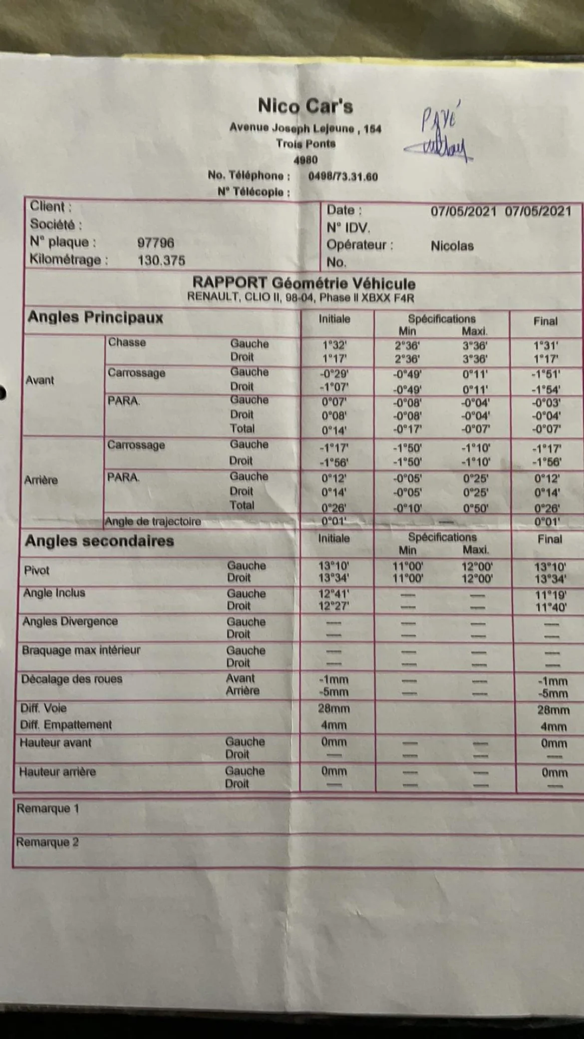

Geometrie already did one, im not really happy with the result need to do it again but i think this isn’t just a geometrie problem.

Where do you have the assistance set? I cant really help as I only used epas with an aggressive suspension setup which naturally had lots of self centering.
