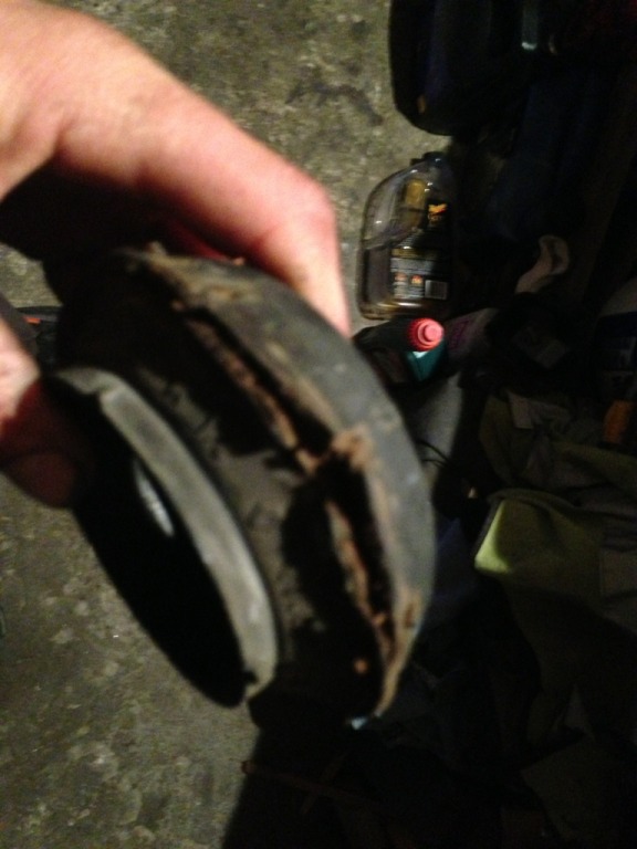

Right, after inspecting the rack bushes it appears they're fairly new, certainly not the originals from the factory anyway. Removed my coilovers and I found this
Assuming the knackered topmount was my problem I replaced that but to no avail as I've still got this annoying creak.
