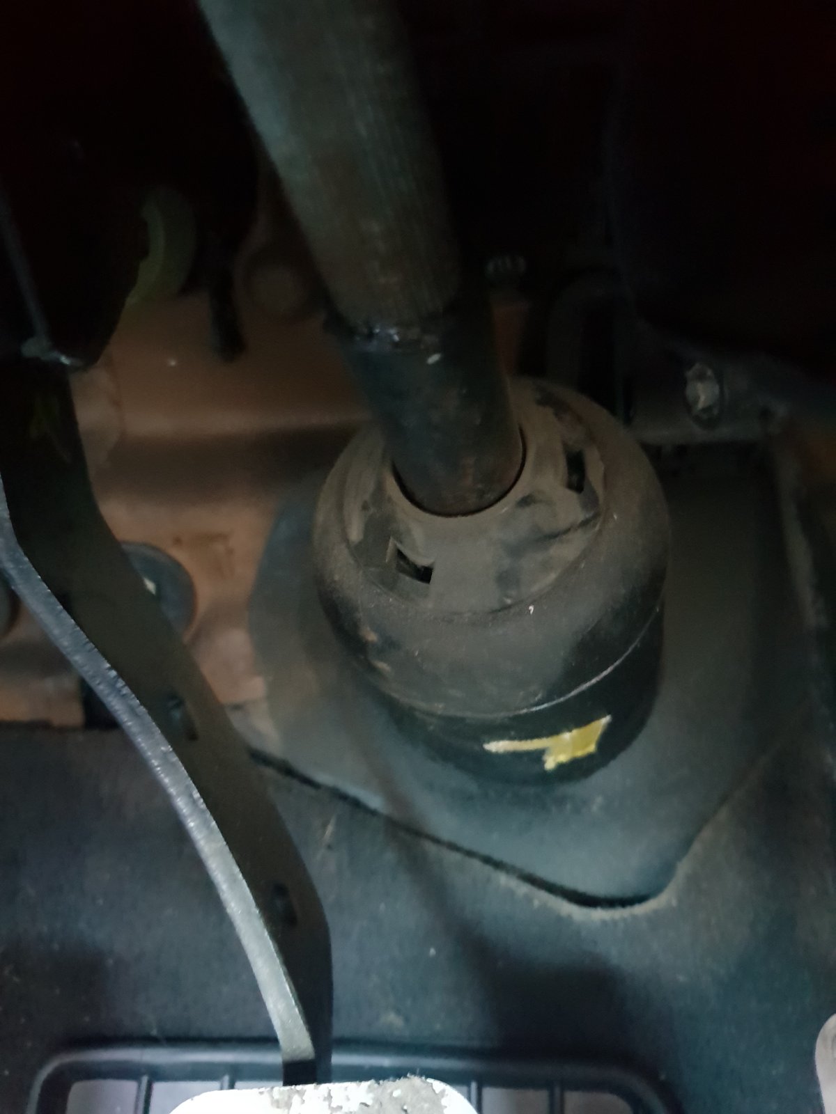

I look over the column till enters the boot inside the car. Looks perfect, not play at all. How can that boot be removed?(picture)
If i move the steering wheel fast left right I can heat a knock like a worn steering rod.
The only problem as mentioned above is the inconsistancy.

The universal joint from rack to collum is behind a big rubber bung through the drivers side wheel arch, it's held together by a pinch bolt.

Yep outside the car.
Remove driver's arch liner and youl see it.
Pain in the arse to reach, I had the subframe down and it was still awkward, probz easy on a ramp though but I was on the drive
