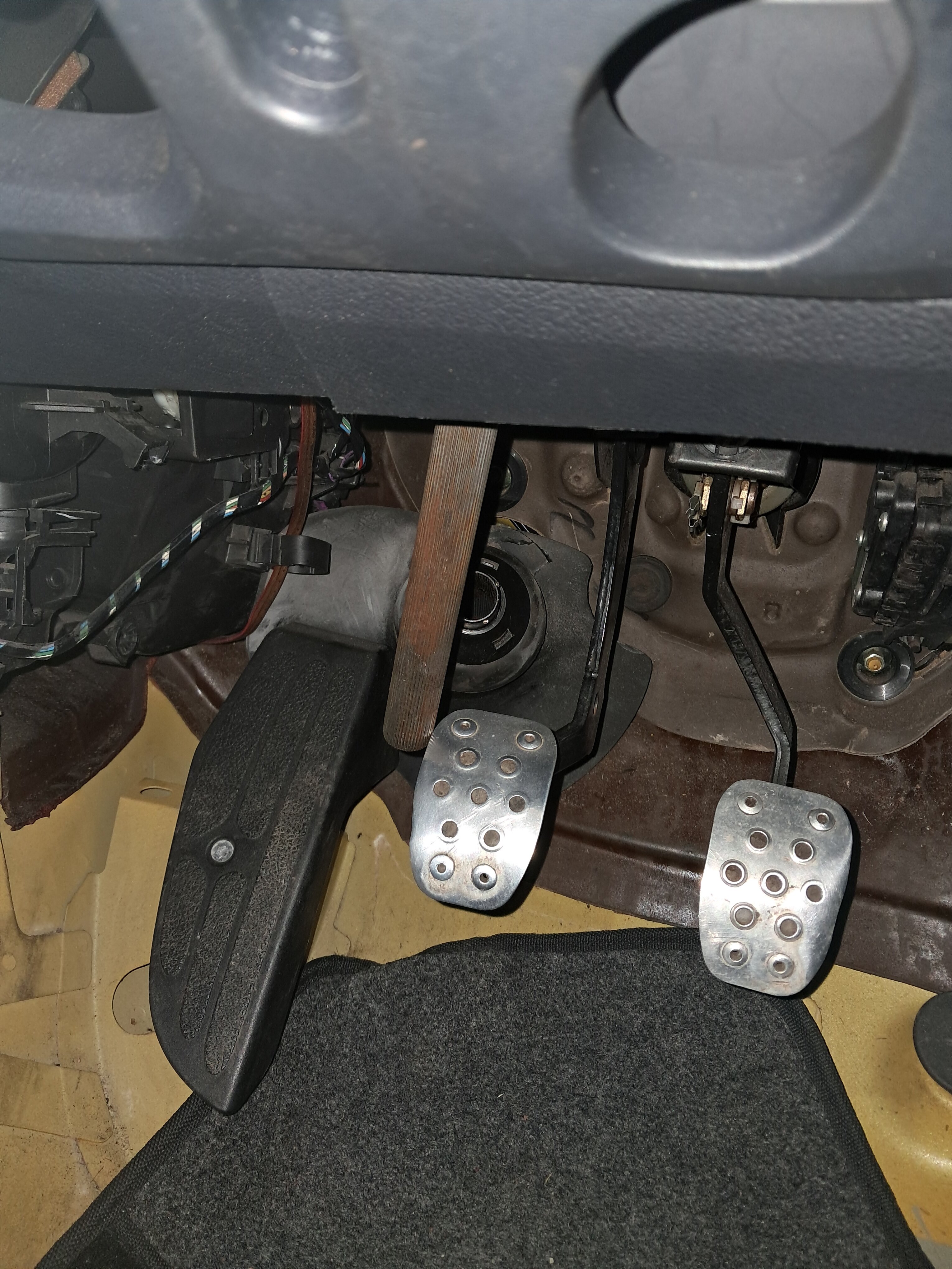

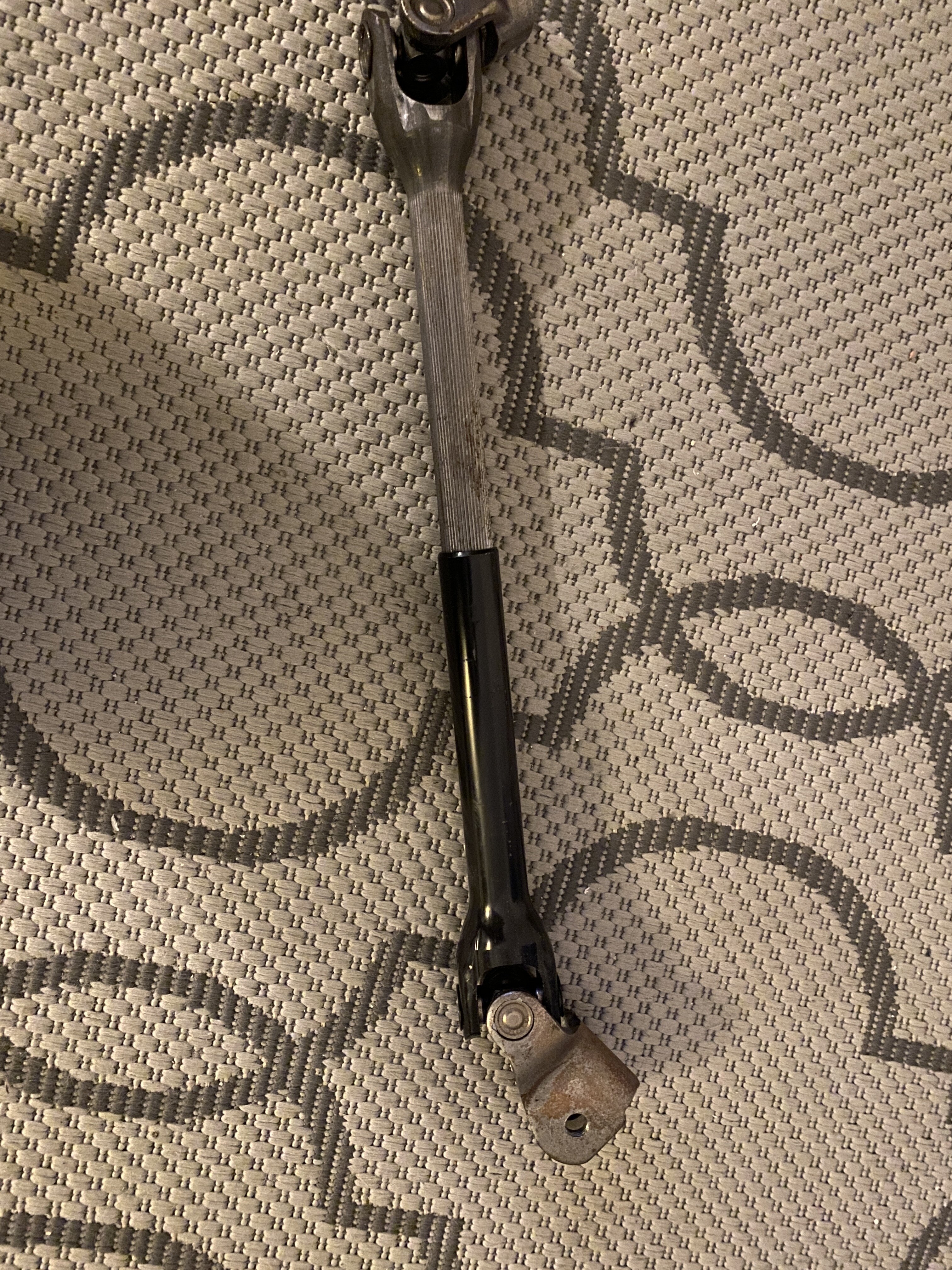

In the latest twist in my gearbox swap saga, the steering shaft has become disconnected in the footwell, presumably from lowering the rack still bolted onto the subframe with the pinch bolt undone.
What's the easiest way to sort this please? Can I remove the steering wheel and pull the shaft back up to re-insert it somehow?
The problem isn’t putting it back together it’s aligning it. Heat up the sleeve then carefully tap together, you will see where they originally were due to the rust, but then put back on car and check, out ok repeat that again and hope it’s right..
