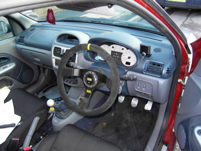

Replaced the steering wheel with an aftermarket one, does anyone know the torque settings for the bolt?

Thank you!Its 45Nm, Renault recommend its changed each time its took off.
