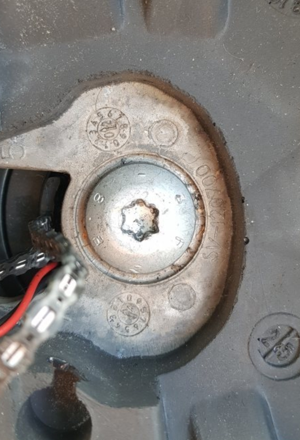

  Clio 172
There's a big torx head screw under the airbag. I suspect that's loose.
It looks like this.

Bankrupt_drunk
  Clio 172
Disconnect the battery, then press in the brake pedal for 20 seconds to make sure it's fully drained.
This guide shows how to remove the airbag.
Bankrupt_drunk
  Clio 172
And obviously, make sure you've got a big torx head socket before you start (I think it's a T50). If it's not the screw then it may be the column bearing.
