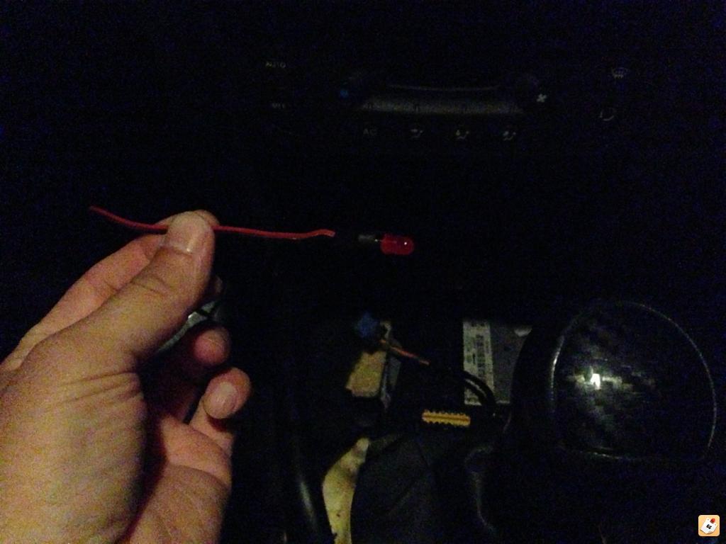

I have left my car parked up For about a week. After fitting new stereo.

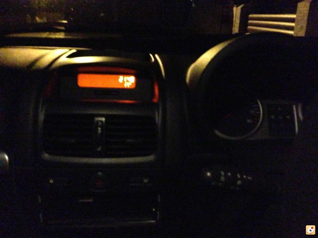

Looked In the car tonight & the stereo was lit up & so is the clock. & the little led in by the gear knob wasn't flashing or lighting up like usual so I tryed starting the car it turned over i pushed the throttle to help it start and 1 ohh mighty bang out the exhaust & wouldnt start Checked all the fuses can't get it to start.
The stereo problem was lighting up with the old 1 to buy I used to have to turn it right off or Remove the face to stop it drawing power
Can any 1 help me pls been told it could be my tdc by a friend.
Many thanks mosley. Pls help lol
  CLIO 182 CUP
  Phase 2 172
is the cd player wired up correctly, looks like the permanent feed for cd player memory is powering the clock unit up, i'd re-check the wiring
  Phase 2 172
have you tried switching the permanent live and switched live at the back of the cd player see if that turns it off?
  CLIO 182 CUP
I've swaped the red & yellow around sorted the clock & led flashes again. Jump started it & now it's good as new.
