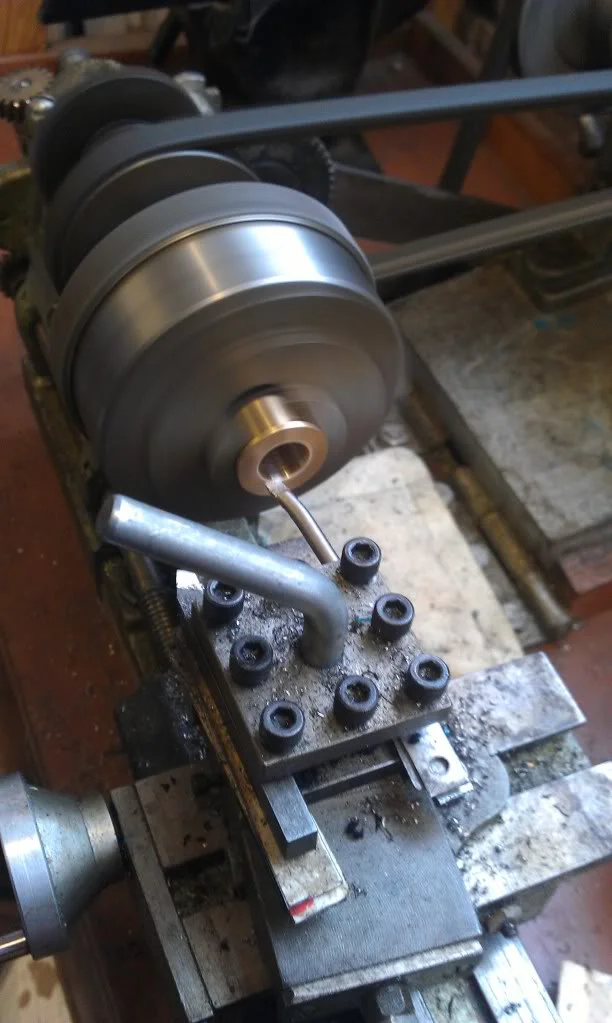

The ones we fitted resulted in us doing this.

What symptoms did you have pre-machining?
Matt Cup
  Leon Cupra
Not 100% sure on installation, but from what I gathered the bushes wouldn't fit without force, before we stuck them in the lathe.
We were concerned that if we had fitted them on without working on them we wouldn't be able to get them off. It was trial an error but it fits snuggly now and hasn't caused any problems since as far as I'm aware.
