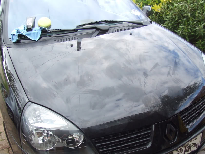

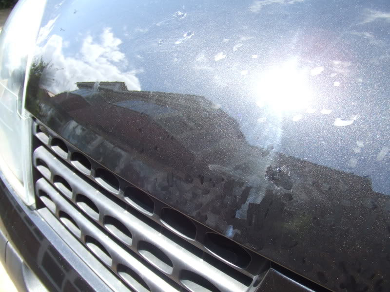

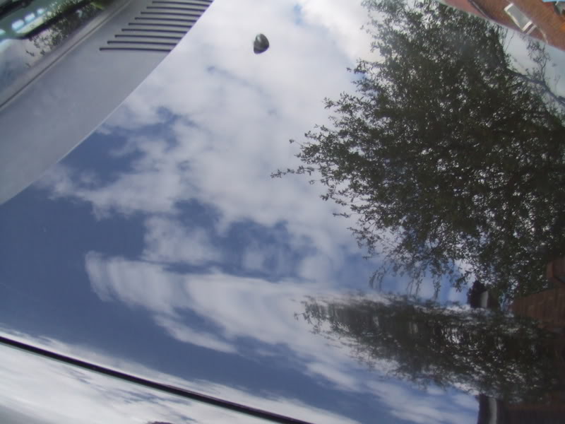

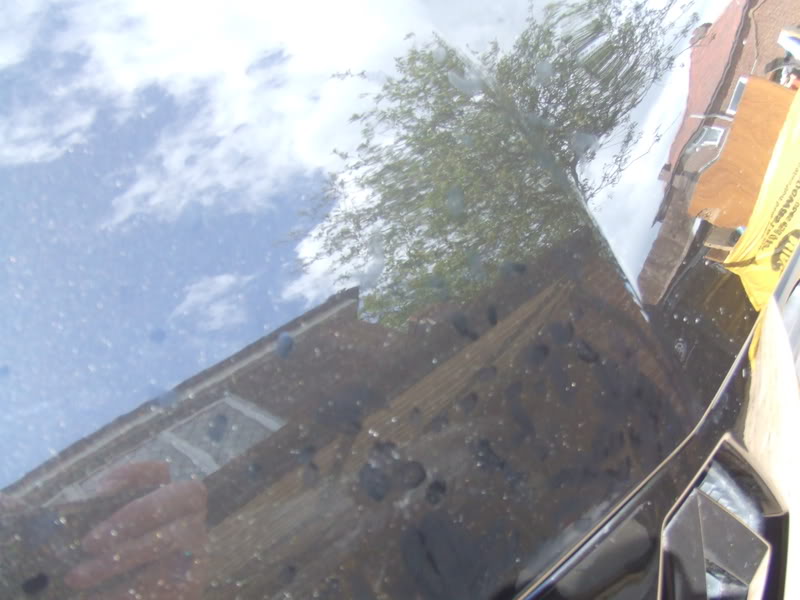

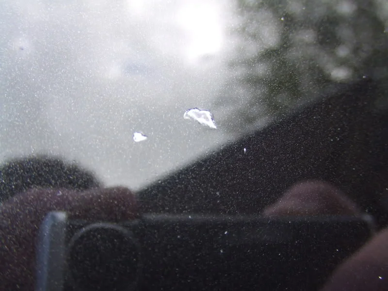

My bonnet is littered with stone chips, The previous owner was a motorway driver i think.
So i set about trying to repair some of the chips
This is more of an experiment than anything else. Im no expert by any means, But like the Detailing side of cleaning cars.
Being only young i dont have money to spend on the most expensive items, But ive got a small arsenal of Autoglym products... I plan to fill just some of the bigger chips to start off with and see how it turns out.

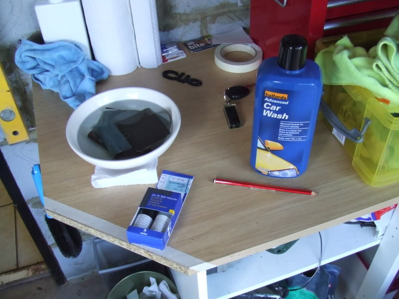

List of products used:
Halfords car wash, Industial alcohol, ear buds for cleaning, Sanding pen, 3000 and 1500 sand paper soaked in soapy water over night., Scratch x, Super Resin Polish and Poorboys blue paste wax.
Work Area

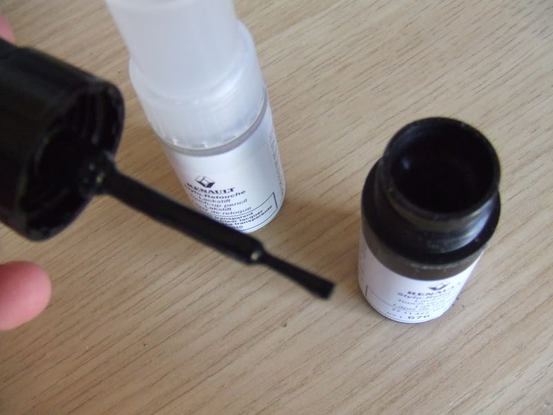

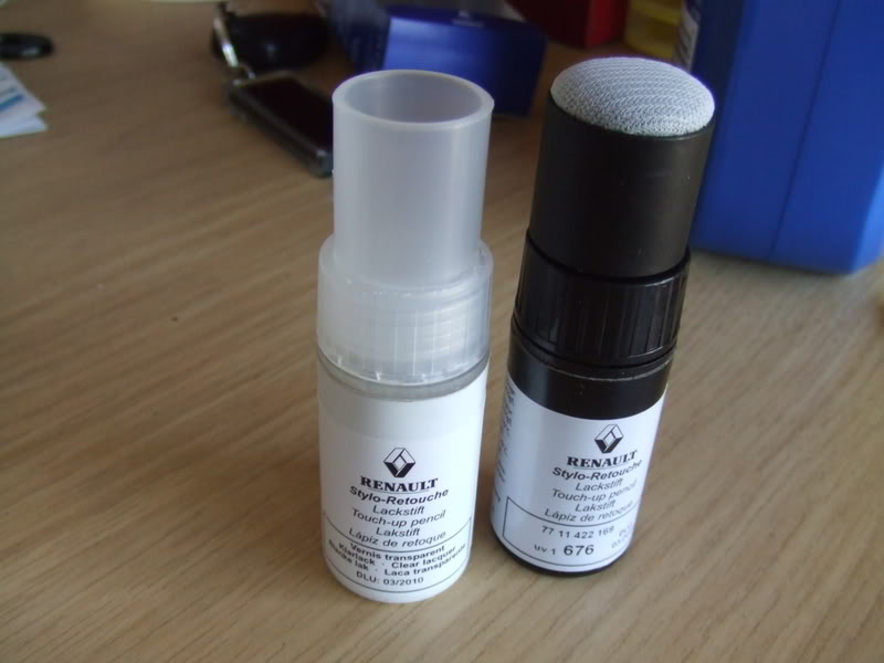

the pack came with paint and laquer.

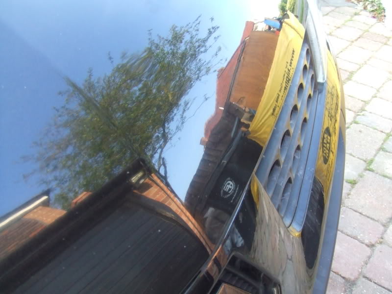

I parked my car in the shade to cool the bonnet down.
Washed with cold water twice (no contact), Just spraying water.
Then washed the bonnet and front wings twice with Halfords car wash. And dried.

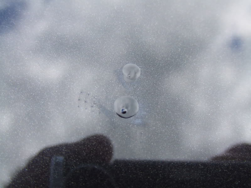

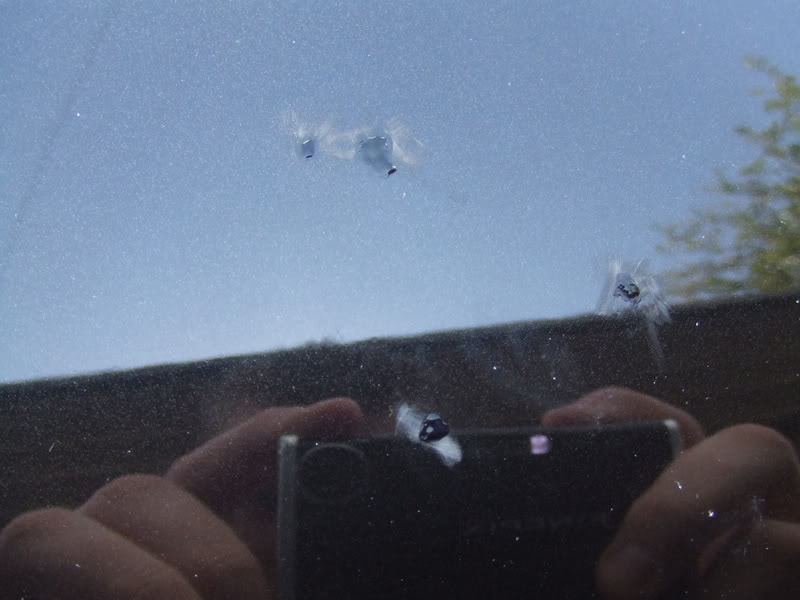

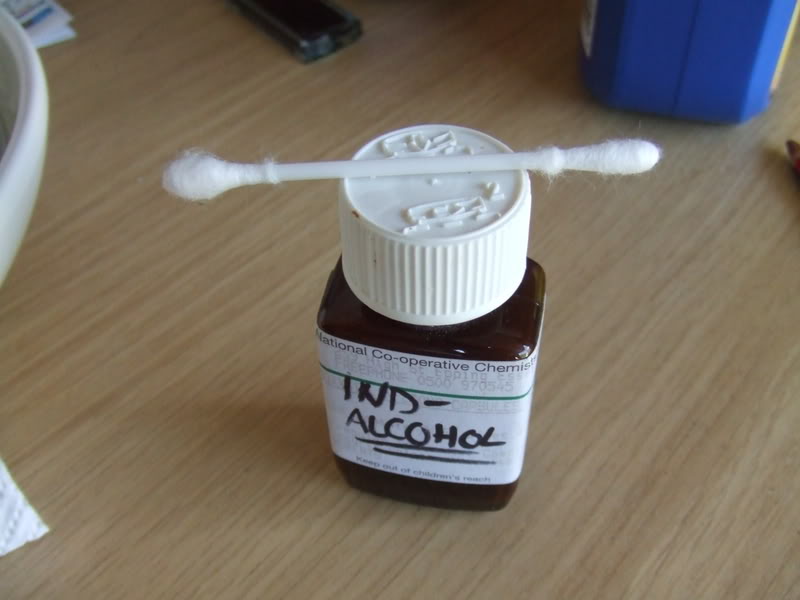

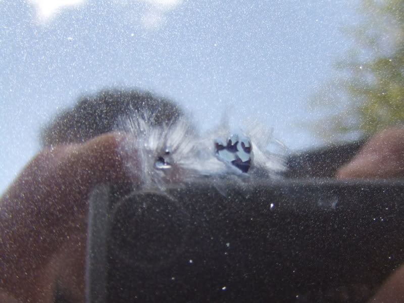

I cleaned the stone chips out with Industrial Alcohol. (think it may be the same as Isopropyl)

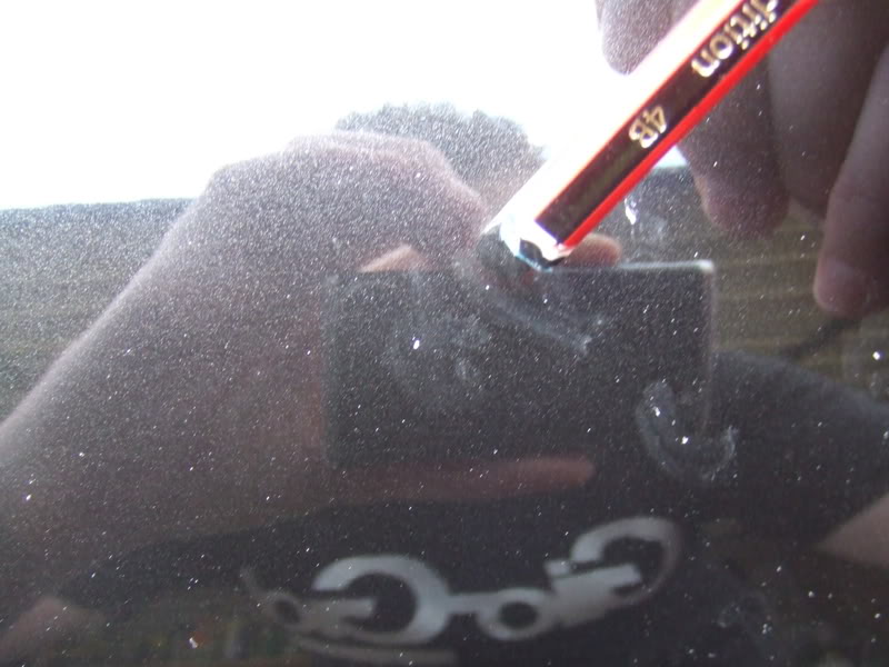

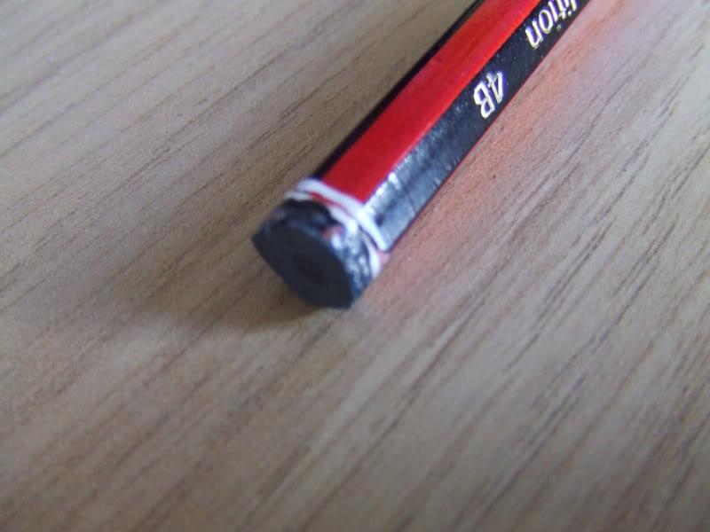

Then using a home made sanding pencil. Made by glueing a cirlce of 1500 wet n dry paper to the back of a pencil.

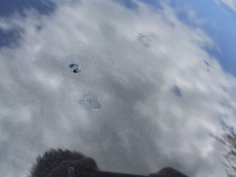

Sanded edges of chips.

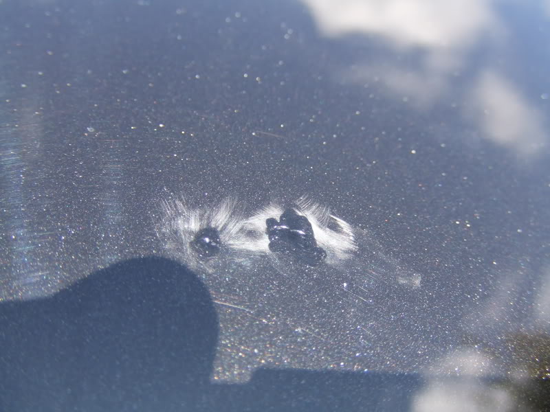

Shook the paint up and applied first time with a c0cktail stick. Then used the standard brush after to create a dome of paint.
Paint seemed to be sinking as it dried so i applied more.

Paint pen had some type of mop on top, Instructions told me to wet this after 10 mins and go over the fresh paint.
Then apply a layer of laquer. (I only did this for the first few, after that i didnt bother as i dont think its needed.
The next day i attacked the rest of the paint.
Some paint that i bobbled instead of applying thin layers came straight off.. (lesson learnt)
I retouched the paint chips that didnt work using thin layers with drying time in between, then a final 24 hours of drying before sanding.

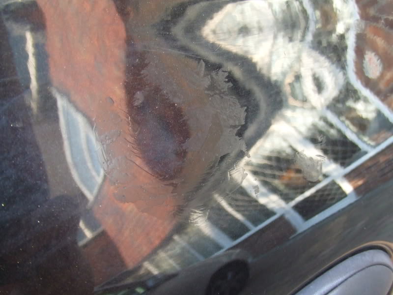

Drivers door where some little b*****d threw an egg and chipped the paint: (will get finished picks up when i sand down)

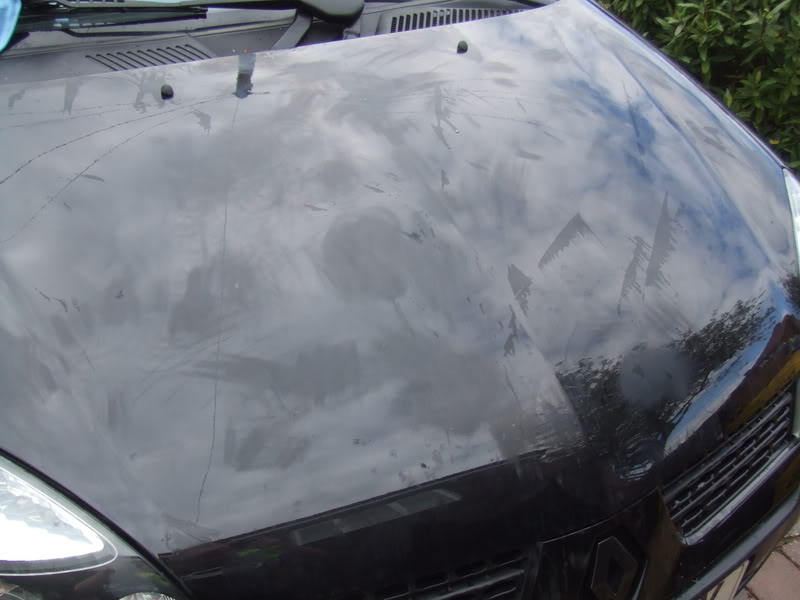

Wetsanding:
Wetsanding didnt take as long as i thought it would. Still a good hour or two, but it flew by.
I just was very carefull to keep the paper flat, and also use plenty of soapy water out of the spray bottle as lube.

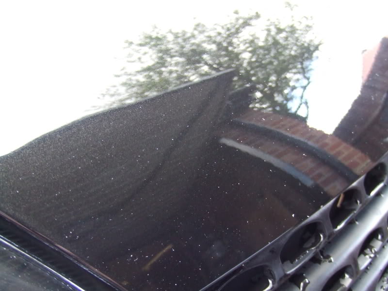

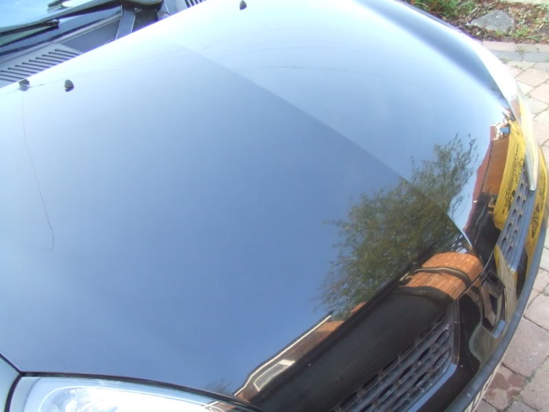

After sanding and polishing using: Scratch X >>> SRP >>> Poorboys blue paste wax
Afters: (was getting dark so they dont look too shiney)
Overall im happy with the result, there are still a few chips where the paint didnt stick so sanded straight off. These have been re touched and will be sanded soon.
I will get Some more final pics when i next clean the car and sand the drivers door out.
