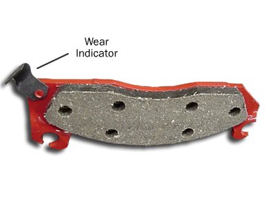

Theres a weird squeaking noise coming from the driver side front corner too so maybe thats the pads wearing through?
^they don't have wear indicators, the low brake pad warning is caused by low fluid, because all the brake fluid is in the calipers rather than in the resivoir
new pads and check level AFTER
Nah i meant the bit of metal that can touch the disk and make the noise hes talking about
