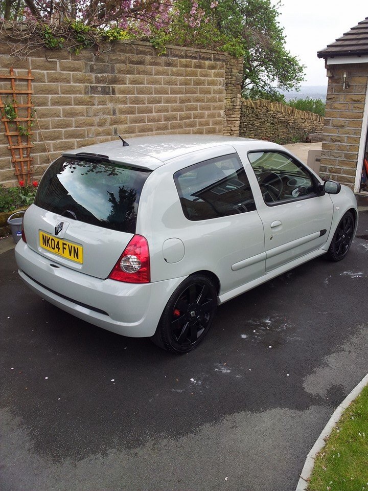

Thought I'd start a little project thread, and update it as I go along
So, I bought this 172 off a forum member who'd only had it for 4 weeks or so. Basically it's got a few issues, but nothing major! The main part is the paint is immaculate!
Its had a full spray in Storm Grey, and the workmanship is excellent. All door shuts etc are done, it's just under the bonnet and the boot floor which are still Monaco Blue. It's also sporting some Cooksport springs, which is a bonus

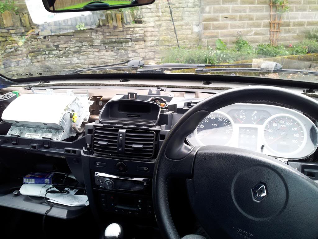

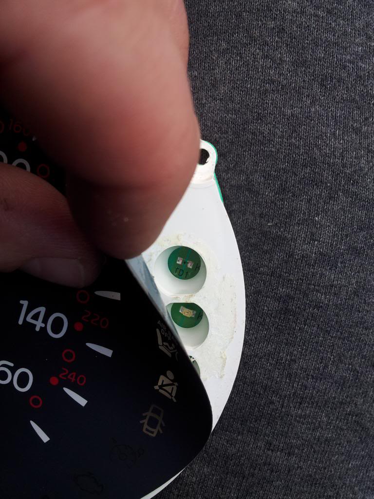

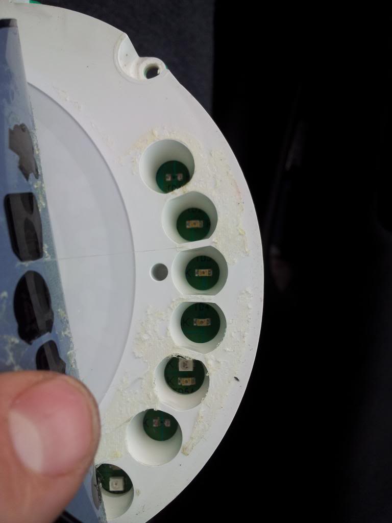

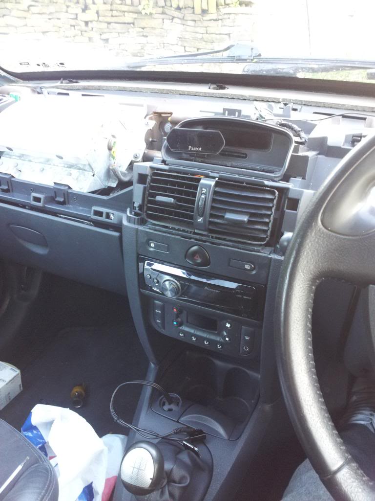

So yesterday I decided that I'd have a look why the EML, airbag light and 'SERVICE' lights didn't work. Also, my clock bulbs didn't work and wanted to fit my hands free. The clock bulbs had blown in my old Sunflower too - weird
I stripped the top dash off
This is what I found on the speedo
Obv the previous owner decided they didn't want those LEDs anymore! I decided to run a scan on it, and the EML isn't even on, I can only presume it had a decat maybe that put the EML on at some point? I've also noticed today that when you don't wear a seatbelt, the seatbelt light doesn't flash, and when you turn off the pass airbag, the 'airbag off' light doesn't work. Not really pleased tbh as had my nephew in there the other week, and I guess the airbag wasn't turned off after all?! I'm going to borrow my mates scanner to read the airbag codes
In the meantime, I've ordered some new orange SMDs to solder back into the speedo to get the lights working!

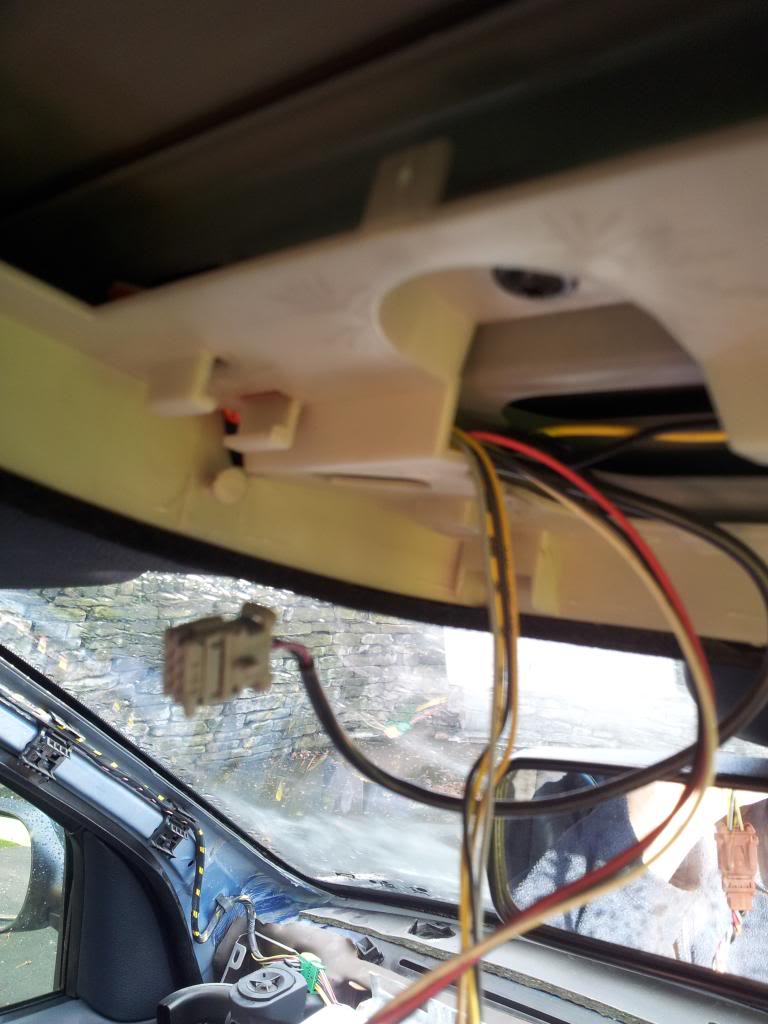

Whilst fitting my microphone, I removed the interior light unit, and found this wire - does anybody know where it's from?
As my cig light didn't work, used the hole for this
And the Parrot is wired

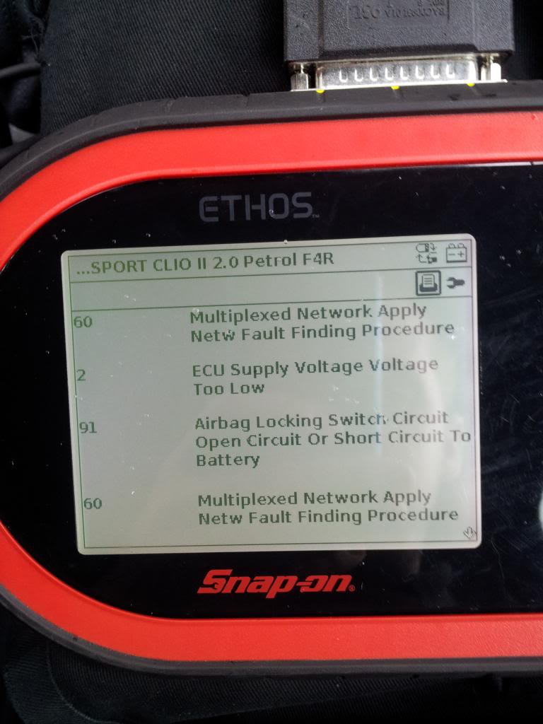

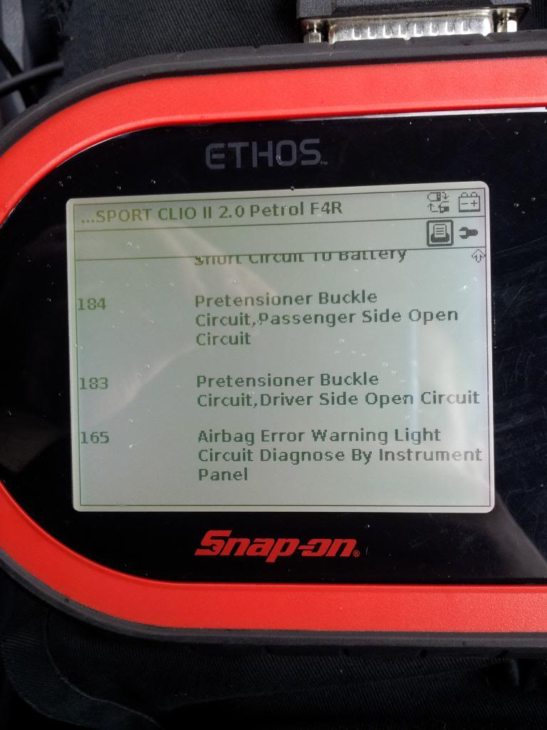

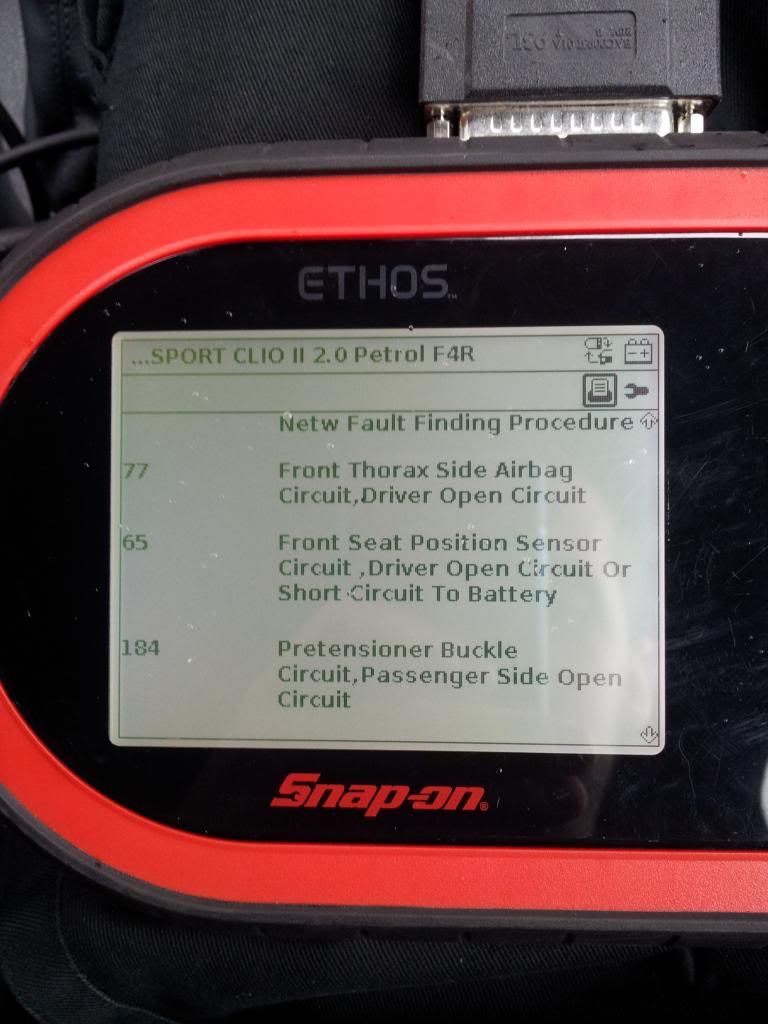

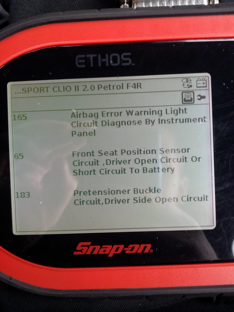

Today I ran a scan on the airbag system, just to see what was going on
It came up with this, or should I say these!
All of them seemed to be open circuit faults, so I cleared them and this is what came back
Am I right in thinking 'front seat position sensor' is also to do with the pretensioner, in which case I'm going to check the wiring under the drivers seat to see what surprises are under there! Obv the warning light error is due to the missing LED
  Many.
Yep that is the case.
Not sure on the temp sensor, although it could be due to it being open circuit entirely. Pop the mirror off.

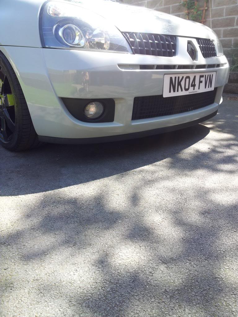

Today I've been to 'Cars In The Park', and I'd had my Fabia splitter for a week or so, so thought may aswel fit it
Before
For some reason, I remember someone saying they needed trimming down. Instead of measuring up, I just cut a chunk off! Amazingly, this made it exactly the correct size!
Looks loads better imo

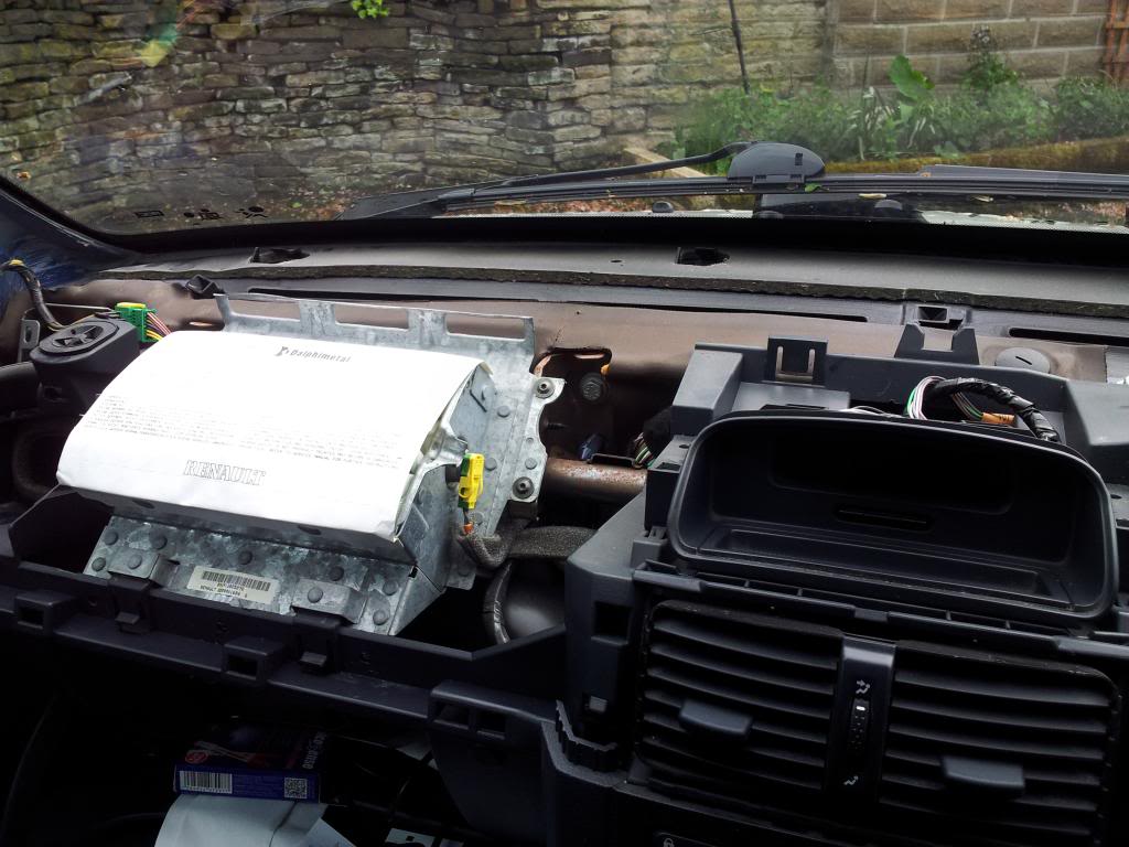

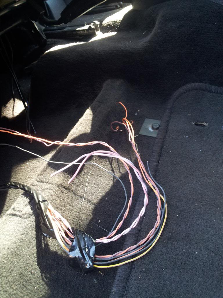

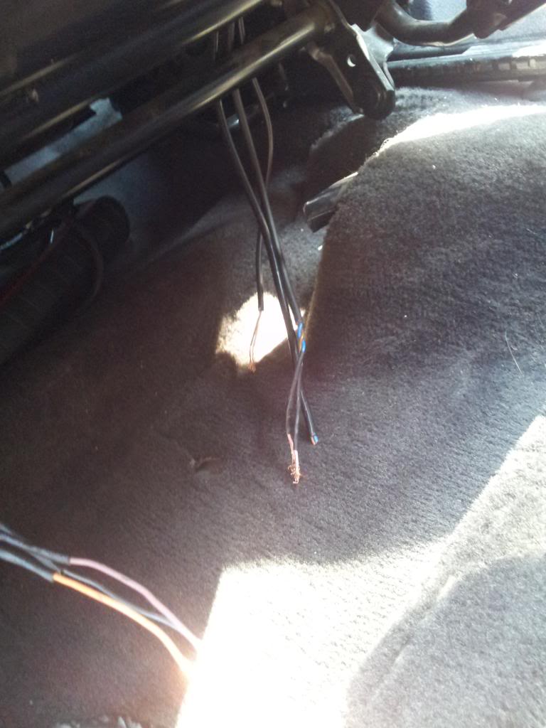

Now that the bulbs work, I thought I'd see what was going on under the seat
All the wires were taped up, with the plugs cut out, as most people do, so was expecting just a disconnected wire. I was right, to a certain extent...
The pretensioner/seat posistion sensor isn't connected to anything!
Problem is, I've around 9 wires coming off the car loom, and only 4 on the pretensioner/seat sensor. I've searched the net for a pic of what wires goto which colours, but have been unsuccessful. There's a 'how to' on adding a resistor, but I just want to reconnect them as if the plugs have just been cut out - can anyone help with this, either a link to a good pic, or looking at their own car?
Wires on the car
Thats it for now

Unfortunately the situation is that these cars are up to 14 years old now, and during those years they've likely seen quite a few owners who do some pretty crazy and unsafe modifications. Hope that's the end of your issues :)

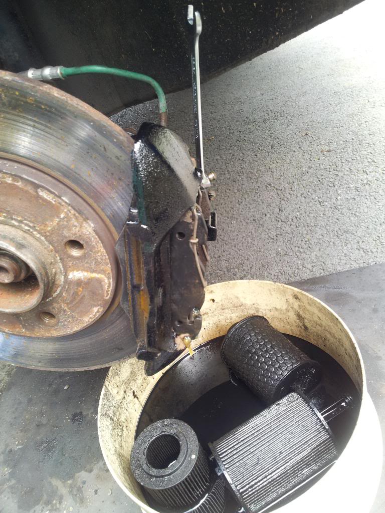

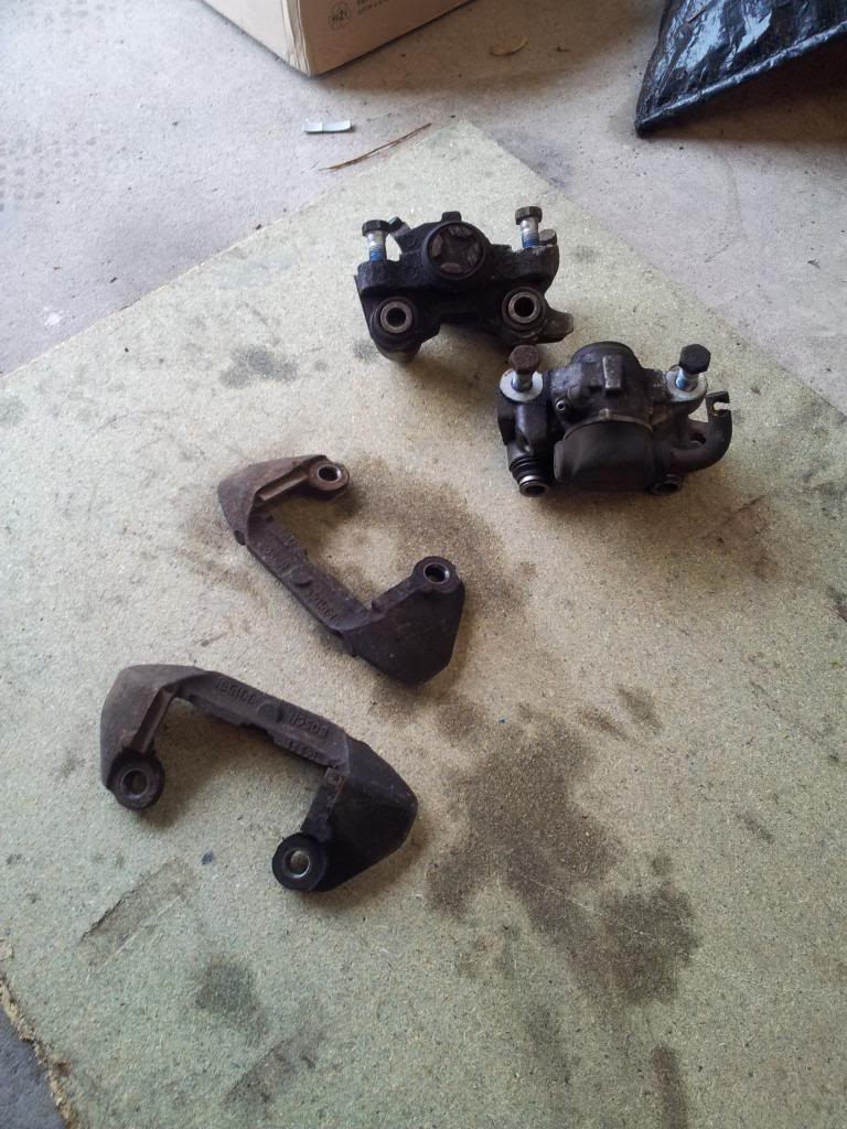

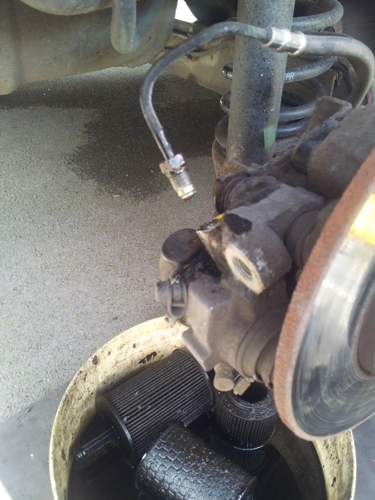

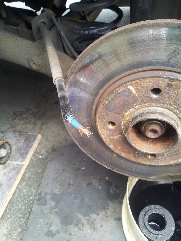

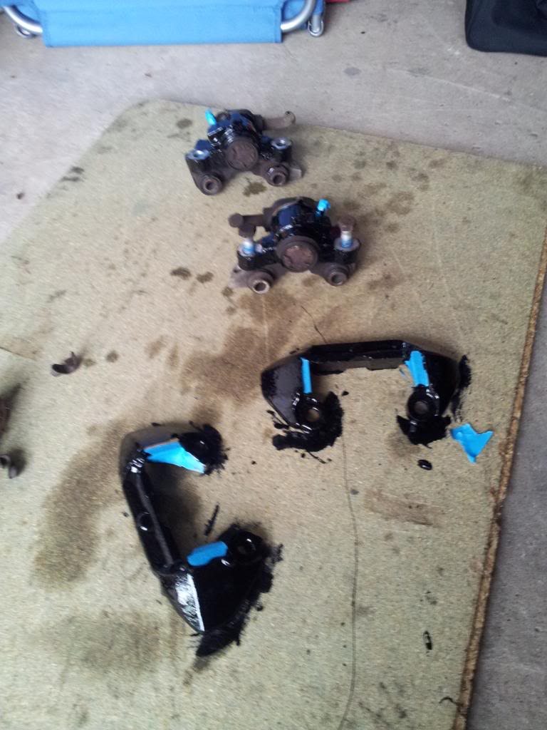

Finally got round to changing the rear callipers today - I'd bought some 3 weeks ago, and the seller was slow at sending them, and after the promised delivery date passed, I just ordered some more as I was really desperate. Turns out a temp at work had signed for the originals, and not told me. Turns out the second pair, that were promised for Sat, still haven't turned up yet so I've fitted the 1st set, and I'll sell the second set on!
First I made sure they were unseized, and gave them a lick of paint - I'm not keen on the bright red, I prefer an understated black
Then set about fitting them, which I thought was going to be harder with the old brake pipes now 10yrs old
Built up. The pass side was abit touch and go, the brake pipe wanted to twist, but a lot of WD sorted that

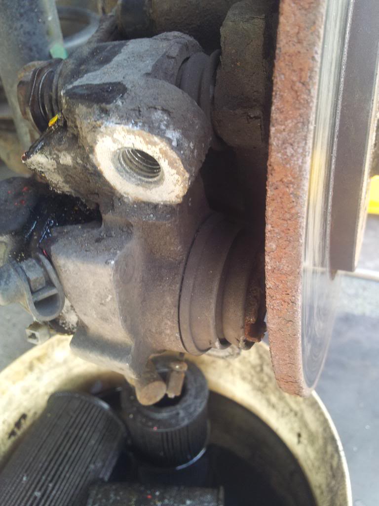

And, there seems to be a casualty in every job I do
The drivers side cable appears to be new, so slid out nice and easily, however the passenger had seen better days, and was absolutely seized solid into the hole, so just cut it and I'll fit a new one
Now, after this the car is a different machine! The brakes were literally seized on, so it was just like driving with the handbrake on! Now, it's defiantly faster, and so much easier to drive, and that was only after a whiz round the block!

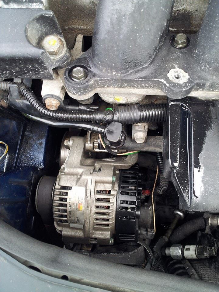

Or at least I did! For the past few weeks, it's been slowly dying. Faults I can remember are Missfire under load, knocking when setting off, and when slowing, the passenger mirror glass has gone floppy, the clutch release bearing is noisey and something abit more worrying...
Last week, on a hot day, I parked her up. Upon trying to restart, it wouldn't, just turning off. I popped the bonnet to find this
The fuel pipe had unclipped, and it was pissing fuel everywhere. I was baffled, then thought about the fuel return pipe being blocked off? Or is it a breather? Anyhu, I presume when hot the tank swells building the pressure, and blew the pipe off. It happened again this morning, so it's something I need to look into. I don't think I can refit the charcoal cannister or whatever it is that's been removed, but I'm sure I've read somewhere about a one way breather?

More likely to be the clip on that fuel pump. Couple of mates have had issues with it popping off, on completely standard cars. Solved with a cable tie.
