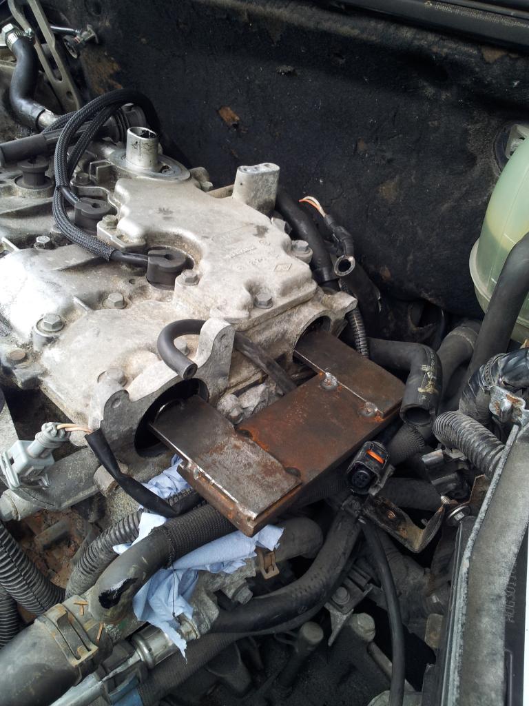

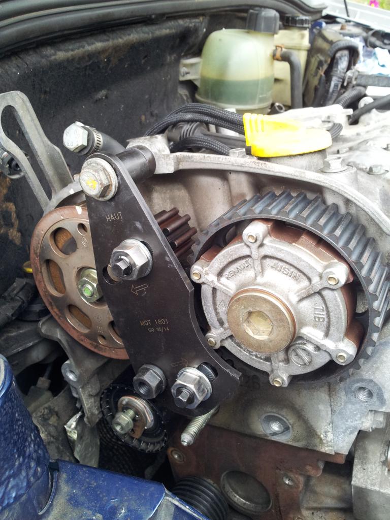

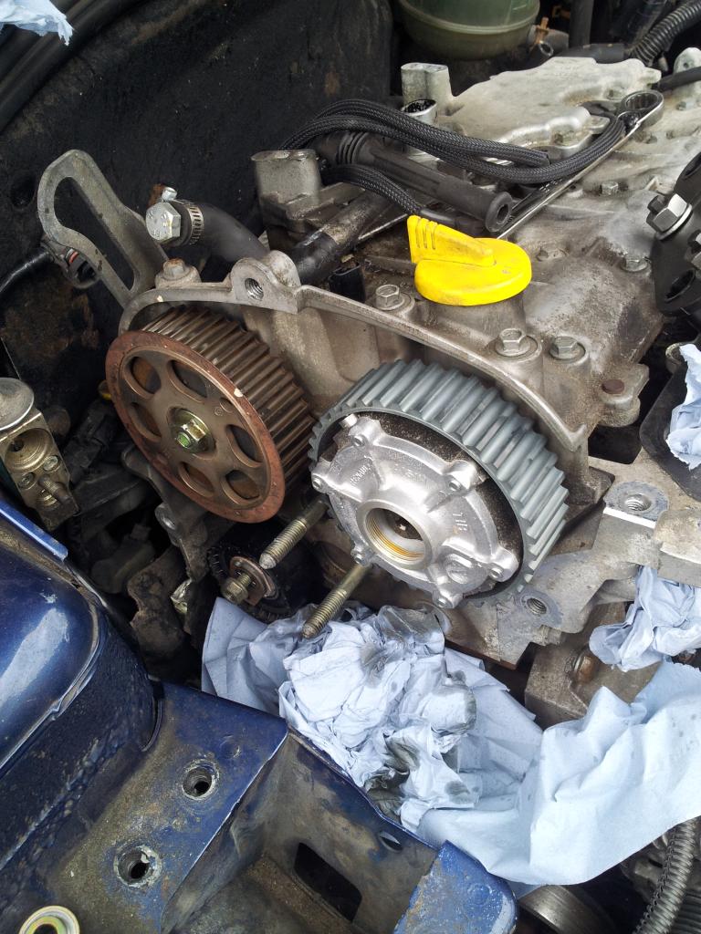

Last weekend was my Mrs' hen do, so I had plans to do everything at once, so there'd be no moaning, however I hit an obstacle whilst doing the cambelt - on my Sunflower, I'd just used the cam tool to hold the cams whilst I undid the pulleys, as my mate had one made out of strong steel, however the pulleys were that tight it bent the tool - it was a week later when I finally got the pulley locking tool to complete the job! The timing was out when I originally lined it up, and there was lots of play in the dephaser
New dephaser
I followed all the guides, leaving the pulleys lose and turning the engine over backwards, then torqued everything up. First turn of the key, and she fired into life, so I went for a spin. Now I've had 4 172s, and after doing the belt on this one, the 5k kick is more pronounced than I've felt on any of them!

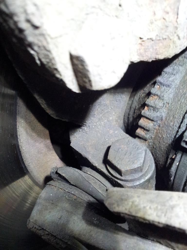

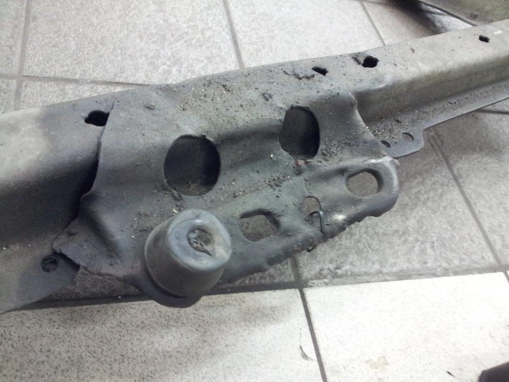

This morning was the next stage in the rebuild. I had the new subframe built up with the ball joints etc, so set about swapping the frames over. The frames bent where it's been in a slight bump, and this frames been off before as the front two bolts were quite new. However, don't be fooled into thinking the captive nuts would be kind. They weren't, spinning straight away
I managed to get a spanner in, and eventually got the bolts out. Other than that, the frame came off quite easily

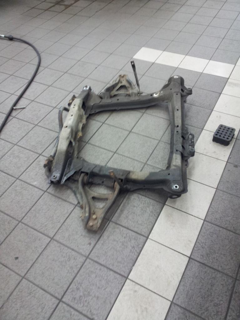

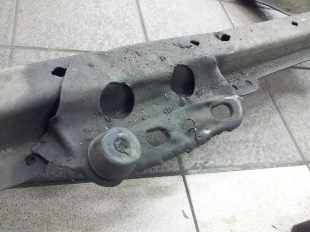

And the bent frame

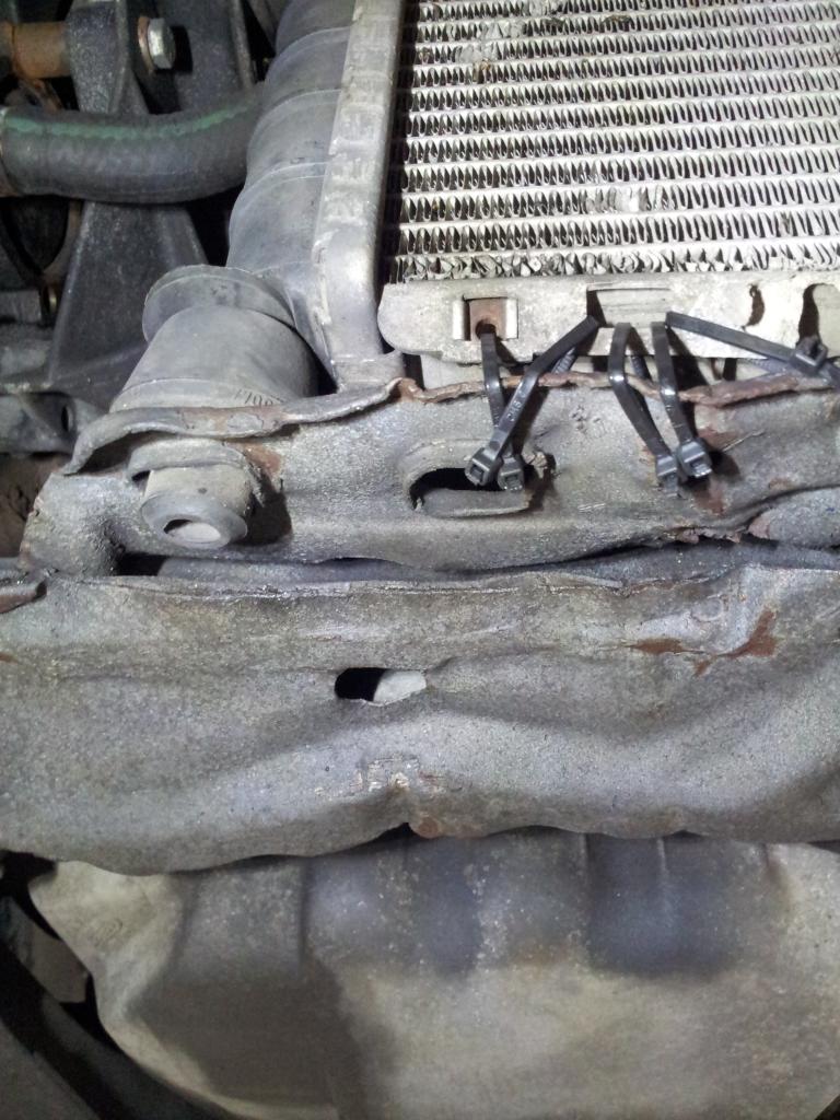

I now know why the radiator was cable tied, the two bottom lugs have snapped off, so I need a new radiator aswel

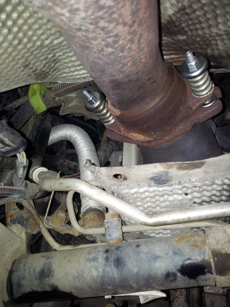

Whilst the frame was off, I fitted a genuine cat fitting kit, as tree was only one bolt in there

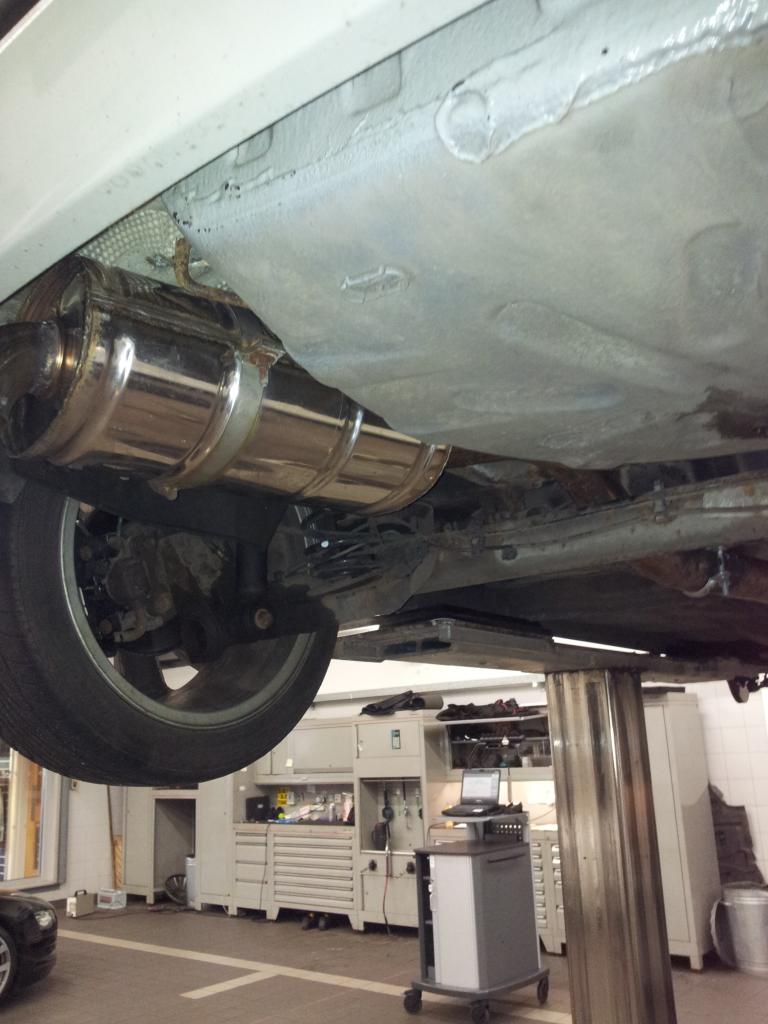

I rebuilt it, with all the new bushes, and then fitted the KTec

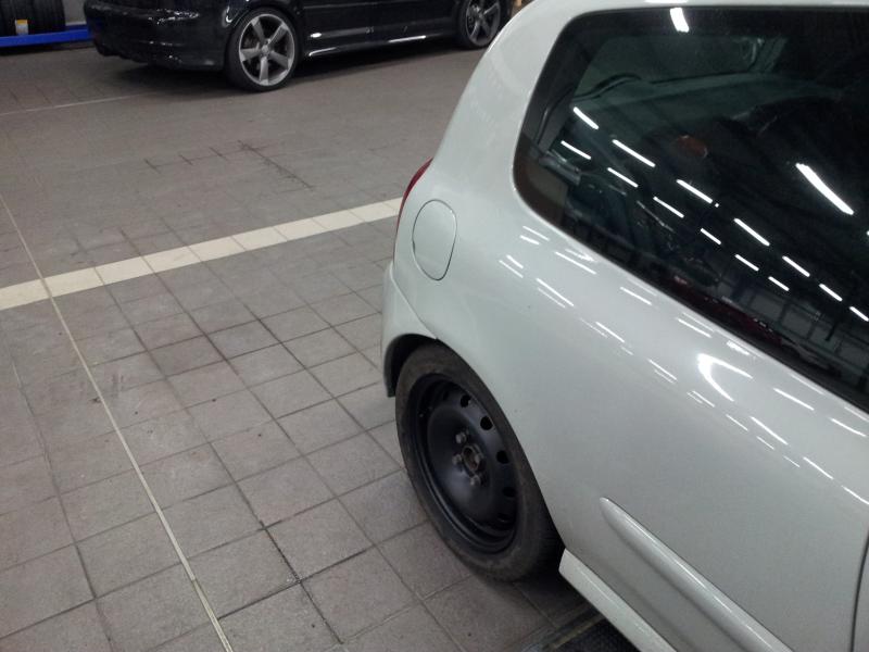

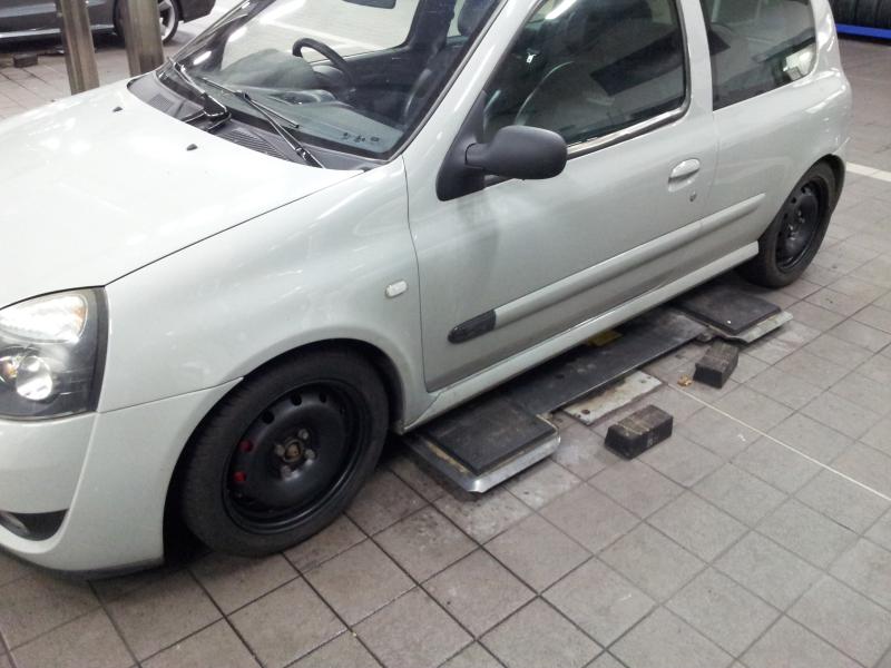

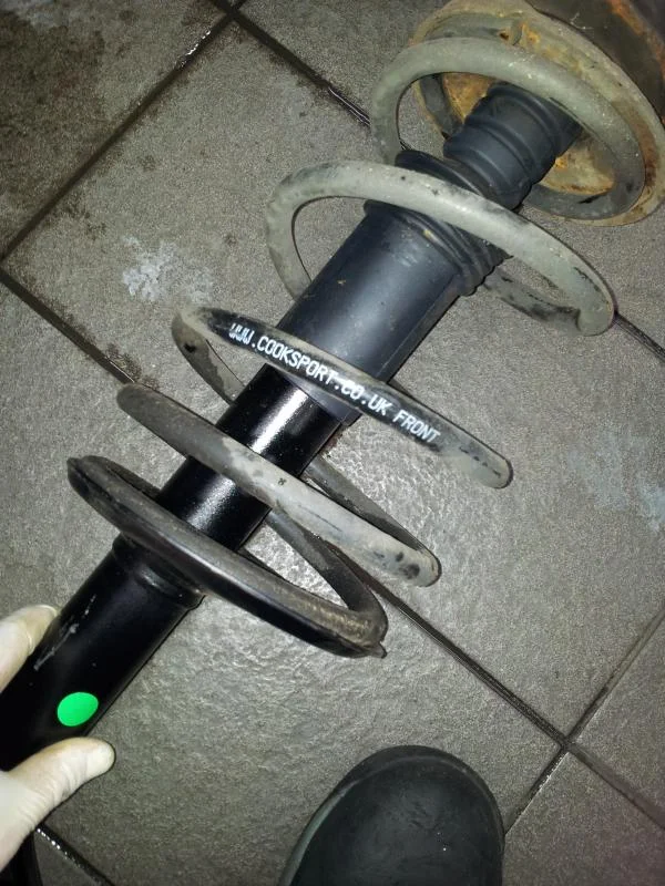

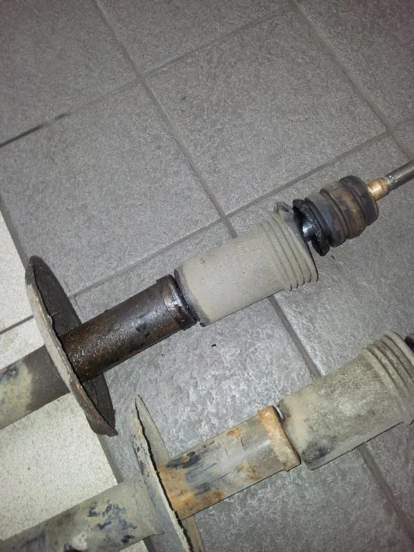

So, new shockers were desperately needed. The rears had totally leaked, the fronts were that bad the car was around 1/2 and inch lower at the front! So, my local Renault price matched Wolverhampton Renault and did me front and rears plus dust boots
Old
New
I've never really bonded with the Cooksports, and ideally wanted some Eibachs to replace them with but never found any at a good price. It really is quite low on just springs
I've also been trying to find a good enough image to fix the airbag wiring, and fianlly jotted down the plug layout off another Clio, so maybe I'll sort the light eventually! Whilst the shocks were being replaced. I replaced the cut handbrake cable that's been like that for around 4 months! Now the handbrake is 3 clicks, makes me wish I still did carpark handbrake turns as itself to for that!
Finally, I bought some 15" steels off here, and some 195/50 R15 Goodyear winter tyres. I fitted these last week, and on fitting them, realised the front tyres I'd fitted less than 2000mls ago, have scrubbed to nothing on the inside! I fitted the winters, and the steering was appalling! I had it aligned yesterday, and it's mich better now!

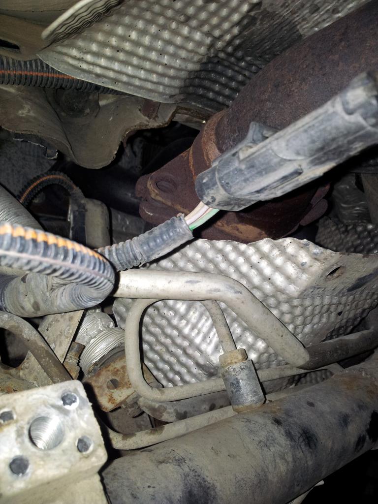

Whilst fitting my microphone, I removed the interior light unit, and found this wire - does anybody know where it's from?
Could possibly be for the small fan unit (for climate control) that reads the air temperature in the car?? It's common for them to start making an irritating buzzing sound.
why doesn't the outside temp gauge work? I'd of thought if it was a sensor issue, it'd read high/low or just dash, but there's nothing on the display?
I have the same problem on my 172 :confused:
  Clio 172 2003
I have this problem too on my 172! Somebody have solution? And I have too the buzzering noise from the interior car light.
I need help please.
  2003 Clio 172 Cup
