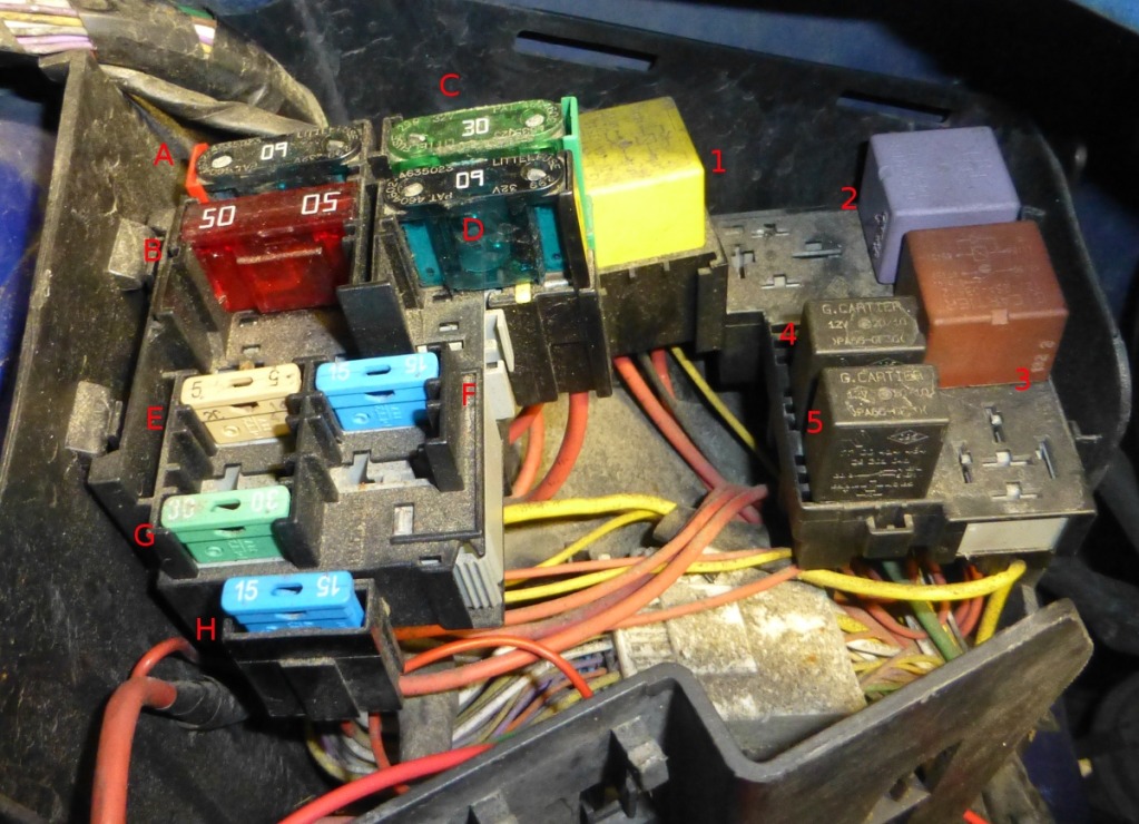

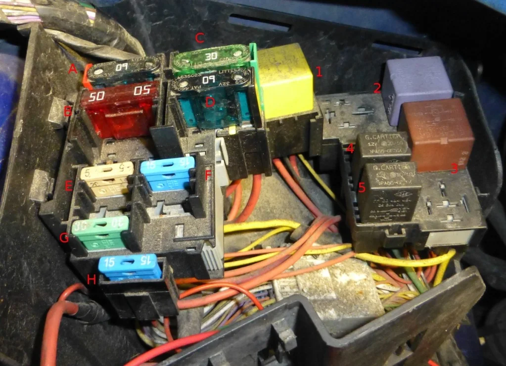

Have you tried swapping around the little relays in the fuse box to see if this cures the problem.
Swap number four and five around. They may be salmon colour in the 172/182
Hi Graham,
I have not done this, Could you tell me what these are for and why it could cure it?
Yeah, they are for the fan relay and one for the ignition relay (turns off the imobiliser). Both the same so if you swap them around you will see if one of them is duff.
If the immob relay can work intermittently if it's giving up.
I had a similar problem on our car and a new relay solved it. Swapping around was an affirmative test though.

I had a spare 5 mins so went out and tried it. No difference unfortunately.
