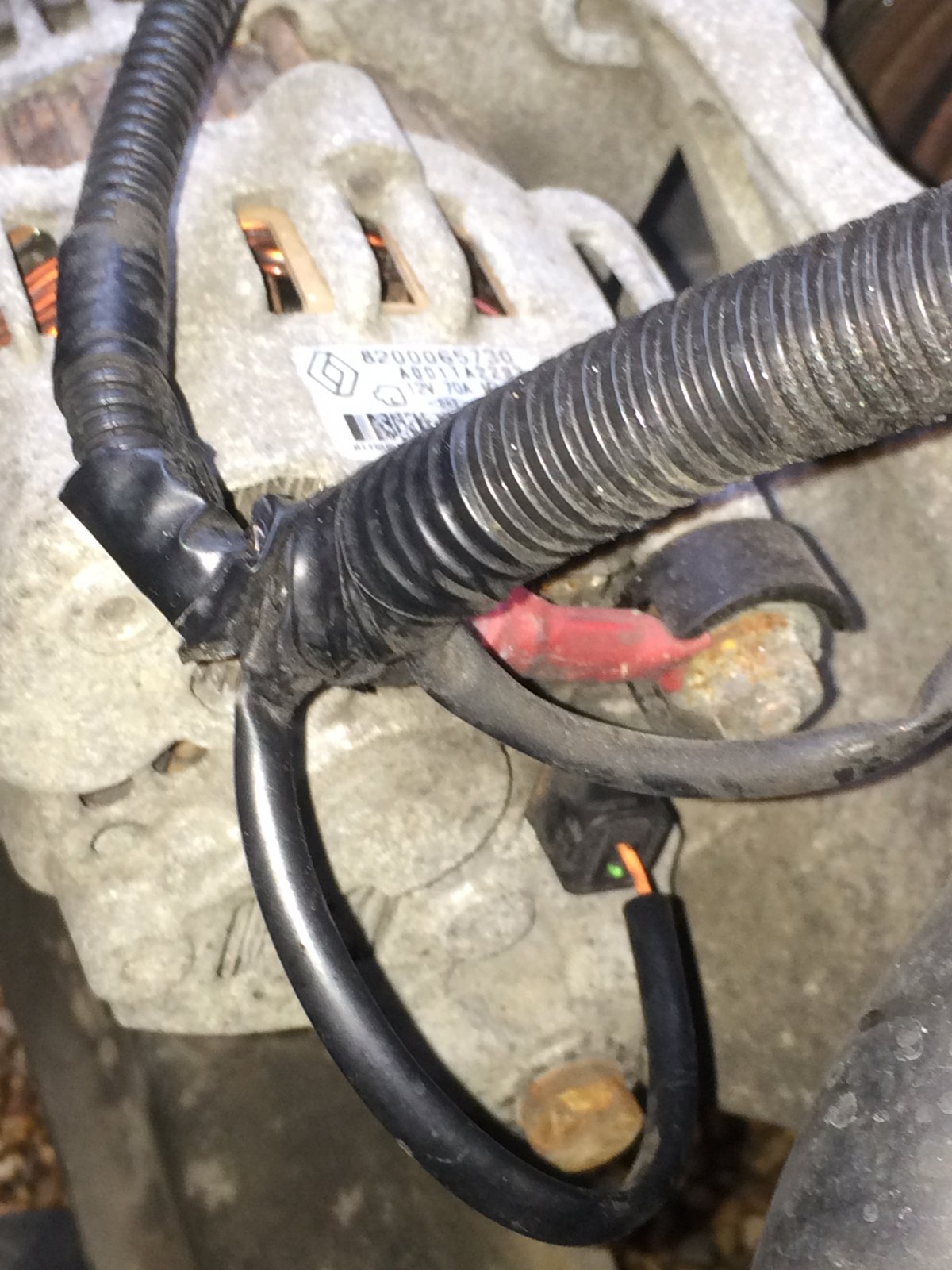

I then looked around wiring etc and Earths seemed to be good. However I noticed this on the alternator.

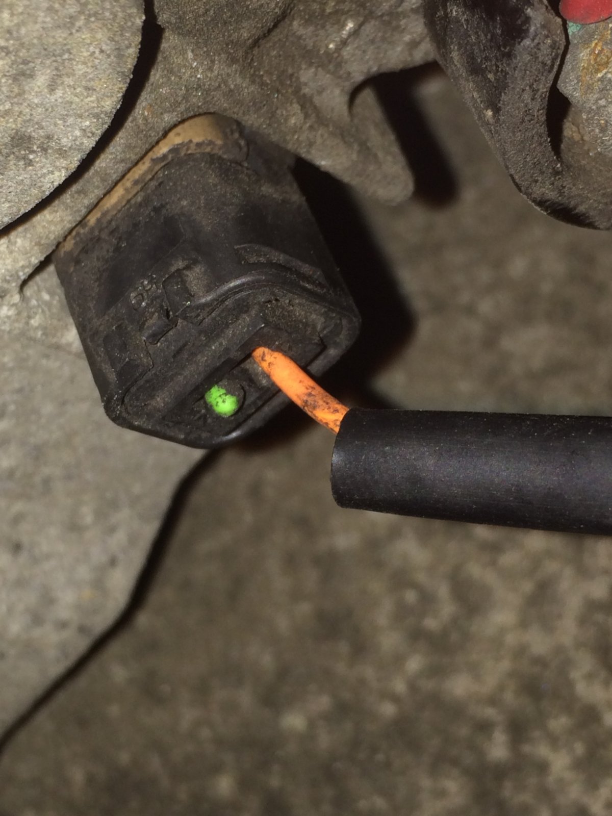

Likely to be an earth for the alternator? I traced the loom up to the open sleeving and there is a green wire inside.

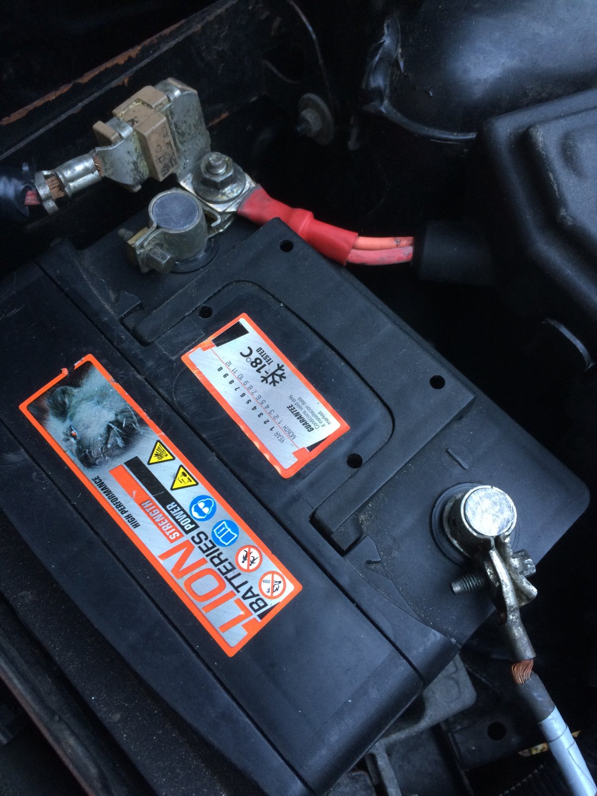

I have also cleaned the tdc sensor, looked pretty clean anyway, and also cleaned all the battery connections and terminals.

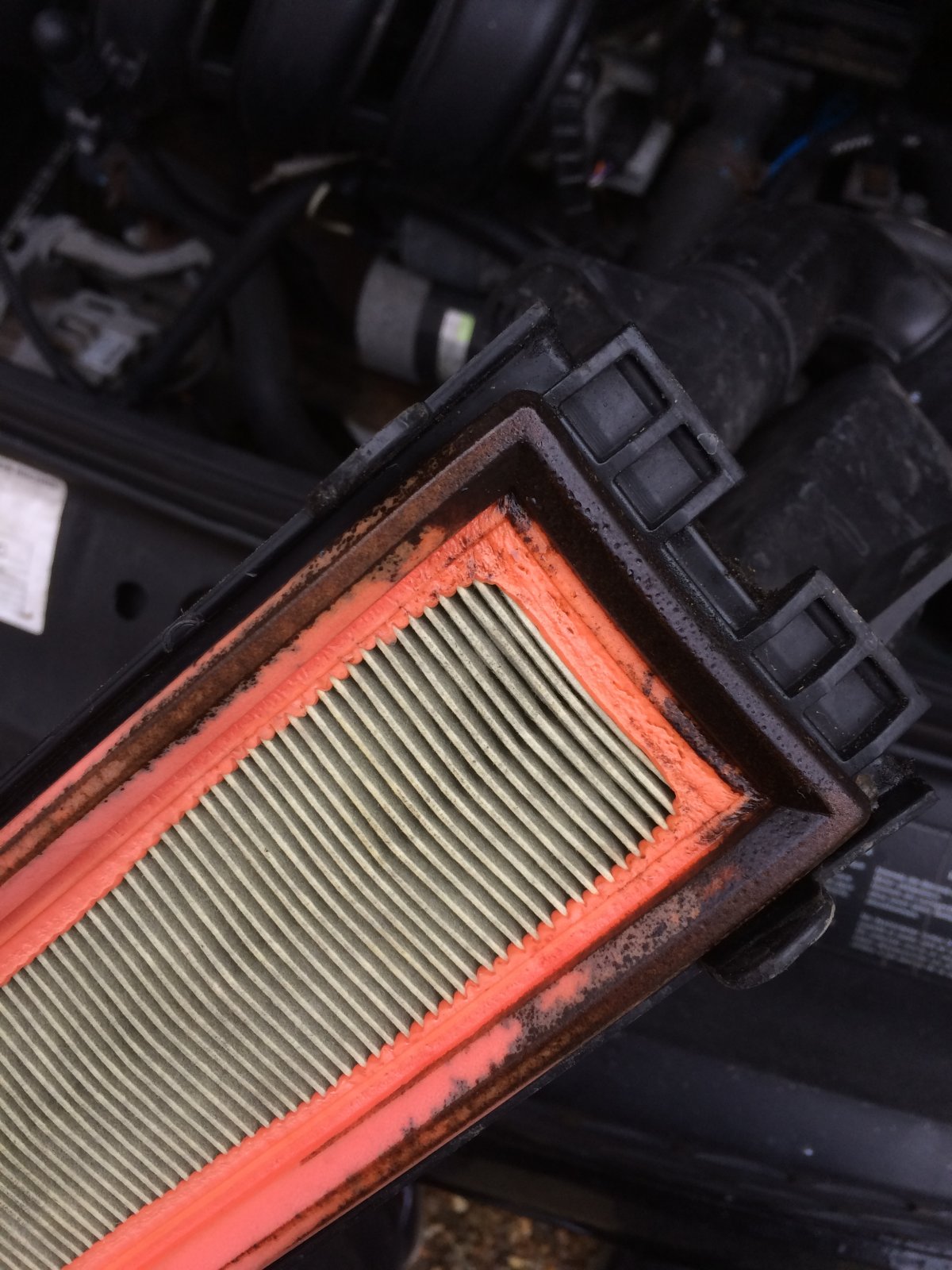

Another thing I noticed, my air filter seemed to be covered in oil, or something similar.

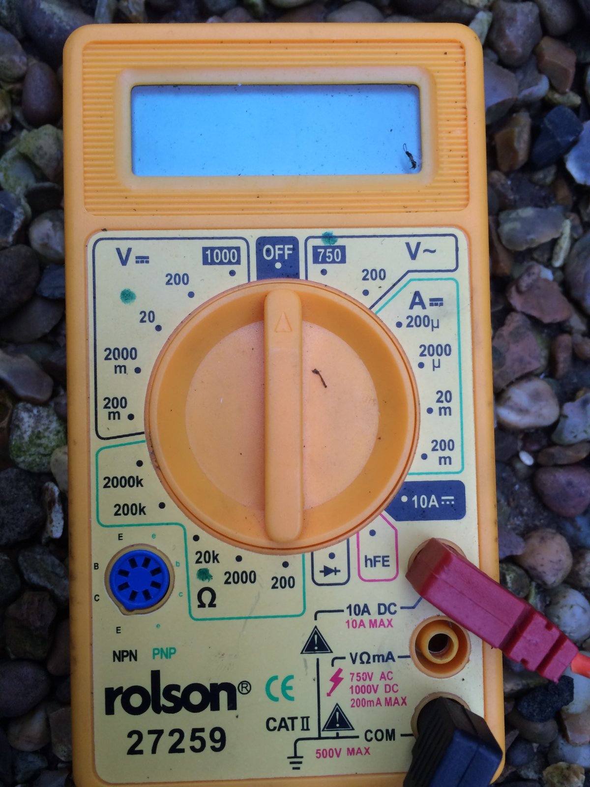

Also as I'm bit thick I can't work out what setting my multimeter needs to be on to test drain. It's a crappy one but I shall be getting a new one soon.
Not sure what plug hole the positive goes in. And if someone could direct me to the right setting that would be great. Multimeters are something I've never got my head around totally haha.

Altinator should be putting out around 14 volts, 14.7 is a tad high,
Ill have to look on my altinator but im fairly certain that there is two wires that should be connected to that plug, although i could be wrong, and the green bit may just be a cap for the terminal...
Oil on the air filter can happen as the crank and cam cases are vented back to the inlet... may have been a tad full or run at a funny angle while driving to cause that much oil, although i have seen almost the entire air box full of oil on some clios...
As for the multi meter, the plugs are in the right position, start on the 10 amp setting (the solid blue section) incase there is a lot of draw, then u can select a range in the A section that best reads what its pulling, note that its wize to keep all the doors and stuff closed so the interrior lights dont skew the reading...

Okay I see, i did have it on that 10amp solid section but it didn't give any reading back. Well it was a tiny tiny amount. Suggesting there's no drain?

took a look at my altenator, only one wire is going to the plug...

the 10 amps setting was just to start off with so you dont blow the meter if the car was drawing more, put it on the 200 range in the A section to get a more accurate reading, make sure you are disconnecting the earth line off the battery and running the meter between the negative on the battery and the earth of the car...
Had a search online and others said they had one wire. Cheers for looking!

Oh I get you, yeah I put in on 200 and didn't generate any bizarre reading so doesn't seem to be any drain with battery. Yeah I did that mate cheers
