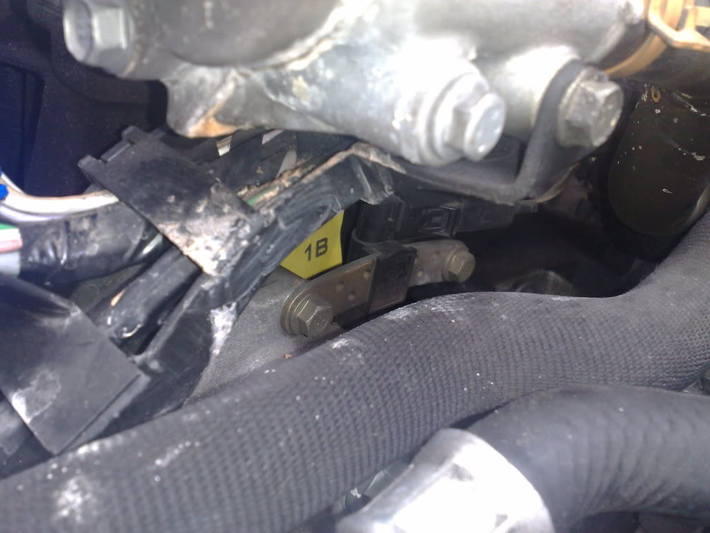

Try wiggling the crank sensor. Used to do that on break downs, 9/10 it'd fire straight up.
Okay will give that a go today! If that fixes the problem would it be worth putting a new one in? Also where about's is it on a 172? Sorry for all the questions new to this Renault stuff lol
Top of the gearbox/bellhousing, under the thermostat.
