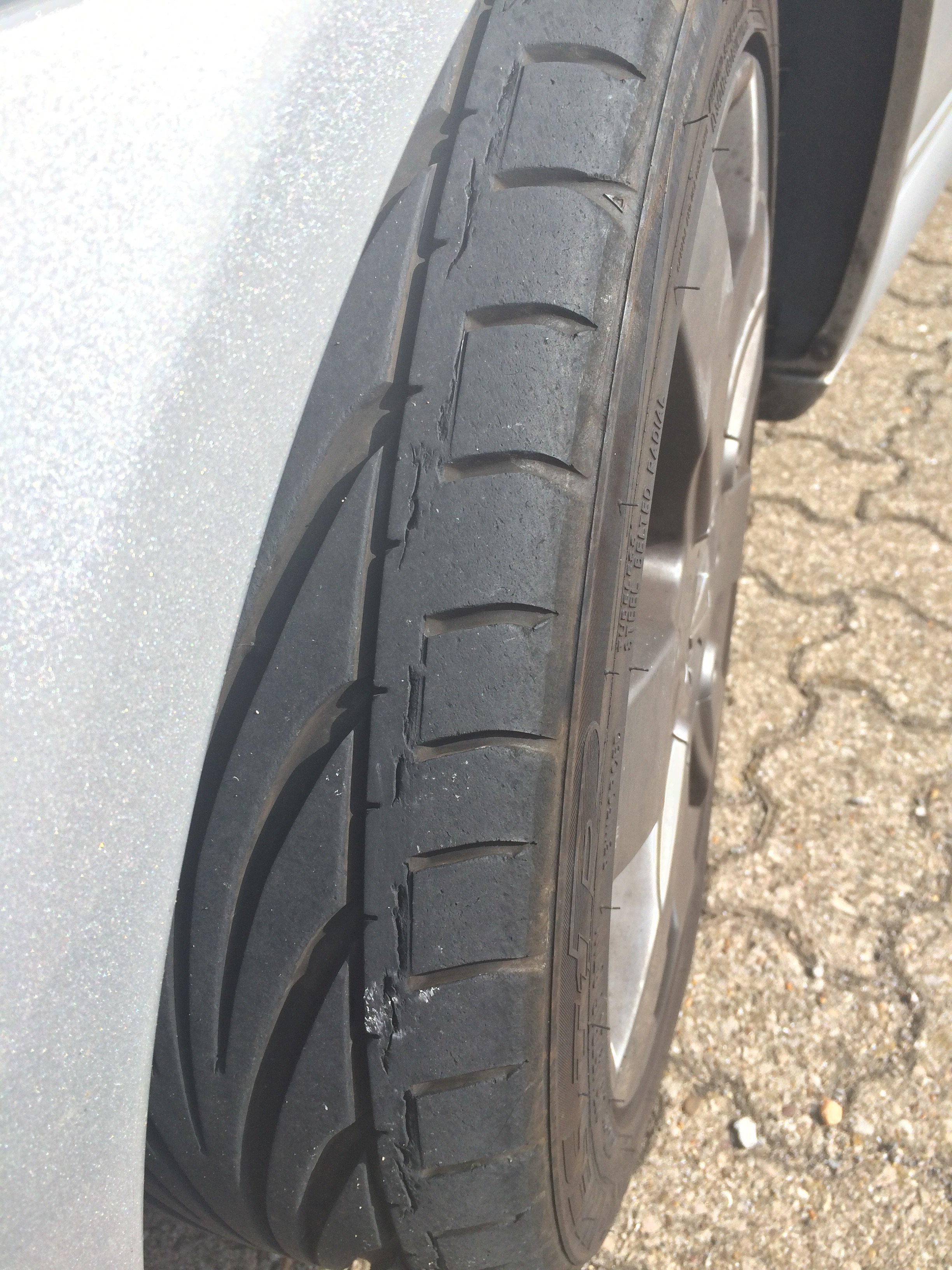

After I good track day I did not long ago I noticed some strang cut marks to my tyre and was wondering if any one has come across this before ??
I haven't lost any air out of it and it hasn't blown yet, just my daily drive so haven't changed it yet
just this one wheel?
Off the bat and without seeing the car, I suspect bump stops and the tyre is rubbing on the bumper bracket
+1. Looks like something is rubbing. What make are the tyres?
They don't look like they got "that hot" for them to de laminate. (have seen that before with sh*t tyres or defective ones).
