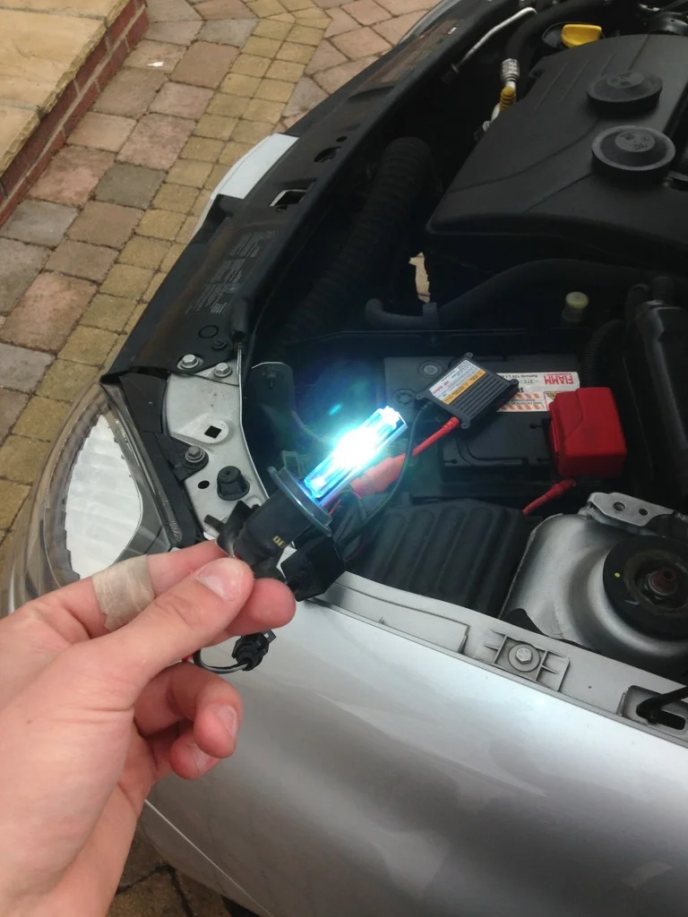

I know ill probably get some negative comments here, but I can't seem to get the HID bulb to stay in the lamp.. I ordered new bulb clips and still is a struggle to get them to stay firmly in, any help?

You need to get the metal bulb holder and put it in place as it would go but on the hid bulb. You can either cut the rubber bung away (the rubber grommet the wires go though) and feed the wires into the hole or you can trim a slot in the bulb holder to allow the wires to slide into the hole.
It's all the correct fitment etc, but the clip is such a struggle to get the lugs to fit into the slots, can only get one in :( Have been told by various people it takes patience and a big push..
