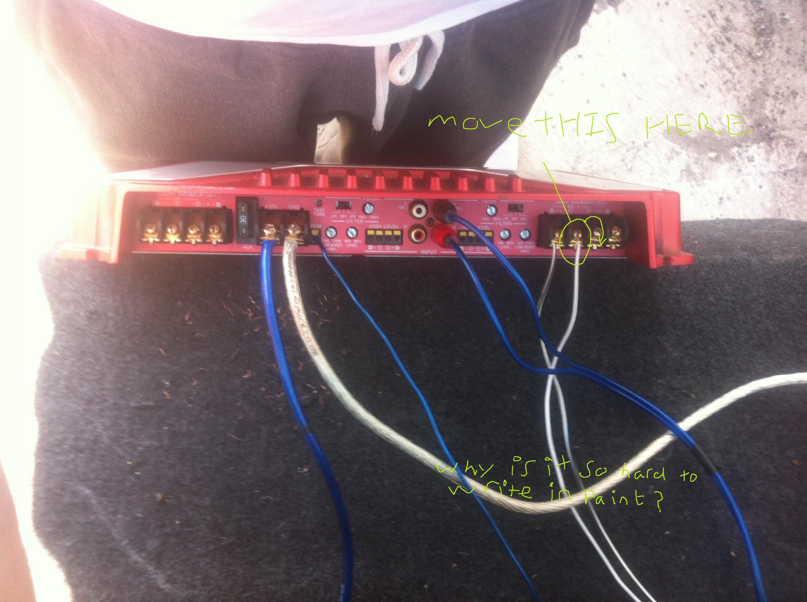

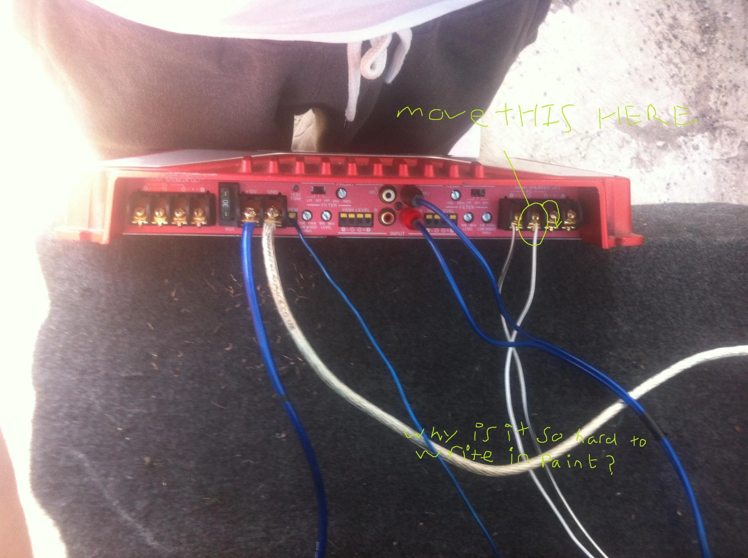

Could you explain how I would check the impedance for the subs? and how would be a better way to wire the amp? I'm going to take a picture of my amp so you can see and help me get it wired up correctly.
  clio mk2 1.2
Theres the picture of my amp I tried my best to get a clear one, am I wiring it correctly?
  Polo + Micra
where is the other sub connected?
i'd connect both rca's to the white ones on the amp (think it says BTL in brakets) which is short for bridge tied load
then connect a sub on either side also marked BTL as shown by l33th3tree
set the filters to LPF and the dial screw so it's at about where 80Hz would be then set the level to min and low boost to 0dB
then try and see if you get anything out of the subs
