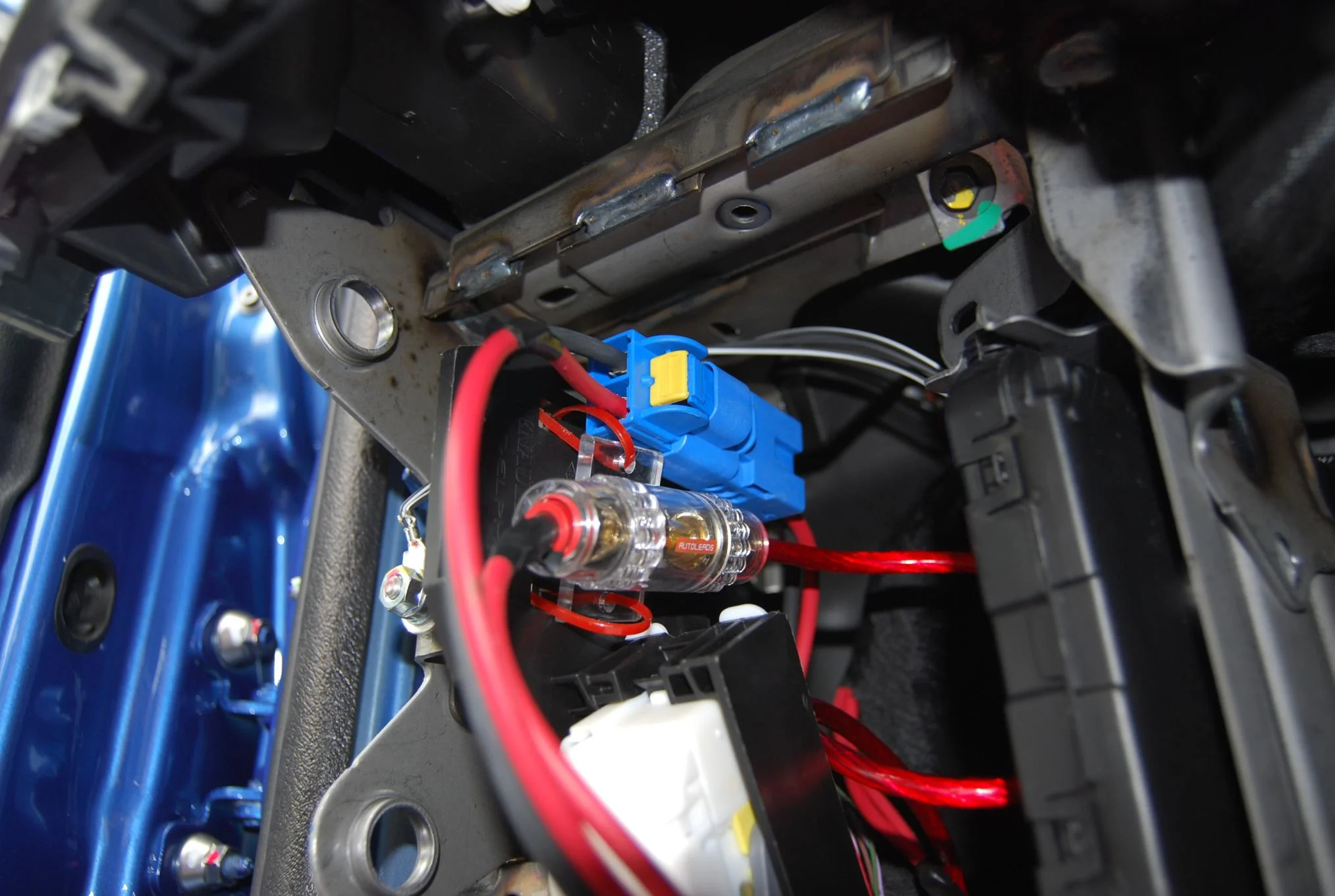

I found the hole where all the other cables go through however I can't get the sub cable through there... Any one else done one and found a way?

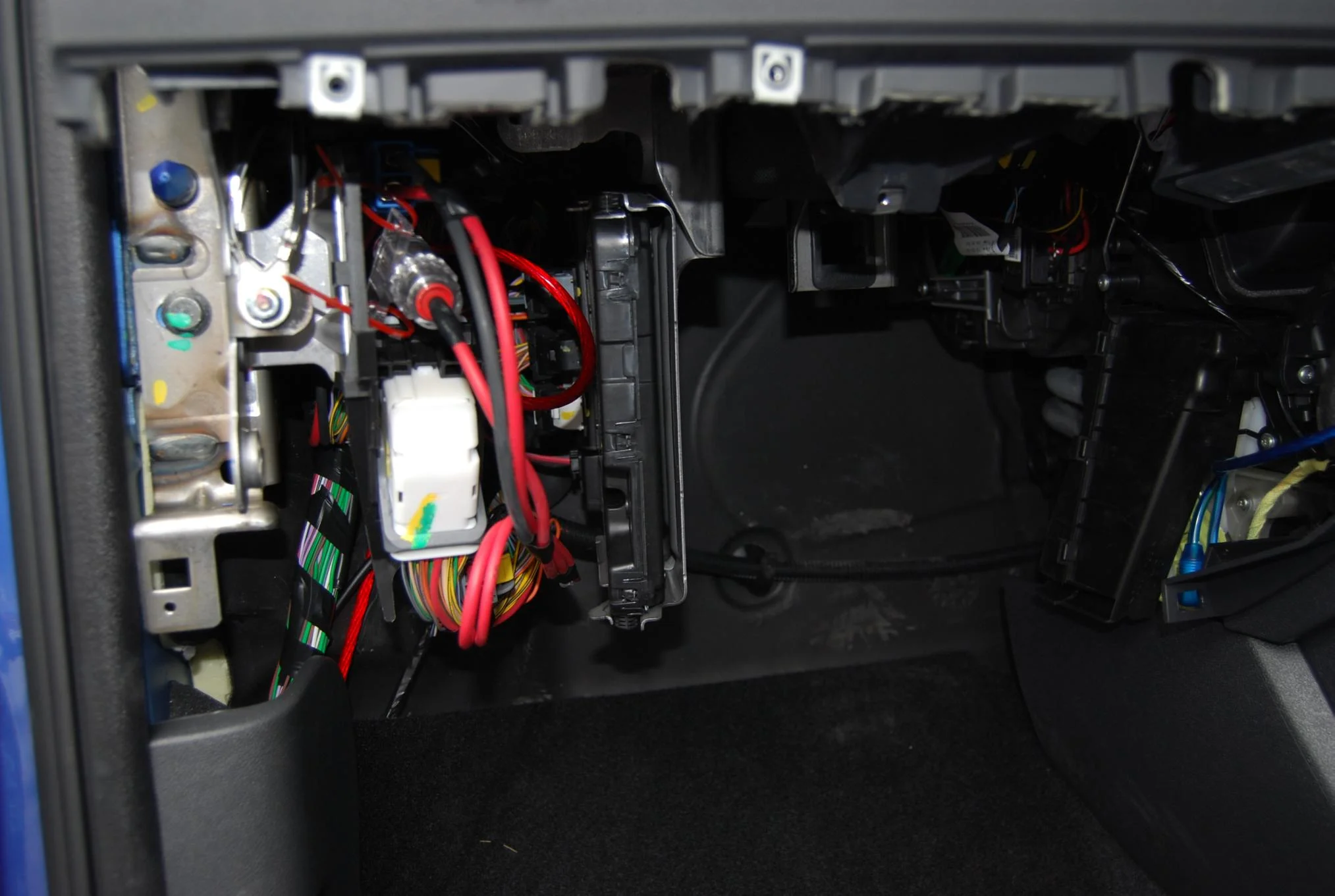

I have done it but decided not go to engine compartment. We took the glove box out and there was red thick wire with plug connected to the blinded socket so we cut the plug off and connected the amp wire to it. Works very well.

thats fin if your using tiny tiny wireing like yours (your amp must be either very small or very under-powered). Actually even then its not ok, that cabling is obviously ment to take the load of something else, and with your amp + the original load it could cause problems!
I would suggest direct connection to your battery every time. either use an existing hole or make a new one (make sure you pait it and seal it so it dosnt rust or cut the cable).

You are probably right but I have it connected like that for over a year and no issues at all so it kind of proven to be OK. Indeed I have very simple set up.
