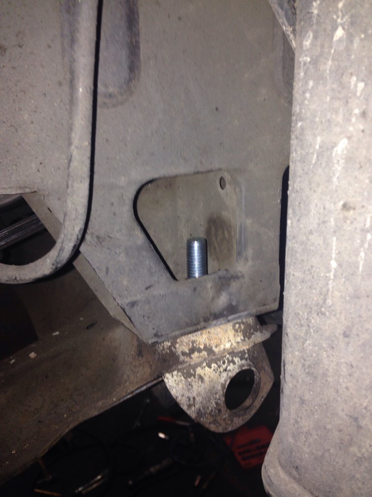

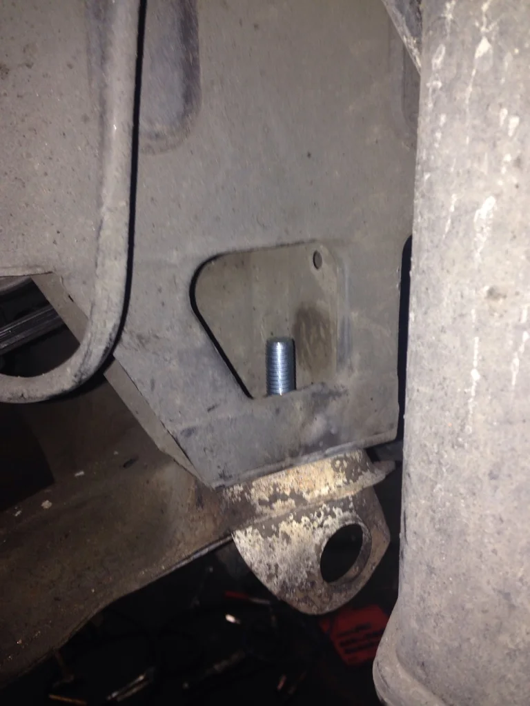

anyone know what size the front o/s subframe bolt is? i know the head is a 16mm but not sure what the thread is, thread has completely stripped on mine

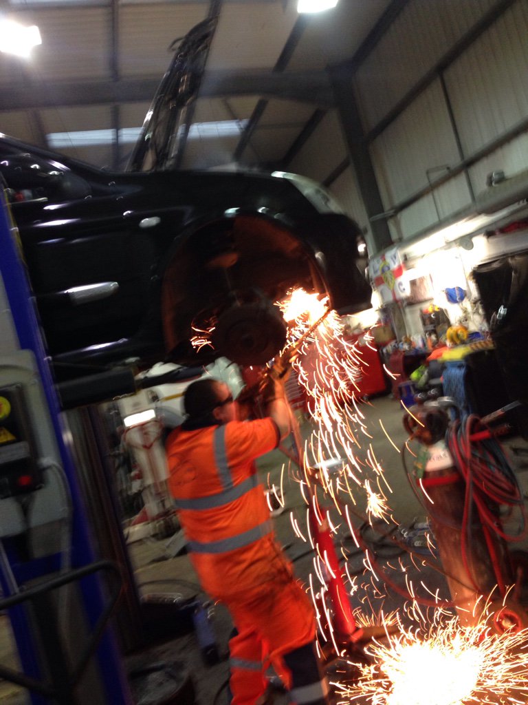

Had similar issue when doing my clutch... Threads were completely gone and just spinning the nut.
Problem solved....
Will see if I can find what size it was I used as I can't remember off the top of my head...
Problem solved....
Cheers mate, I've used some m10 25 or 30mm with some thread lock all sorted now

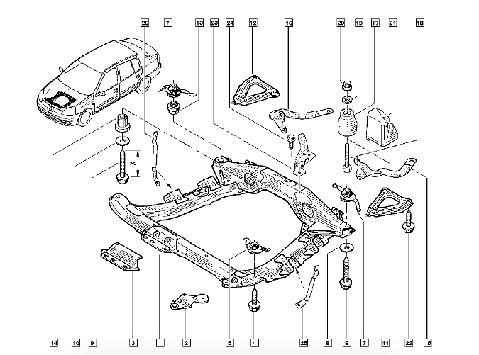

4 and 6 pal but ill now need lock nuts as well. We dropped the nearside to get to box so the offside are still ok (albeit loose so hoopefully they dont spin)
MarcB
  Too Many
Item 4 is the front bolt - 7703602230 = £3.40+vat Each (You Need 2)
Item 5 is the front captive nut -7703044200 = £4.05+vat Each (You Need 2)
Item 6 is the rear bolt - 7703602200 = £5.90+vat Each (You Need 2)
Item 7 is the rear captive nut - 7703044201 = £5.62+vat Each (You Need 2)
