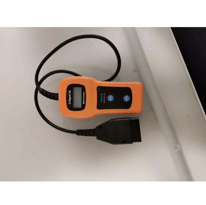

On the subject of code readers what’s the best to get?. I read that a Renault Clip is the daddy but it’s expensive.
Sure i've still got an iCarsoft i907 code reader somewhere.
You can have it if you want, if i can find it.

My mate has this. Will it be compatible and if so where does it plug in?

My mate has a Memo Scanner he has lent to me so I did a scan with just the ignition on and it showed no codes. I started the engine and again no codes came up. I removed all the relays in the engine fuse box, cleaned the contacts and refitted them. The last time I did this whilst repairing the fuse box and putting some dielectric grease on the white plug the engine ran rough. I had to push all the relays back in and it cured the problem (hmmm, a relay issue?) Today, however, it has not cured the problem. I checked that the plug to the coil pack was fitted correctly and also the plug leads. I did another scan (no codes showed) and ran the engine. I could tell immediately that there was no difference and again no codes came up.

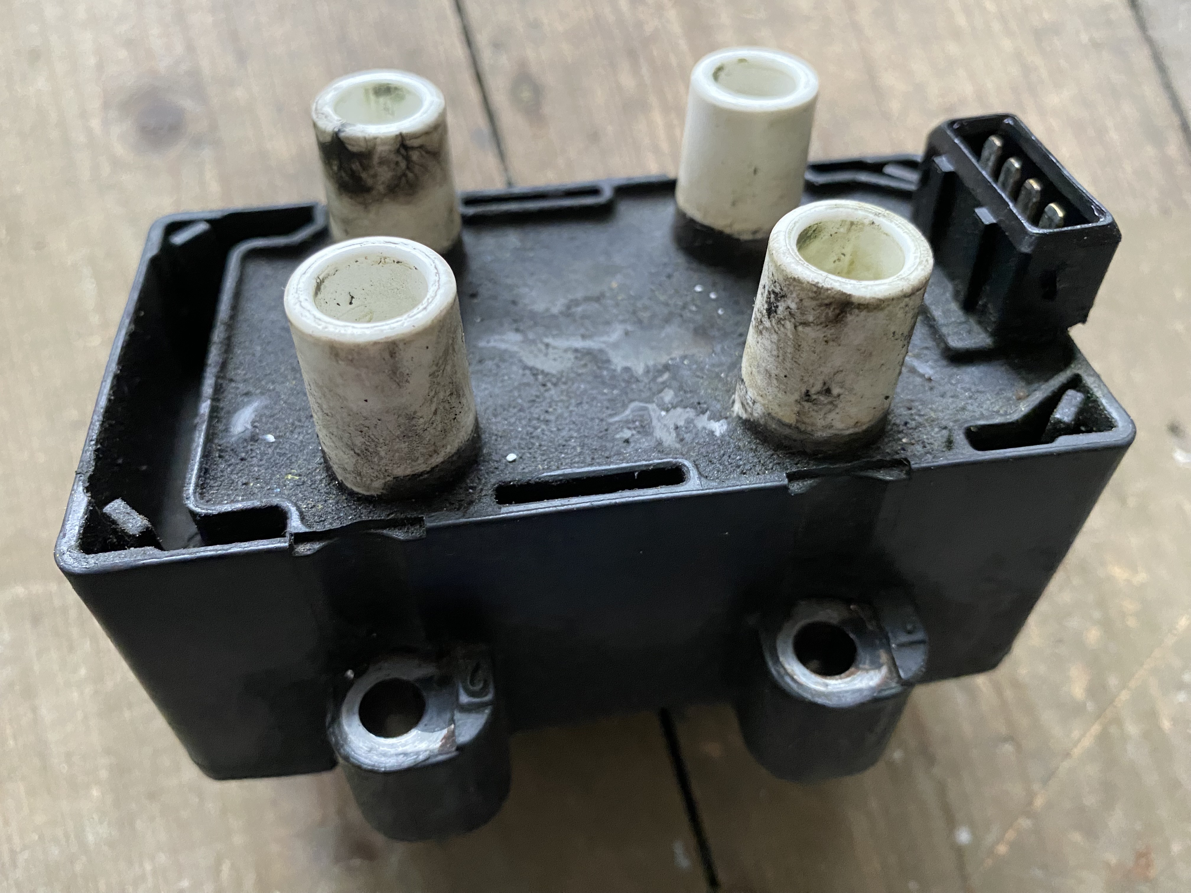

I fitted the new coil pack and instantly the car sounded and felt right. I’ve been for a very short test drive, only about 10 minutes, and let the engine warm up. The car feels fine now. In fact, it feels a little smoother than before, but maybe that is just me feeling so damn happy that another issue has been resolved.

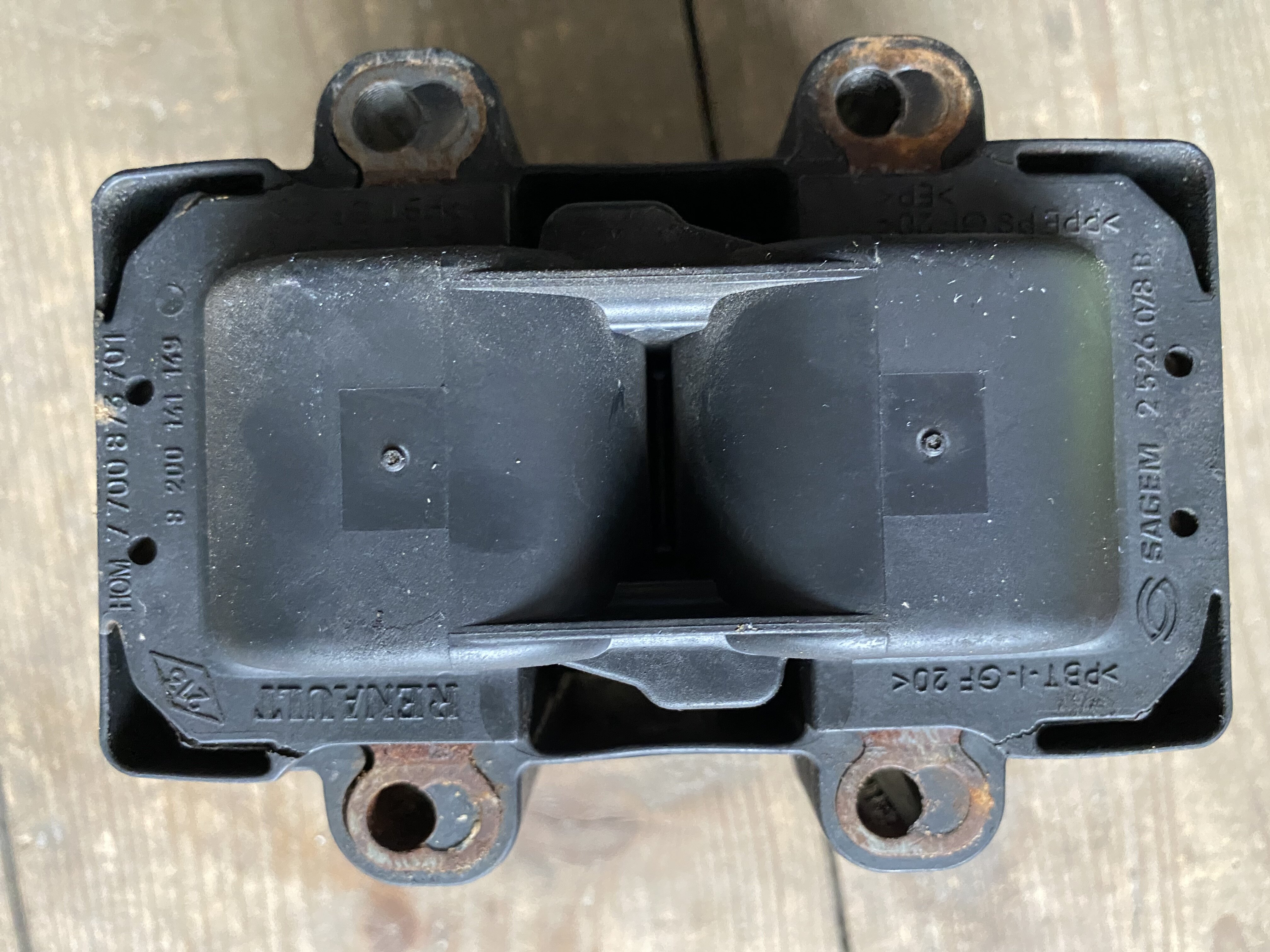

Even though the old part was a genuine Renault item it has been off at some time as the two bolts at the back are missing. I will try to get told of these as I want to get everything present and correct on the car. I have a new set of NGK spark plugs that I will fit next week. The leads currently on the car are marked as Renault, but if you look closely at the male connectors on the coil pack, you will see some black marks. I am wondering if there was some kind of connection issue that has caused this burnt look. I can’t smell anything except WD-40, but I think it’s wise for me to fit the new leads next week.
