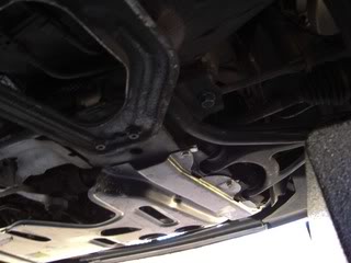

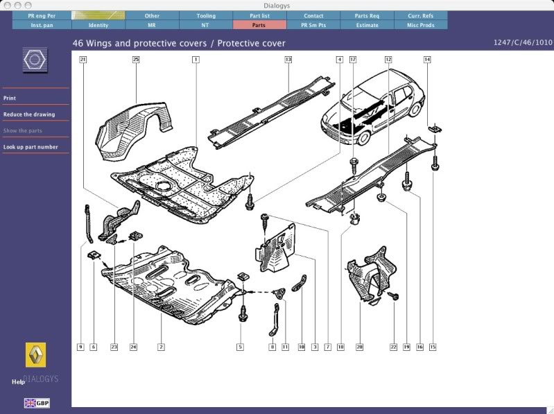

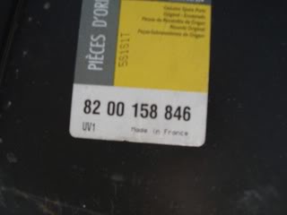

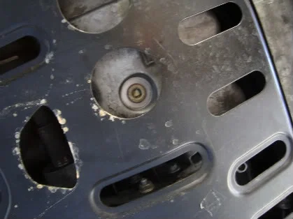

it's number 2, and yes i got mine directly from renault, it fits directly over the sub frame.
i'll take some photos tomorrow.
Awesome, will enquire about that then, that'd be cool if you could man. Is it the same as the one below? Does is actually stop the impact okay? Hmm, I don't think the plastic one will do the job TBH, it is getting quite a hammering occasionally. But thanks for the other idea, much appreciated. Didn't even know you could get plastic ones! :D

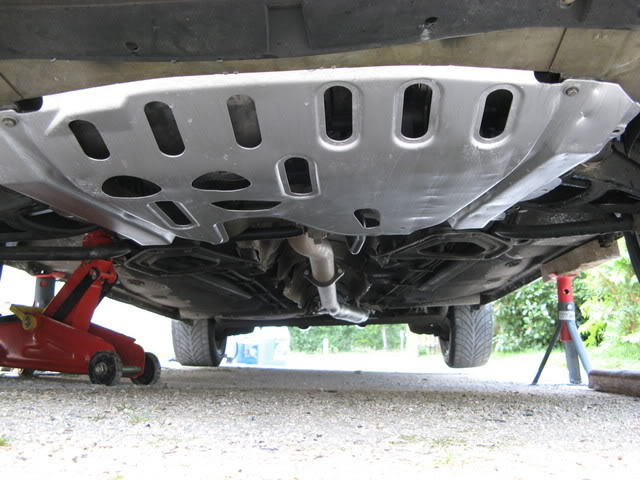

This is the metal one:
Or you might be able to use the plastic 172/182 one.
Awesome, the metal one does look cool :D . Looks quite sturdy as well. That will fit over a DCi I'm guessing? Will just be a little more room behind it?

How did you fit the guard??? Where I live all non-RS clios came equipped with the metal sump guard, so naturally I went to the dealer's but they told me that the metal guard wouldnt fit the 1*2.
  Lots of Alfas

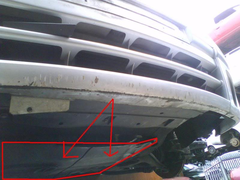

If you look at the rally car refresh thread in the projects section theres a pic on the first page of a home made guard welded onto the subframe. I dont know why the metal guard wouldnt fit a 172/182, im sure dialogies lists it for them, perhaps its something minor like the oil sump plug not aligning upto the access hole or something?

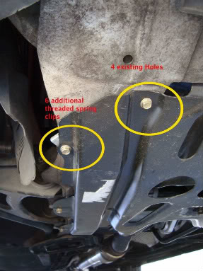

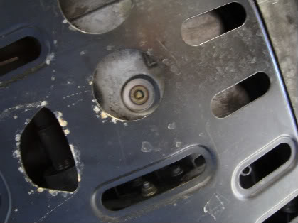

a little more detail here, can't comment as to why you were told it wouldn't fit.

Cheers for the fotos Peter.K, looks good actually. Will enquire to Renault about one cause it looks pretty sturdy, and it would fit being a genuine product...well, as long as those holes are the same on the DCi that is. :S
