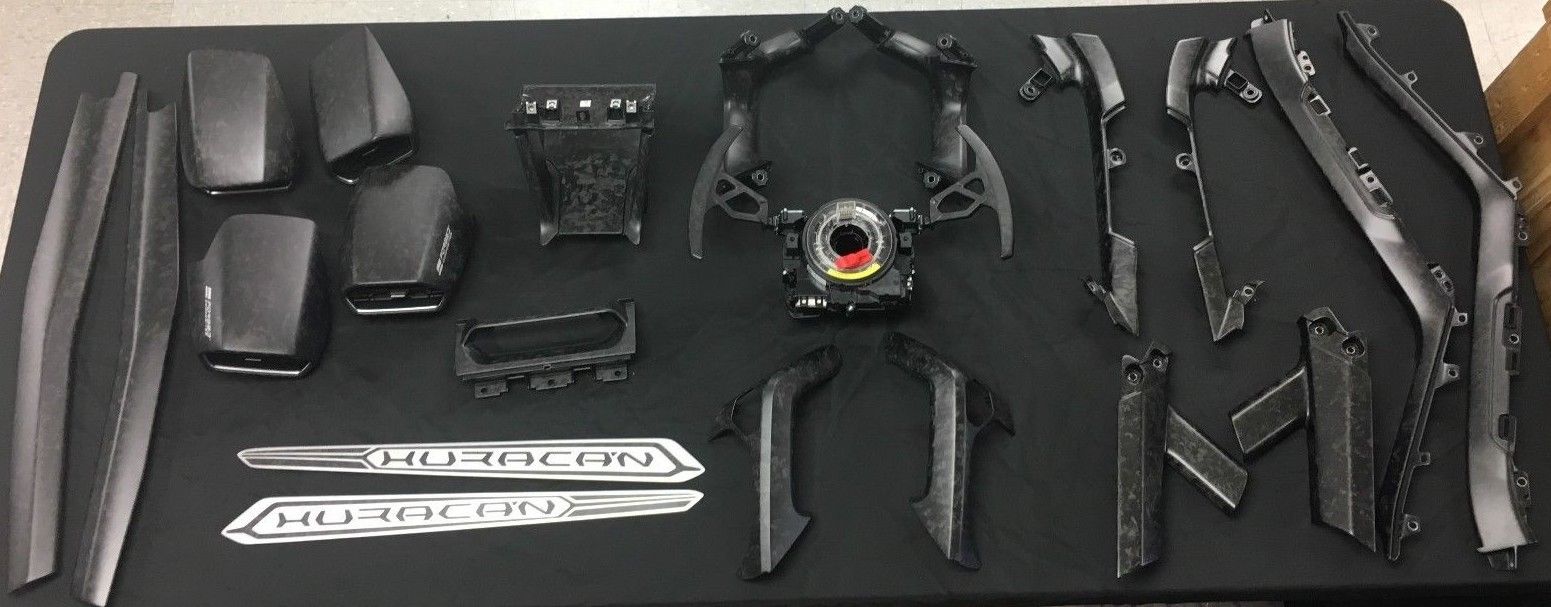

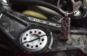

Its well worth having a look into forged/compression moulded carbon as it looks awesome and has many advantages over regular carbon (primarily cost!). Its ideal for things like spoilers, splitters, door handles and interior trim.

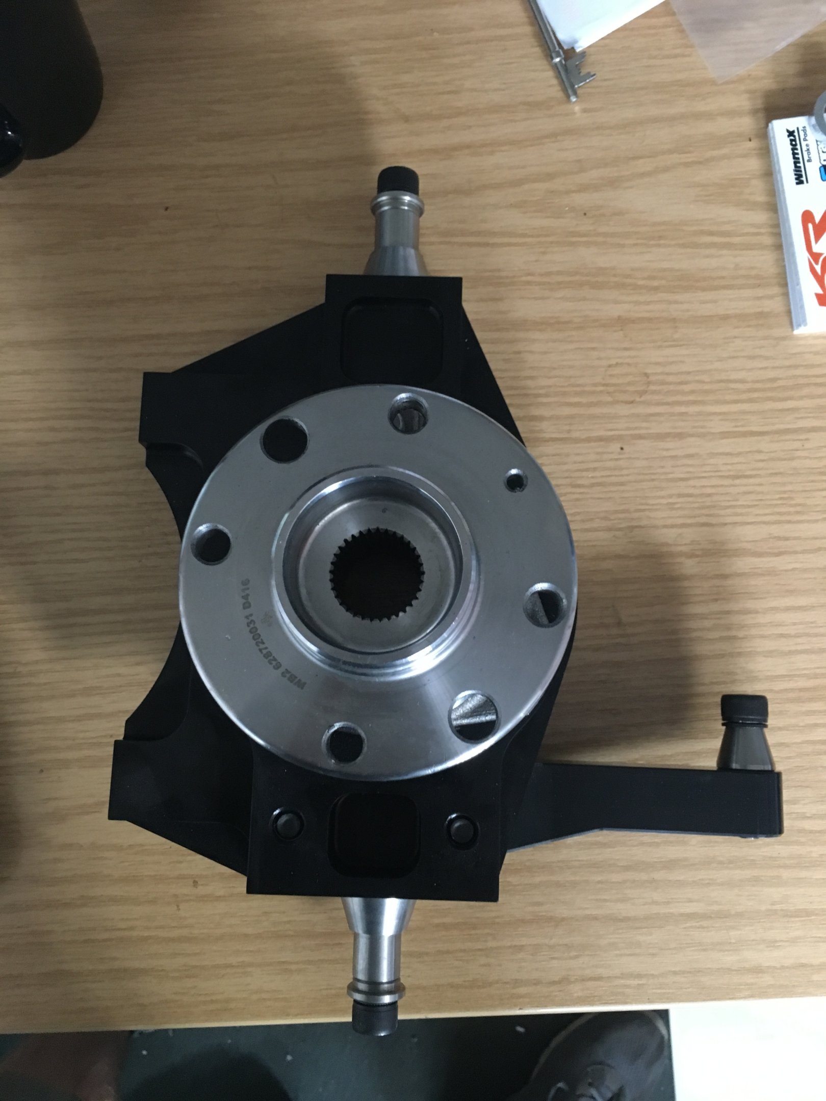

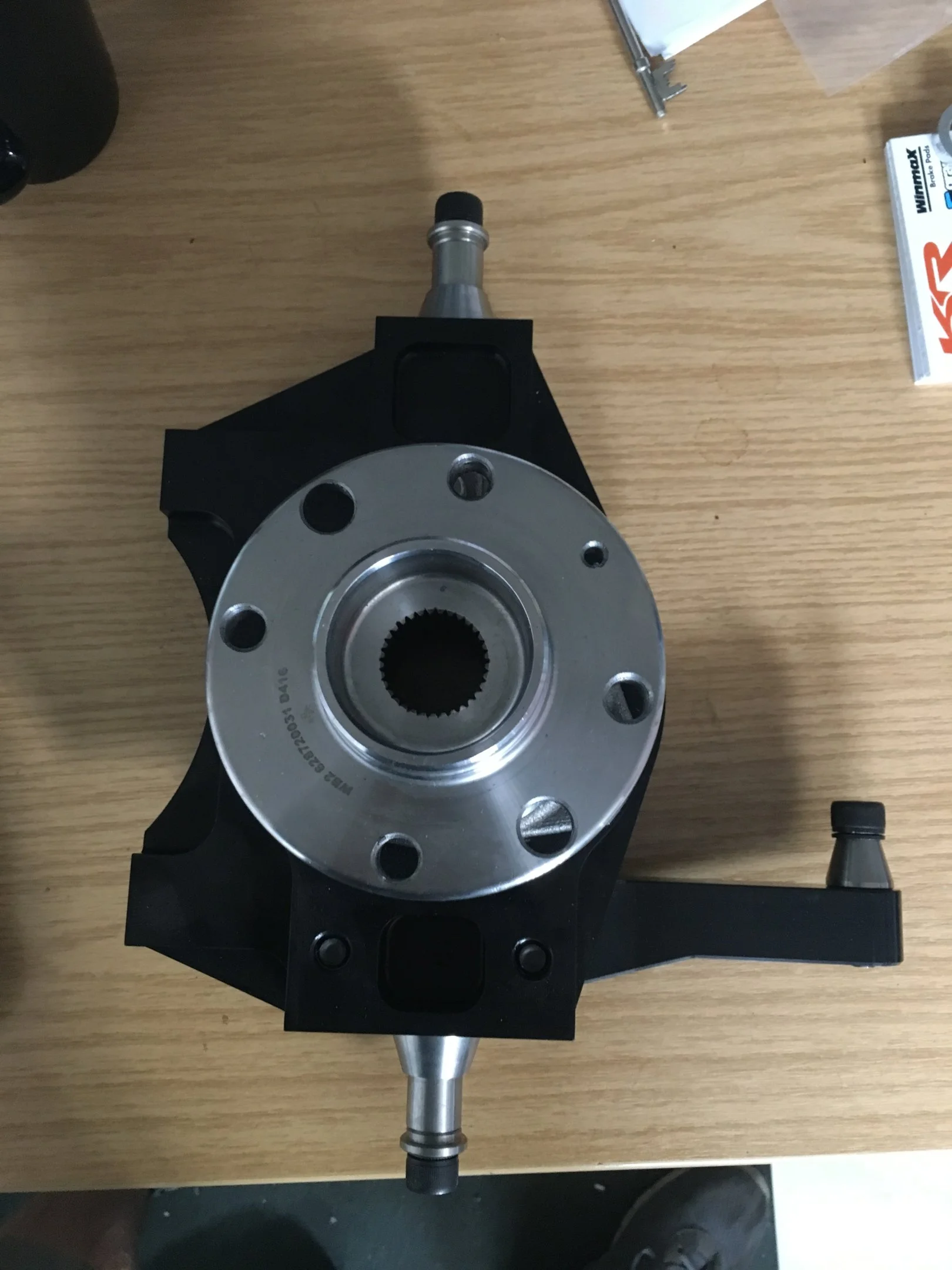

Cup racer suspension was nice but brutally harsh. Realistically you could do a custom front hub to sort the roll centre easily enough. Getting it lighter than the originals would help finesse on the bumps.

Something like this would sort the roll centre geometry and allow an examination on kingpin and scrub angles

Funnily enough, I own a Huracan Performante and forged carbon was something I was thinking of as making a feature point. Is your guy UK based? I know of a very good place in the USA, and am getting some bits for my Lamborghini because a) I want more carbon and b) to assess it's quality.

Yes he is, he is currently making some incredibly cool speed boat suspension seats too which won the red dot award recently - talented guy. Based near Chiswick, where are you?
He does the design work, not the molding. Molding is done in the UK for small quantity parts and in China for higher quantities however he has done the bulk of R&D over the last 10 years and knows a lot about the subject. Send me a private message if you would like more info/contact details.
