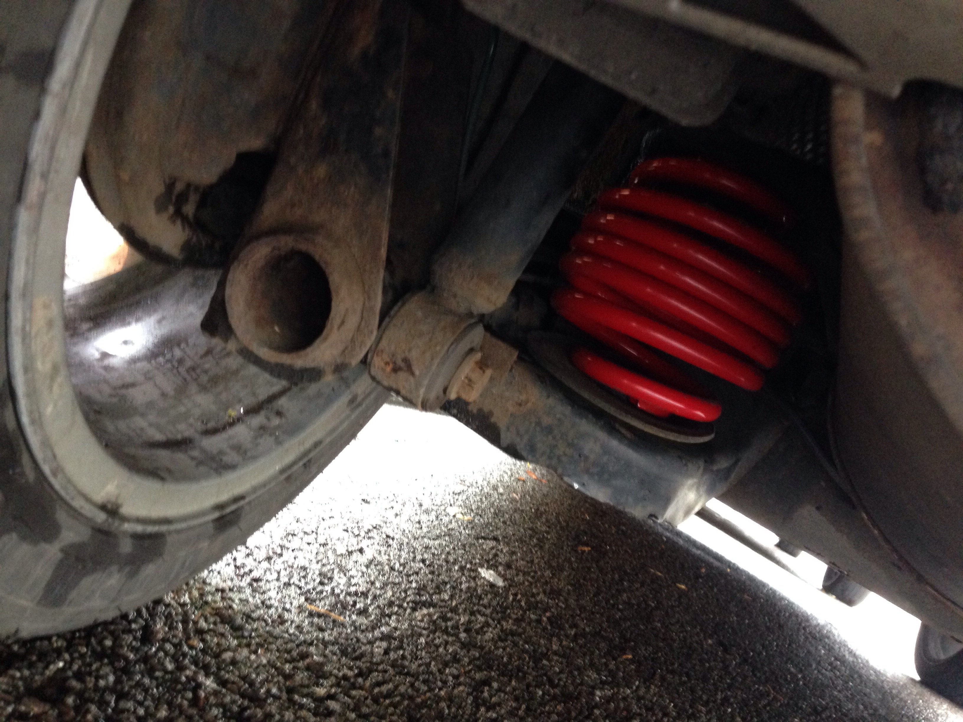

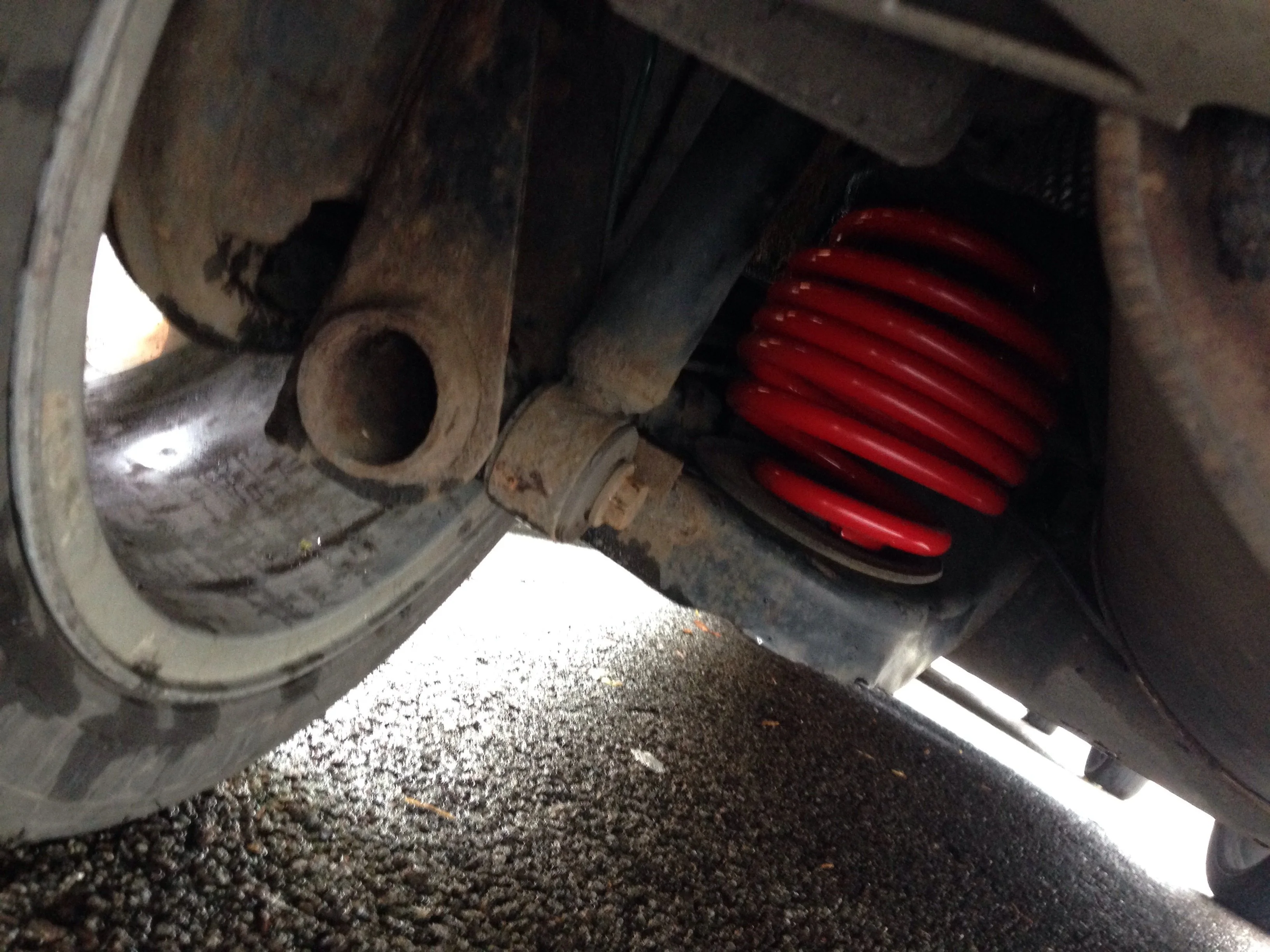

New development. This is the passengers rear. I can see now it's not seated properly but am I right in thinking springs shouldn't be compressed in the middle and flexed and the ends?
Tomotek
Who manufactures those springs?... they have 6 coils! never seen a rear spring like that.. they normally have about 4 coils!
Your springs look like they have a really soft spring rate to be coil bound like that too

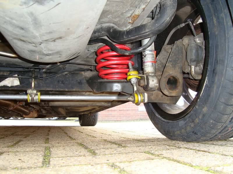

This is what I was expecting to see....
  Clio 2.0 16v 182
Yeah that's what I was expecting too. That was how it sat on the donor car. Sadly the manufacturing mark/part no. Is not present.
  Clio 2.0 16v 182
oh yeah definitely bin. Just can't tell why the springs work on one clio and not another. They're not cracked or bent or anything.
