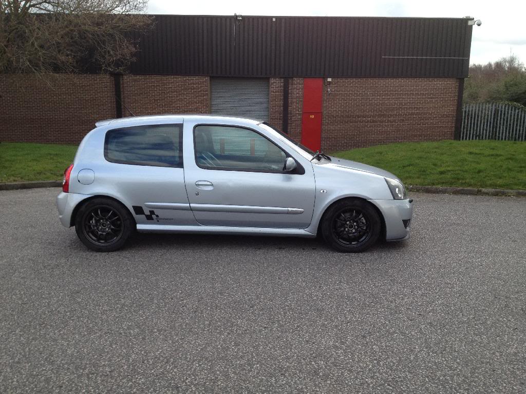

Its also running 10mm rear spacers behind hubs and 20mm hubcentric fronts with eibach camber adjusters to give -2.5 degs on the front.
Car does 600 road miles per week with the wife

^ that looks great
+1

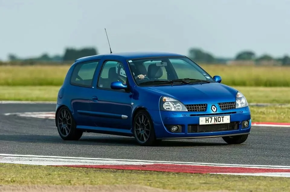

Not on a Clio but on previous cars and I was never impressed. The Clio cups have the best fast road/occasional track day setup I've had on a road car and the best bit is it's standard so no modified insurance. As I don't have loads of cash I've always had to use shocks like Gaz, Koni, avo etc and I don't rate any of them. had the same thing on my XR2. The standard Ford shocks ended up being the best ones. The roads round my way are shocking and I do more airfield track days which can have some nasty surprises if you run a little wide.
The other thing is that the standard setup is so forgiving so you can really play with it especially on track. My dad and I could have chosen many things for a shared B road/track day toy modified or not and it just ended up that a Clio without wanked standard suspension won because it has the highest fun per pound ratio. The standard setup in the 172 cup rides better than a lot of family cars and has enough grip to be cruising along while a good average car in front of you is sliding around. It's plenty good enough. A little front camber to save the front tyres if your hard on them but other than that it's standard or go the whole hog and get everything matched up by someone that has properly tested it not just made a traditional stab at damping rates and sales it as a performance upgrade.
