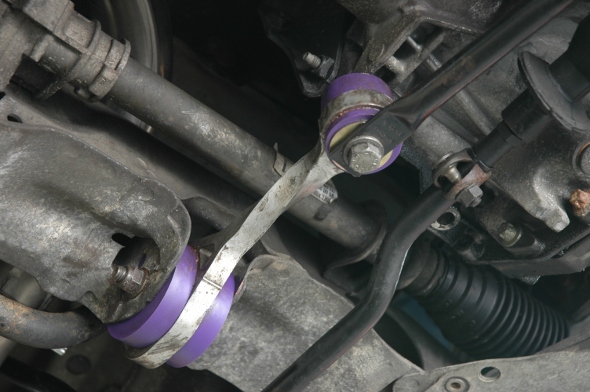

As I don't know my way around under this car very well yet, where is that located?
Under the car, you'll see a twisted gearbox support.
The purple powerflex bushes are a common mod to fix the movement in the worn rubber.
Ah that! thanks, I'll have a look...
TBH it's likely to be a combination of worn parts as the car has just hit 100k and has probably been abused most of its life. (And shall continue to be :) )
Mine knocked too albeit only under hard acceleration in first or second. I changed the bushes in my dogbone mount to polyurethane ones as above and it has solved my issue and made the car a lot better to drive
