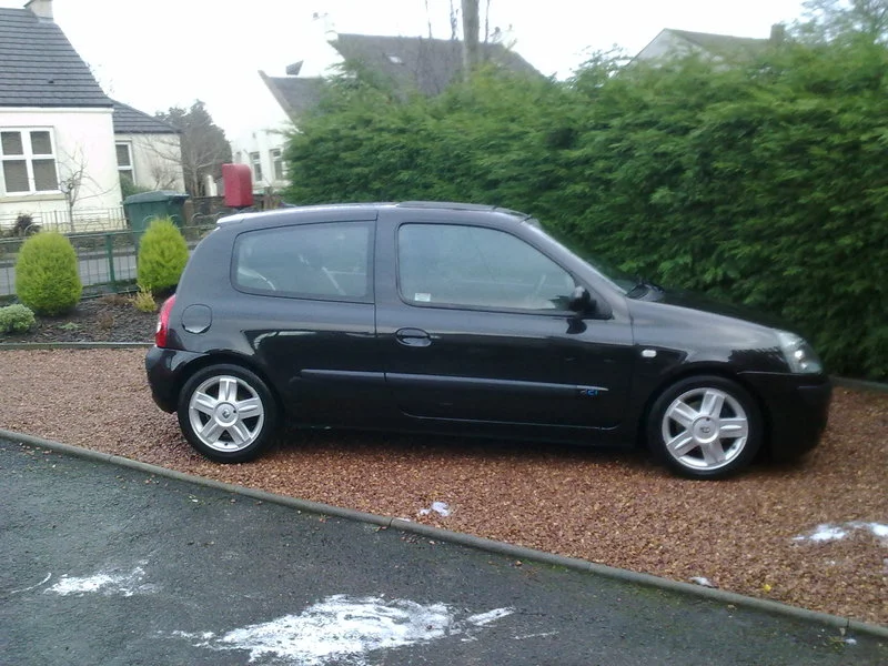

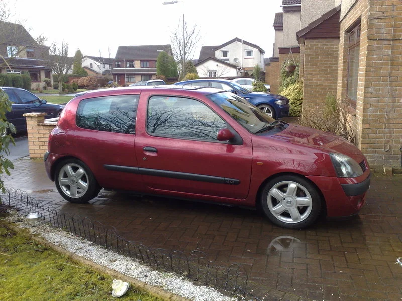

this is how it looked
this was apex -60mm - bumpy and crashy on standard dampers wouldnt recomend them unless running uprated dampers

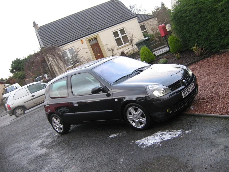

I like the look of ur black 100 how much is that lowered?
