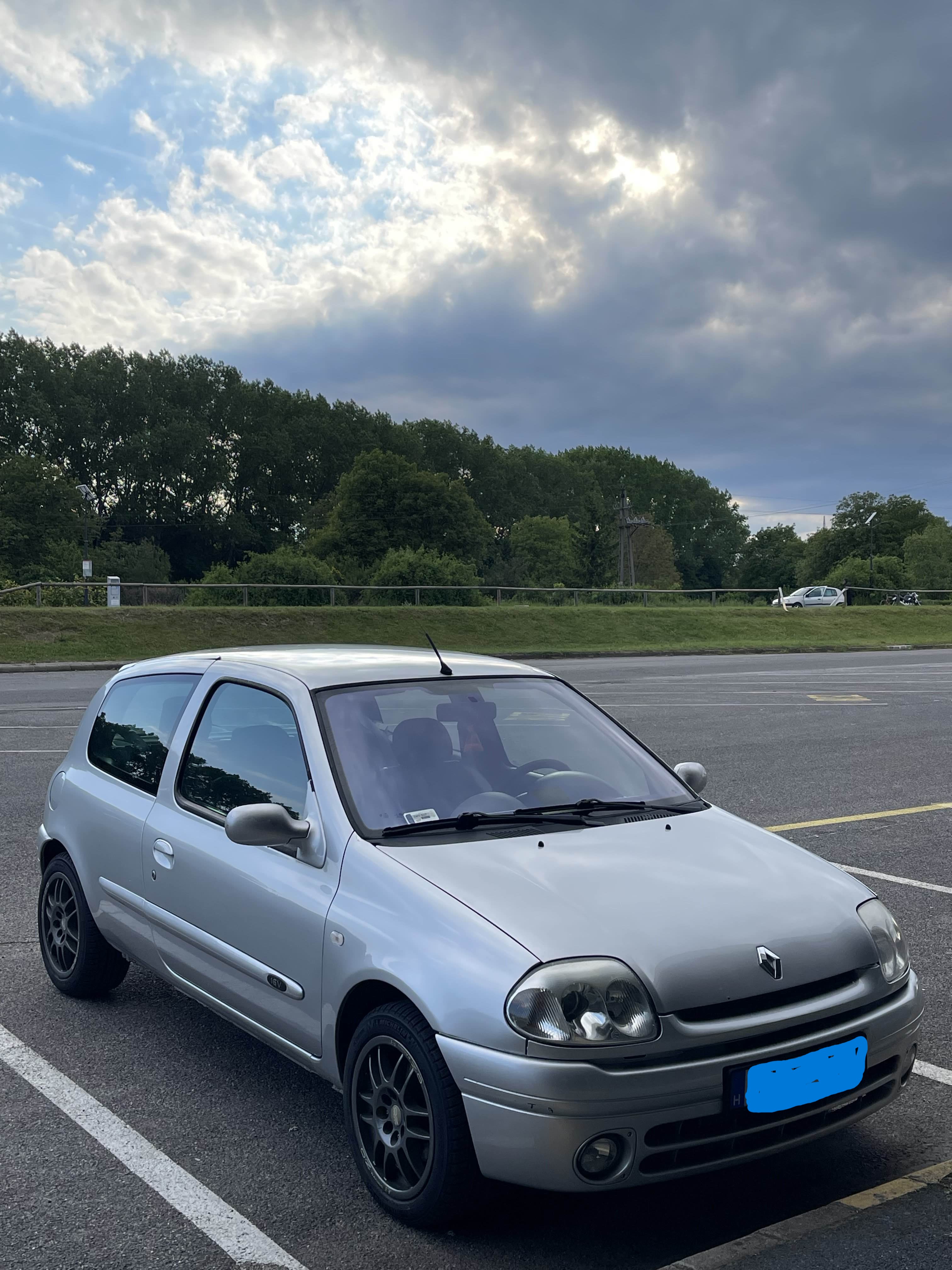

I own a clio mk2 ph1, from factory it had a 1.6 16v engine, but now shes got an F4R 780 out of a laguna, rs clio exhaust manifolds aftermaket exhaust, and a bmc airfilter.
I copped pilot sport tyres, they've been fantastic, but I feel like later on I want better handling and breaking performance.
Every suspension component is stock, what would you guys recommend to make my car more responsive and fun and confident in cornering?
Roads in my country arent the best, but I do go like going out for drives on some mountain roads.
I was thinking of getting Bilstein B4s, and then get some kind of lowering springs?
