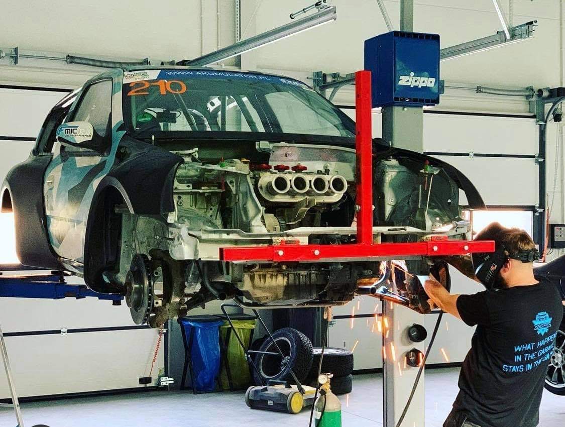

Has this been done ? I’ve seen pure motorsport weld in camber top mount setup so is it worth welding in 197 top mounts and using 197 bottom arms and running swivel hub setup or is it a waste of
