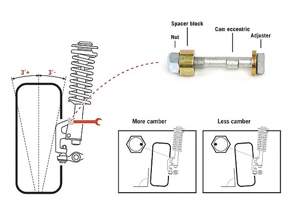

Hey, I will hopefully be getting my bolts today. I don't like it when I don't fully understand how it all works though & I'd like to! :eek:
You may have seen how the front wheels are sitting now, pretty wonky! :S I have plenty of positive camber! Can anyone explain how it works without confuseing me please!
ta :D

this any use?
VIICarCare
  255, 230, 172, R26
oh wow, that explains it! :) Thanks alot mate!
I take it these magic camber bolts will sort it out & wont need anything else!!?
bloody expensive this lowering lark :eek:

Ive got positive camber(wheels pointing in) on mine but havent got camber bolts. Its running fk konigsport coilovers but not massivley low, is it necassery to have them? Apologies for hijacking the thread.
Dan.
  e92 330i
No, but the top bolt hole is slotted so you can adjust the camber with your standard bolts to a degree.
Mines furthest back in the slot and looks enough negative to me tbh.
  BG 182
ive had this problem with loads of positive camber even on the furthast point on the slotted hole will camber adjuster make it more negative then the slot?
