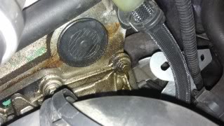

Update 2. Just had a phone call from the dealer.
1. They could not fault the car.
2. The tapping noise is the normal noise from the injectors.
3. The Oil leak picture above, is just sweating. They have torqued up the bolts on the cam cover.
4. I spoke to them about a knocking noise coming from the foot well of drivers side. (when the car is cold and you lift of the accelerator in 2nd / 3rd gear) Nope could not see anything wrong with it.
5. Did not even mention the spark plugs and the oil that the car went in for in the first place!

Have you had any messages appear on the dash like "injection fault" or "anti-pollution fault"? I ask cos the 197/200 is getting common for the cam position sensor which causes a loud tick similar to injectors... CLIP time will confirm this. That pulley movement doesn't look right though.

The pulley movement i only just noticed. I Presume it should not have side to side movement? Could it have something to do with this noise?.. -

Any way. Renault Orpington got back to RUK.
Orpington said:
1. The tapping noise above is perfectly normal. 100%
2. The fault with the spark / plug oil - They could not see any oil down the plug oils. It would of drained out when I first took it out on the Saturday)
3. Knocking noise they could not find...

I have tired to get a better video of the pulley. I can see there is lateral movement on the belt

Yeah the belt is walking a little... maybe incorrect belt tension but let 2Techs do their job and sort it mate. I hear very good things about them.
