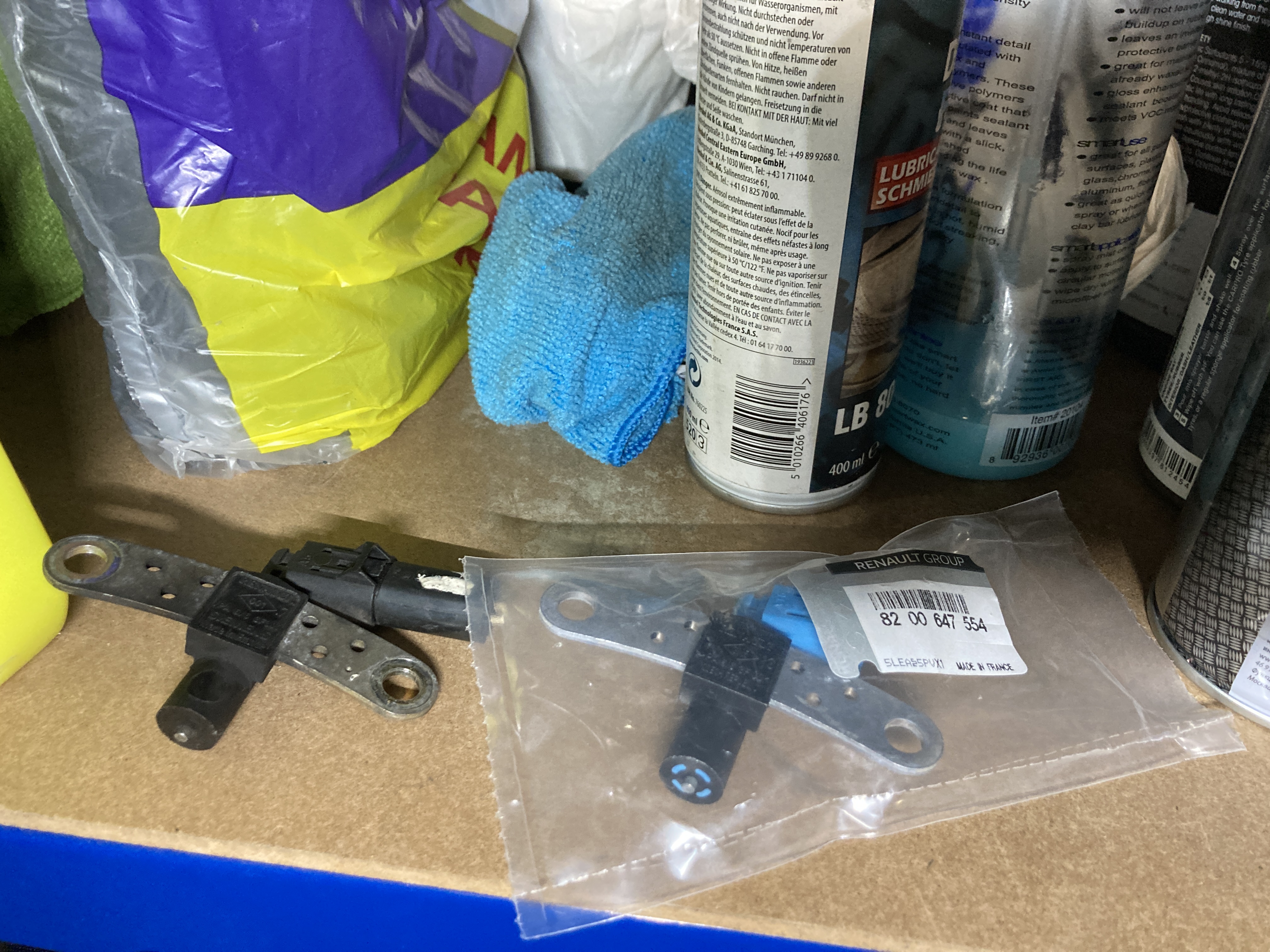

i have a new TDC sensor and loom to fit, supplied by Renault with the updated blue connectors.
The loom is supplied as a connector with two wire tails, which clearly need stripping back and joining up with the car-side loom somehow. Two, what can only be described as, small clear plastic 'tubes' are also provided, presumably to aid the joining up.

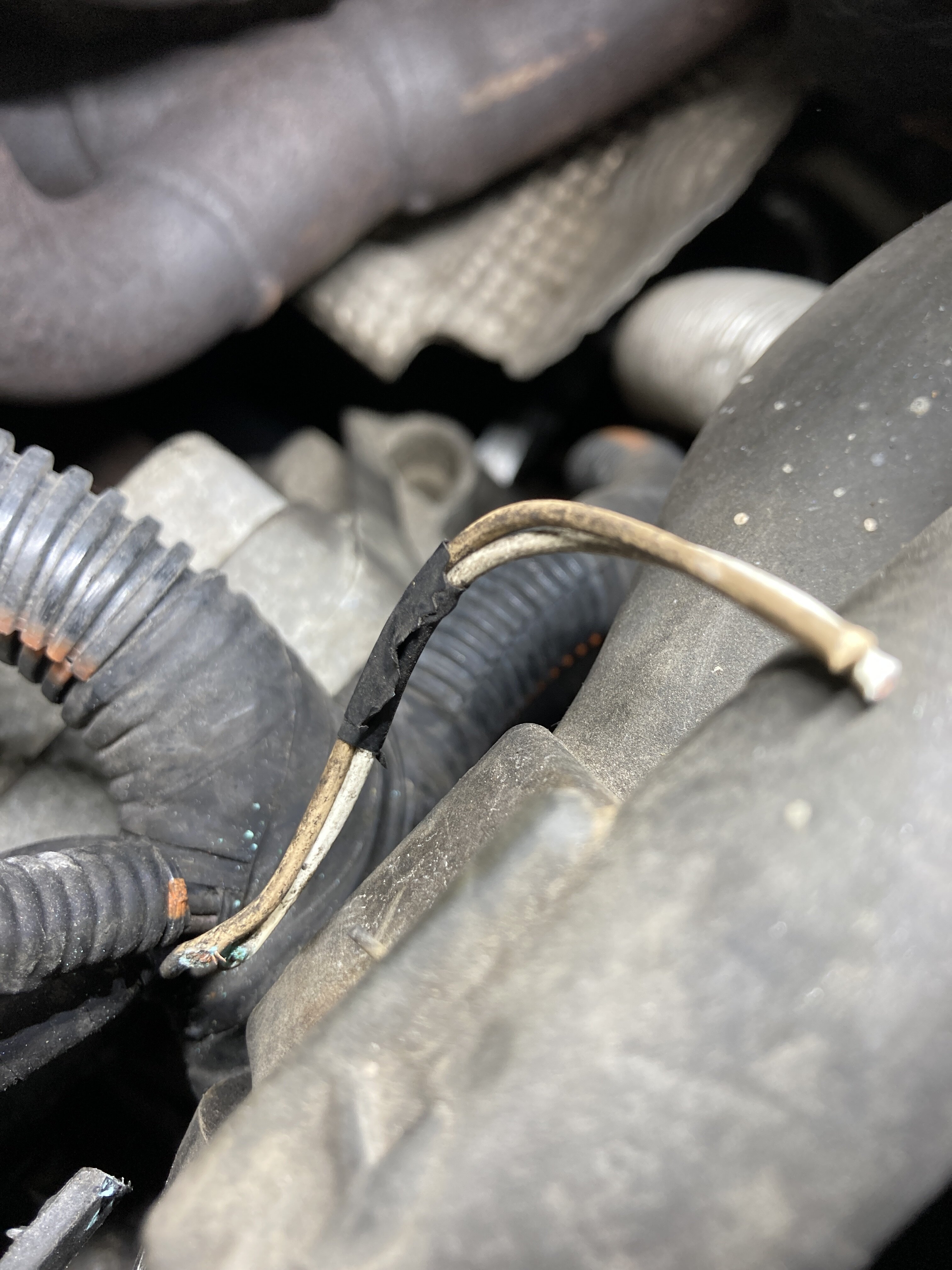

Old wiring had a couple of bends with wire exposed plus corrosion, the old wiring was thinner in total diameter compared to the thicker shiny new version.

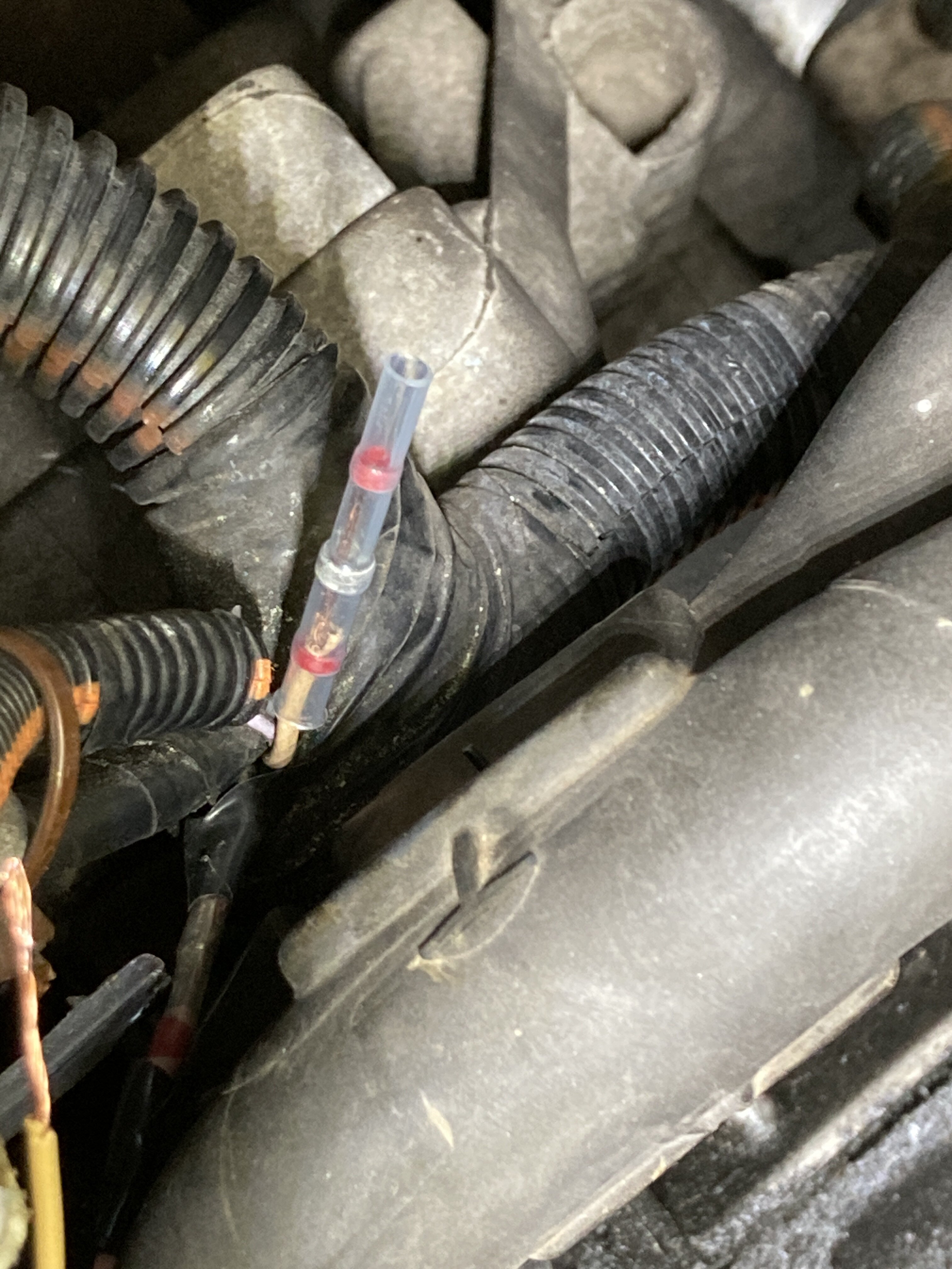

This video was really useful in using the supplied connectors:

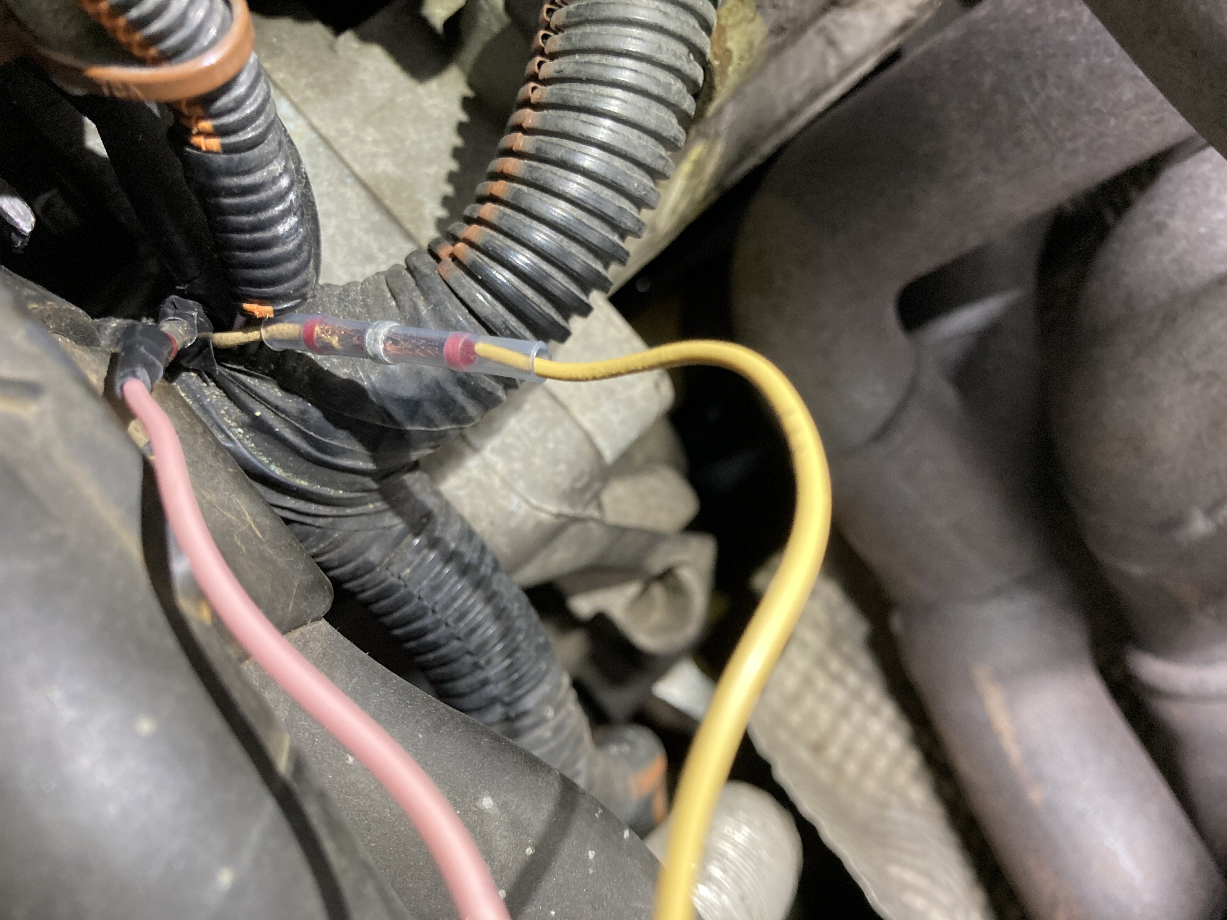

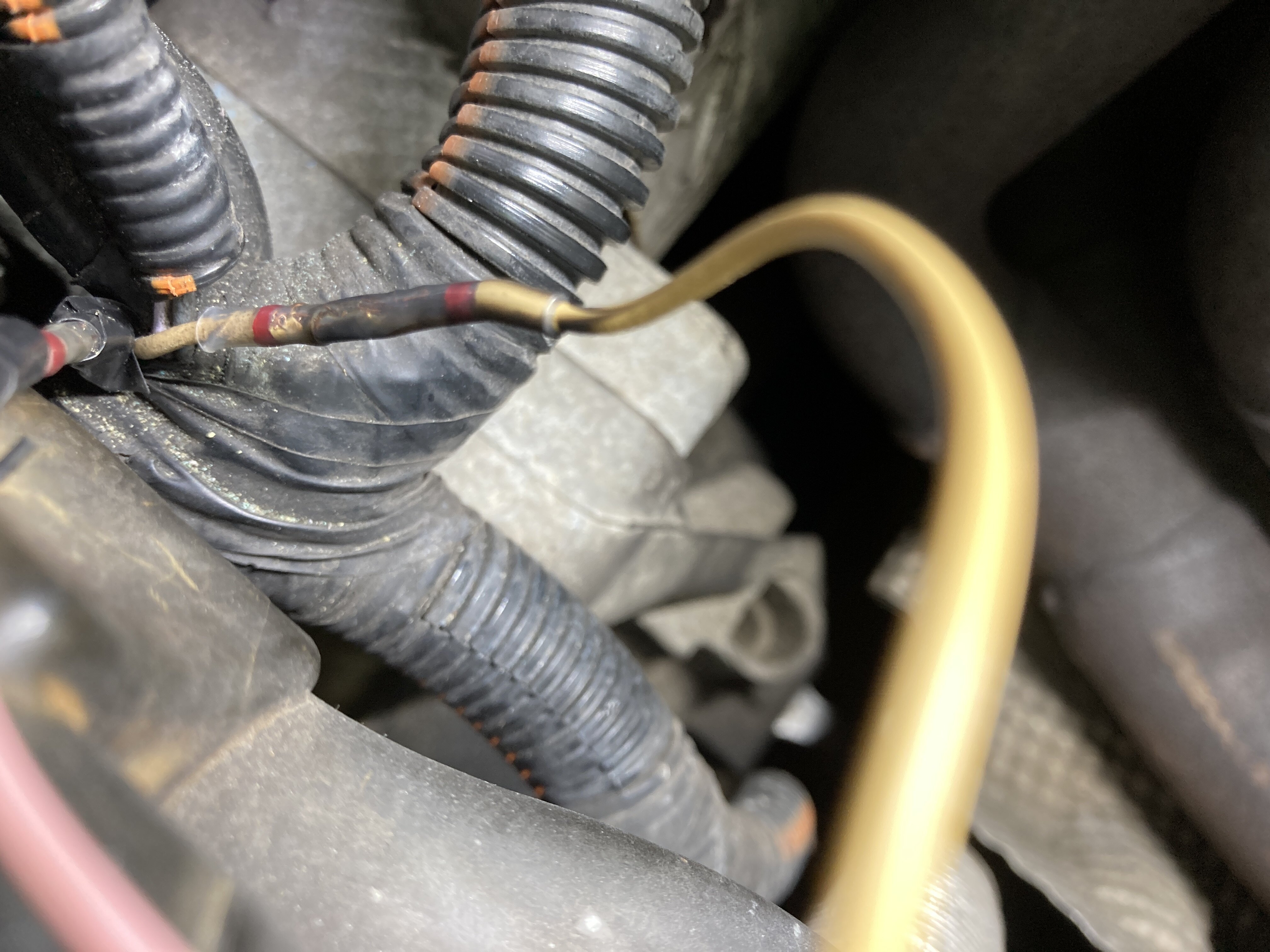

I was surprised; only need to push the wires together and not wrap / twist them round each other. Heating the solder with a lighter melts it and makes the connection (solder seen melting / bubbling) I took a leap of faith & heat activated the connectors, hoping it worked first time. Then put some e-tape at each end.

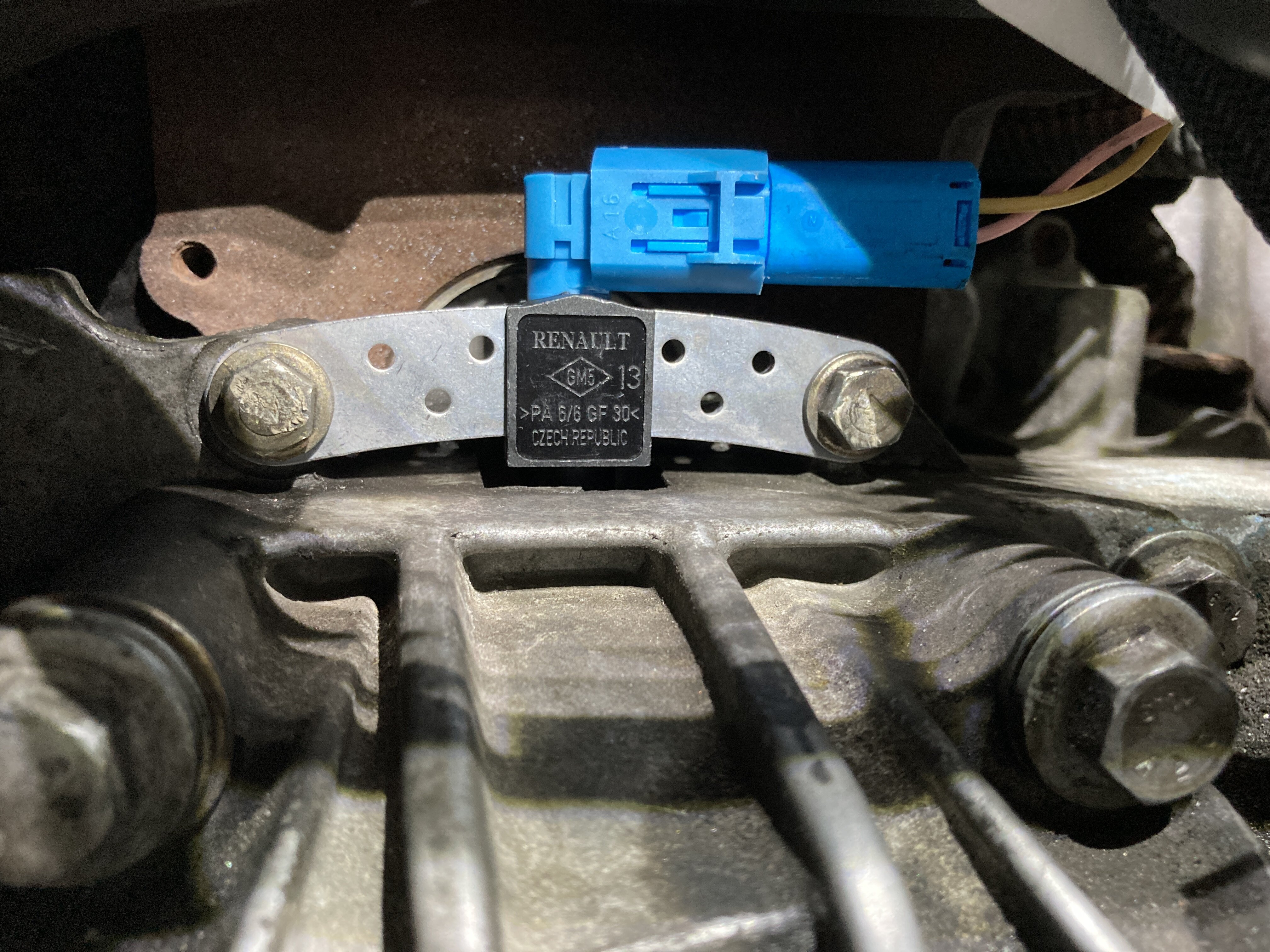

Two 10mm nuts holding the sensor in, clip to the new wiring / loom & started first time :)
