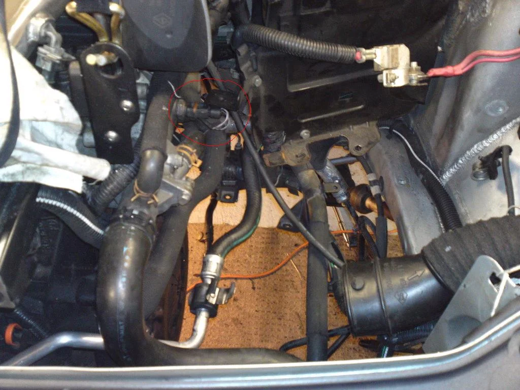

My temperature guage is playing up, somtimes it works fine and then like this morning it seems to fluctuate up and down, never above half way though
Any ideas please
Mines been doing the same, from what I've read its probably the thermostat. Going to get it done when its in for a service next month, see if it makes a difference.
Oh, sorry mate, dont know then. I tried the thermostat first but was still fluctuating so then changed the temp sensor and it ok now. Long shot but could be a faulty sensor.
Yes easy to fit, loosen clips on two coolant hoses, then there is 3 bolts holding the thermostat housing on, housing comes off, take thermostat out, put new one in with seal, then put back together
What about the coolant when you take those pipes off?
Oh right, sorry mate, thought it was an obvious one, yes the coolant will need topping up after
Had this on mine. Just cleaned the plug and its been fine since.
