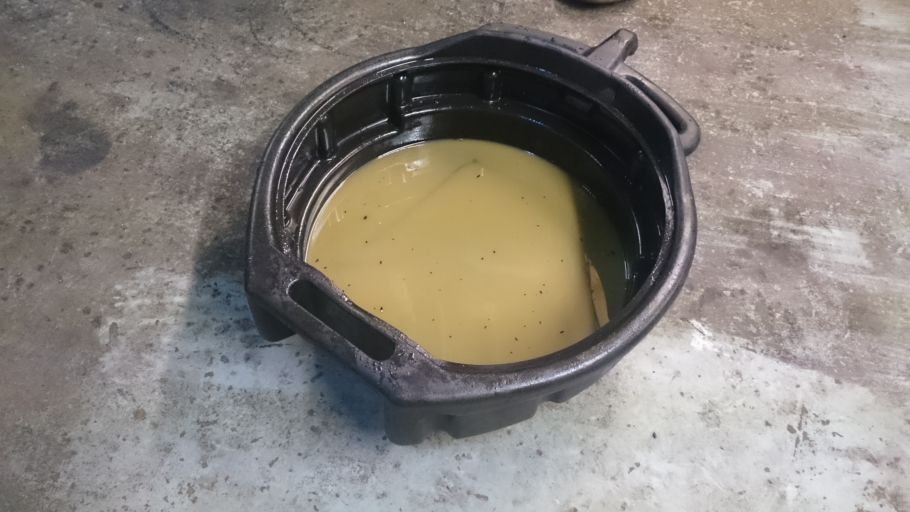

Update
Coolant dropped when changing the thermostat and...
Well f*ck.
Keeping an eye on it over the coming days and weeks to see whether it is oil that has caused this. Its got fresh pink stuff in atm so as long as I check oil levels and coolant levels/quality it should give a good indication of where it is coming from.
The £3 thermostat is in and working a treat so I suppose thats an upside lol as I say its only until i dive to renault and grab a thermostat, just currently buying everything else for her (brake discs and pads, calipers, handbrake cable, service kit, dogbone polybushes... you know, all the important stuff).
  Pearl Black Clio 172
Wow - that's nasty looking coolant!
Did you drain the whole system?
We drained as much as we could - we were in a rush as I had to be gone within about 30 minutes, so we whacked as much water through as we could then stuck some proper coolant in there (and it is as pink as it could be, therefore ill spot any brown immediately).
I dont care about certain repairs, but stuff like a cracked block or something would mean this will be a quick ownership!
