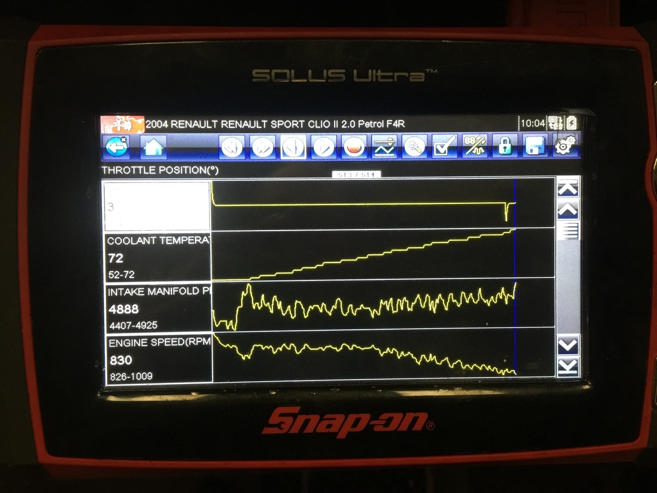

i have screenshots of my data and one thing is very apparant to me. The intake manifold pressure.
This sits (with engine off key on) at 10056mbar, but when disconnected it fails to its defualt value of 1040mbar. the barometric reading also starts at 999mbar until you disconnect it, it then goes to 1015mbar, i now understand it takes the barometic reading once before starting then relies on the actual manifold presure sensor, which in my case seems to be extremley high, unless i am reading it wrong, i am open to opinions and comments

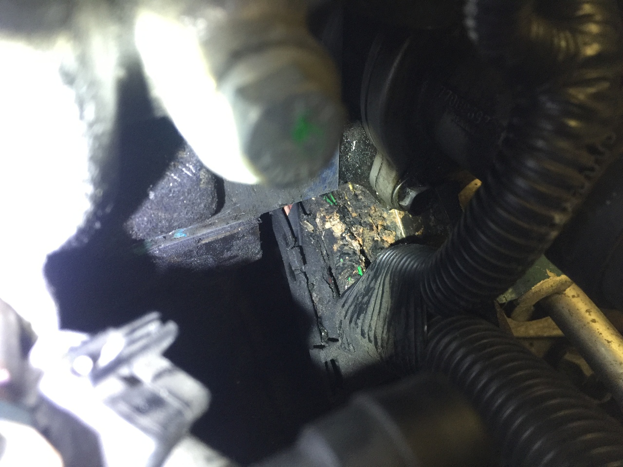

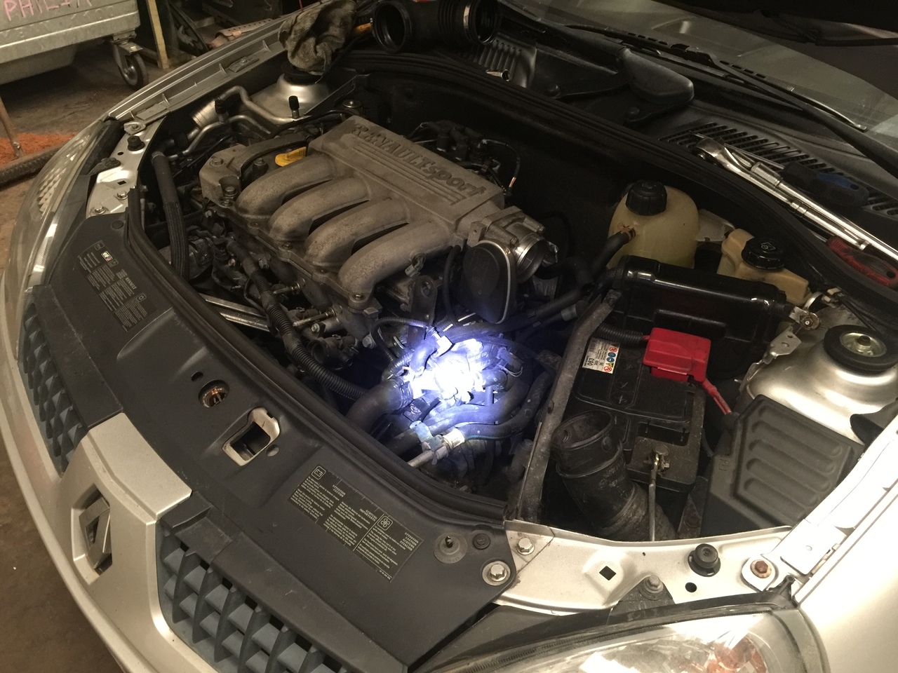

I have noticed one point of engine wiring loom contamination. Its the wires under the front of the water thermostat housing, i have noticed both oil and antifreeze mix through the entire length of the plastic frame support, it had gone quite hard ont he surface and caked the entire loom. i have upon leaving the igntion on by mistake noticed the famous buzz from the throttle body to actually change note while fiddling with the wiring that comes from the ecu to the gearbox, the contamination area and the throttle body wiring clip itself. i have videos of this. i highly suspect a wiring fault but after wiggling and moving many many many wires and trying to eliminate containmation the throttle body no longer changes no matter what i move and there does not seem to be any ill effect when the engine is running.
I have been out for a run and the lowest the revs got were 650rpm. again, everything else is perfect, pulls good. but the low revs on idle, and the richness. and the manifold pressure reading. (after checking wires back to ECU with no leak or short.) its just insane. unless i am reading it wrong. i have alos replaced the map sensor. to no avail.
could it be the timing as thats the only real answer i can find on here. that can cause a high manifold pressure reading but not always the case. or wear on the pully. i can see signs of oil leakeage at the bottom of the timing cover but the previous owner obviously did not care about oil spils over engine so its hard to say if its from the pullys or the overspill.

contamination area

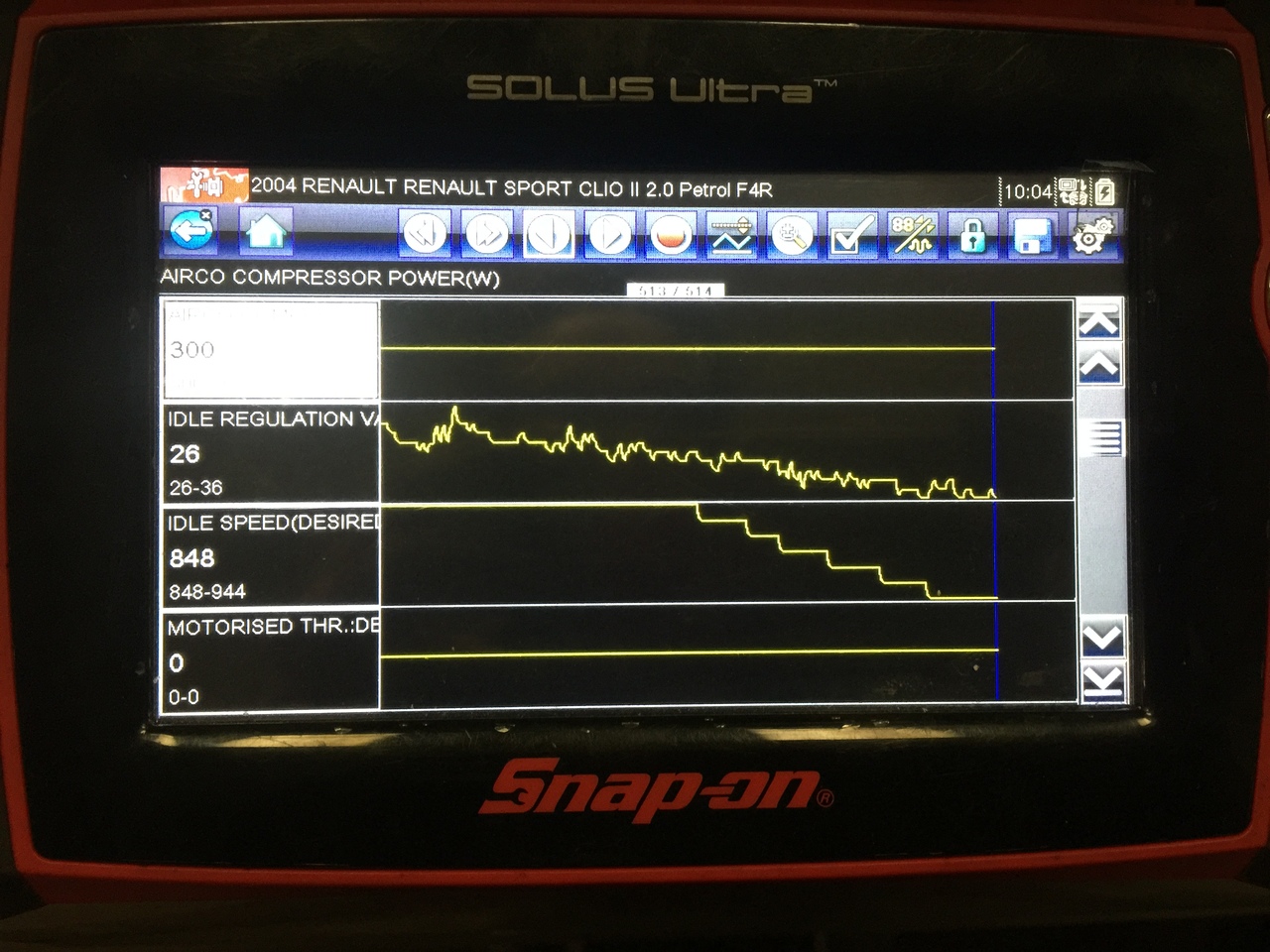

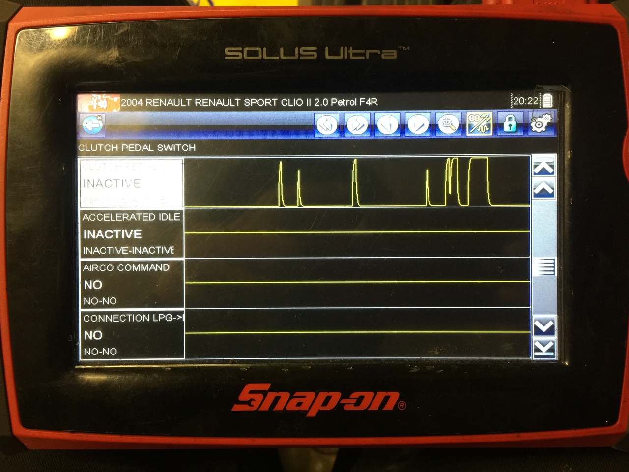

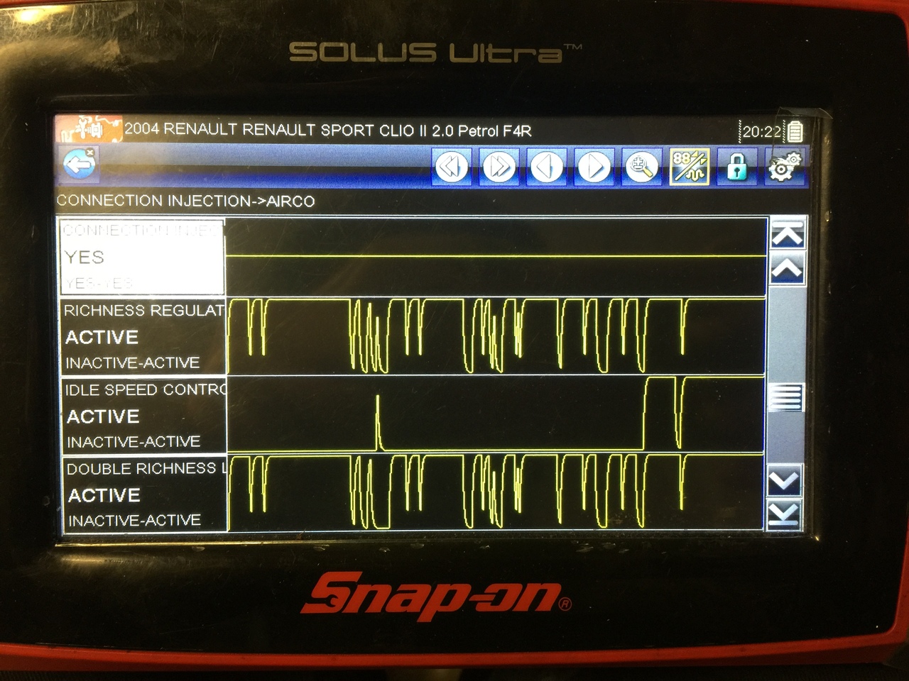

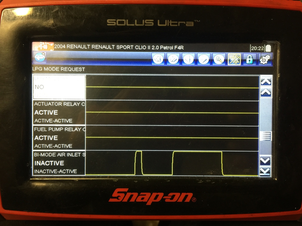

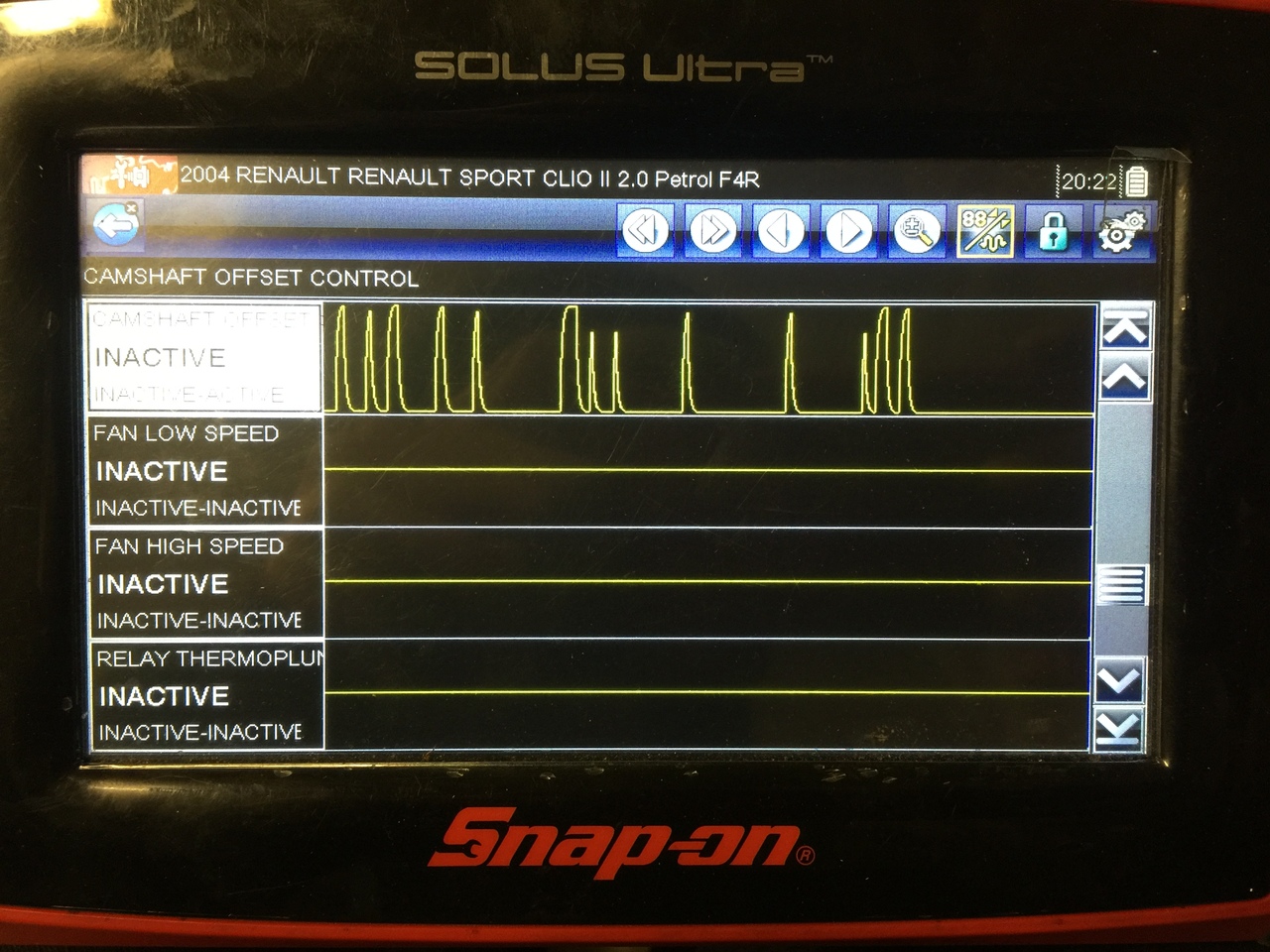

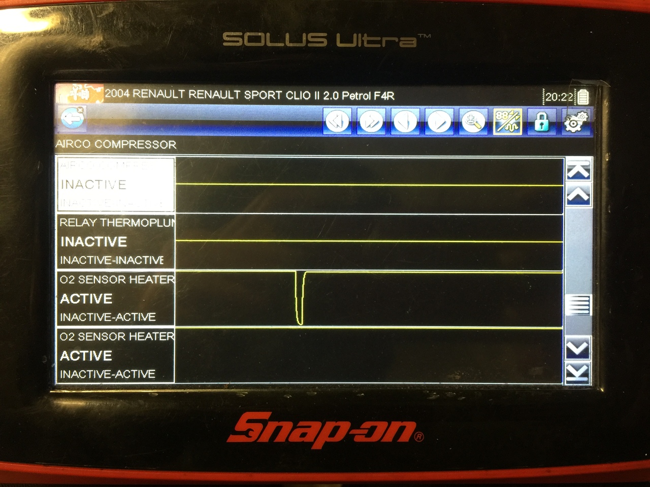

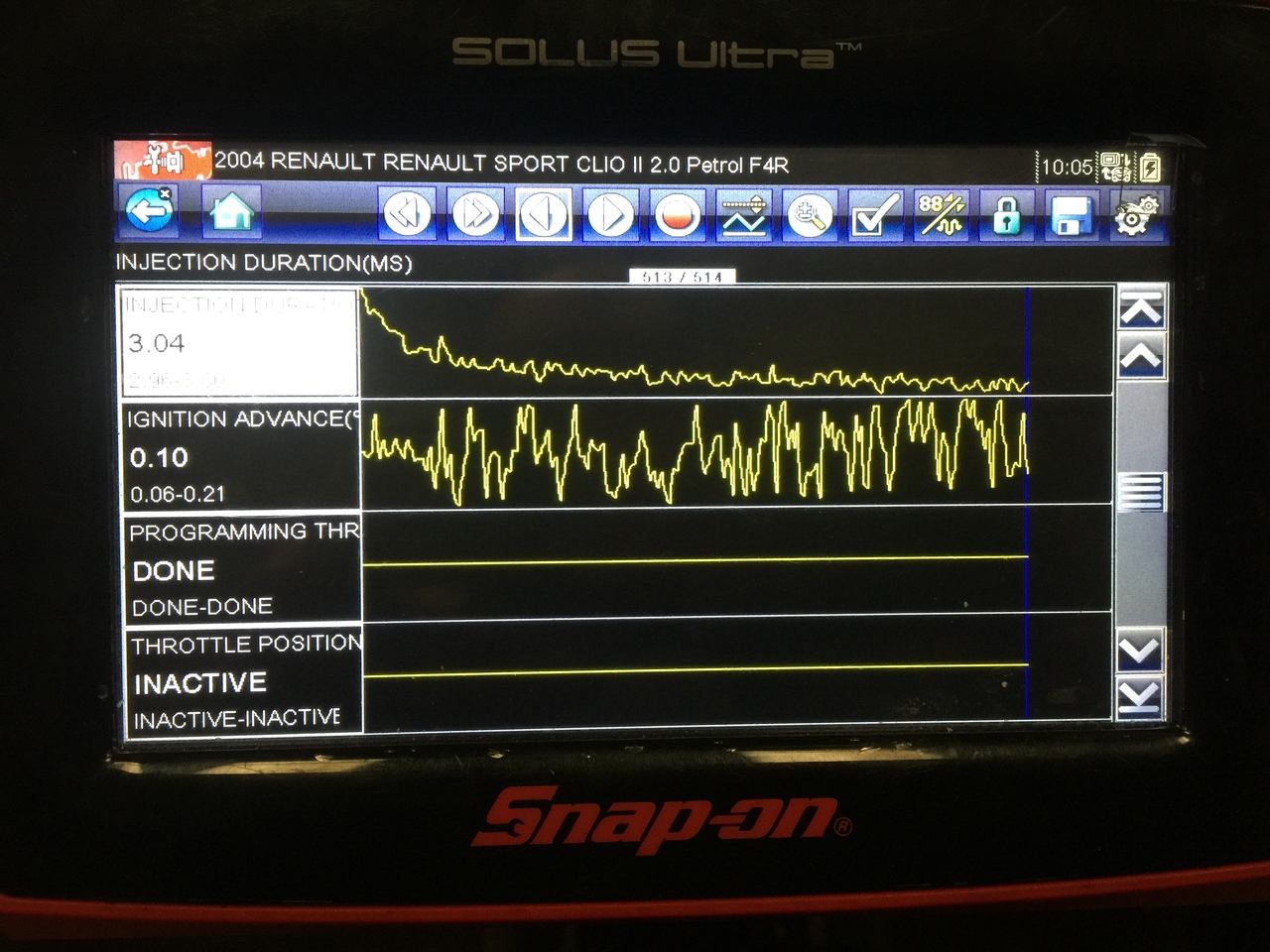

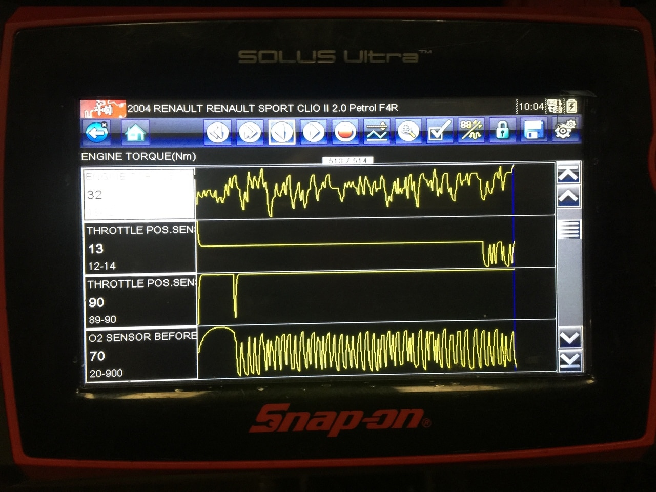

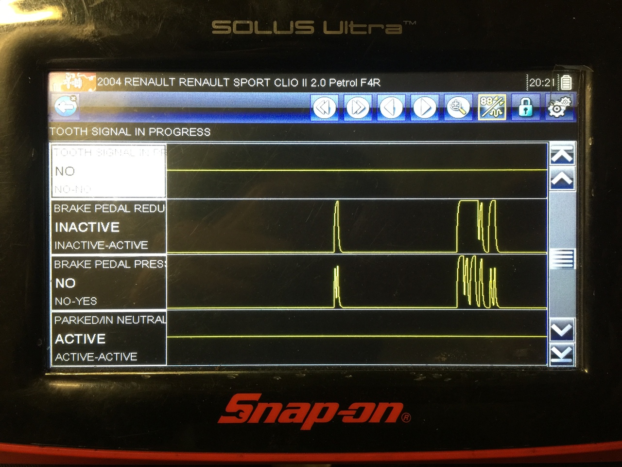

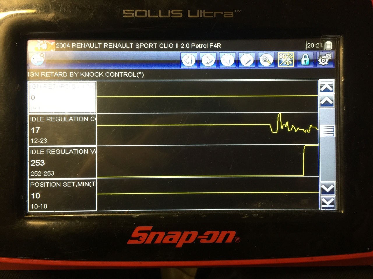

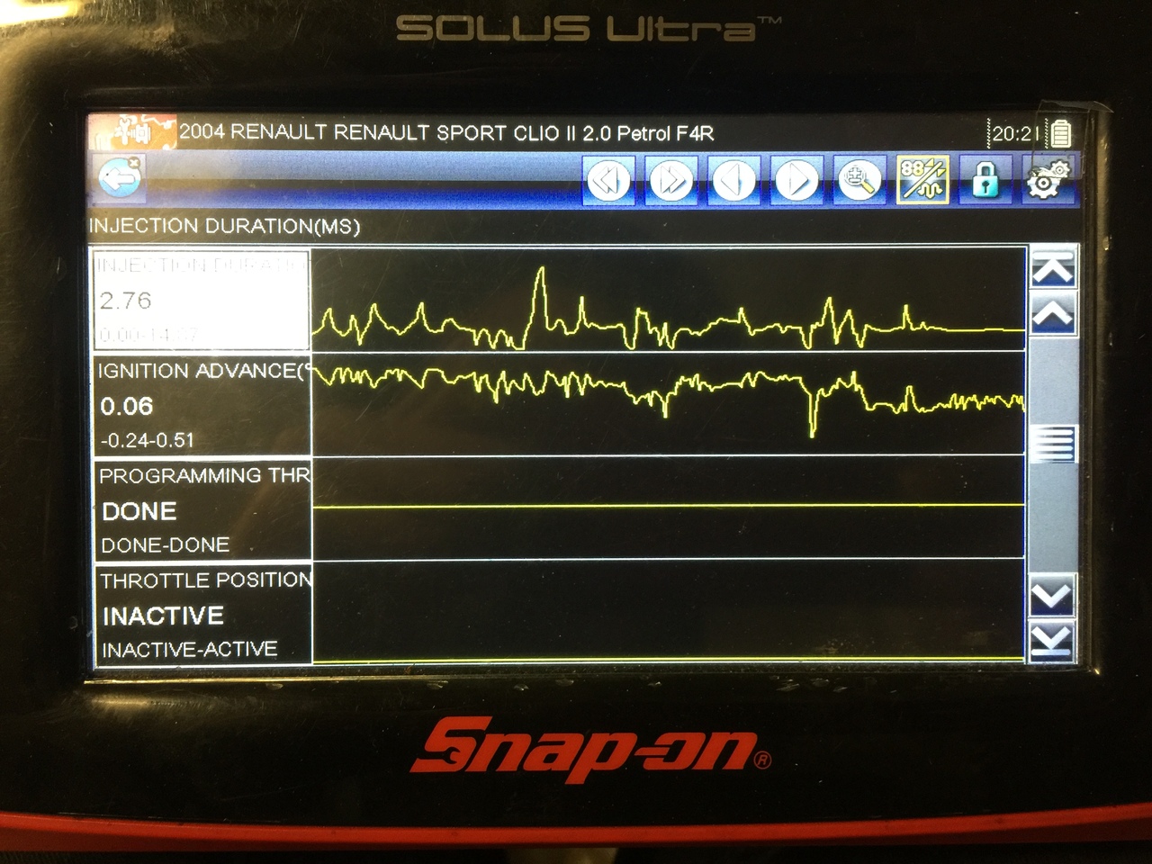

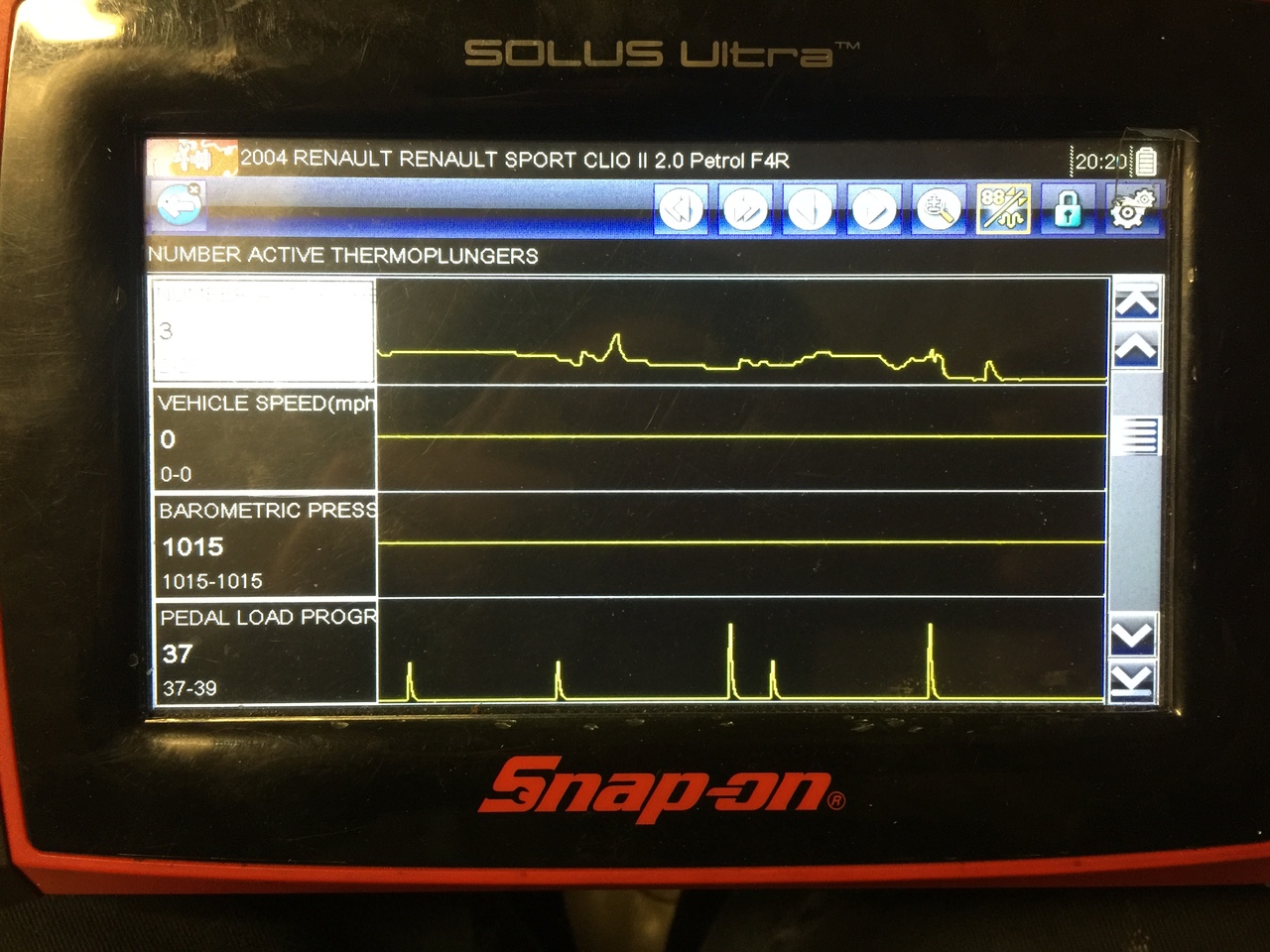

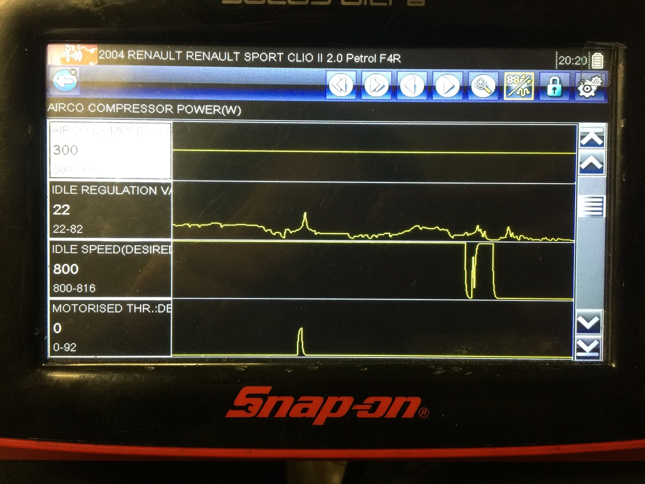

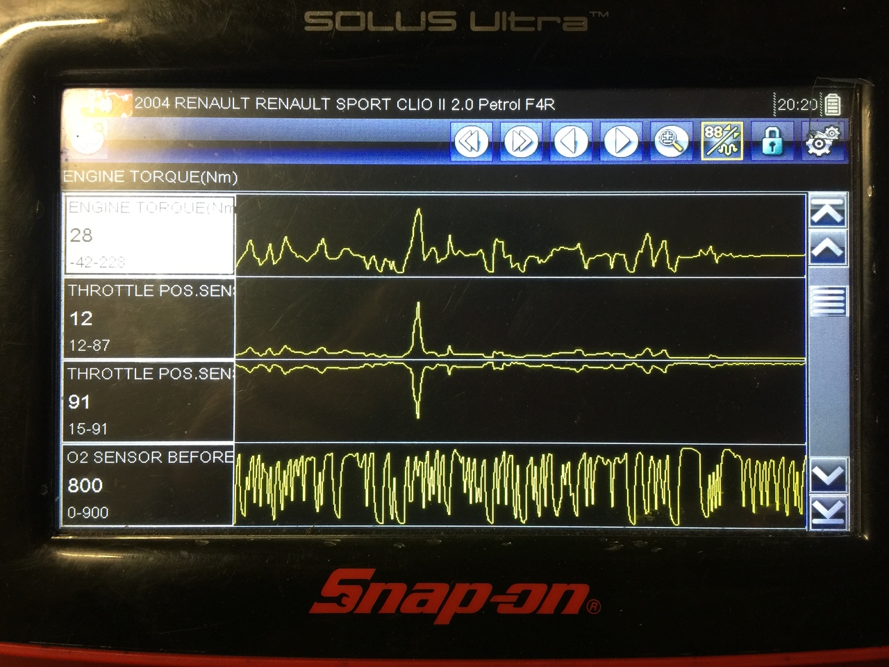

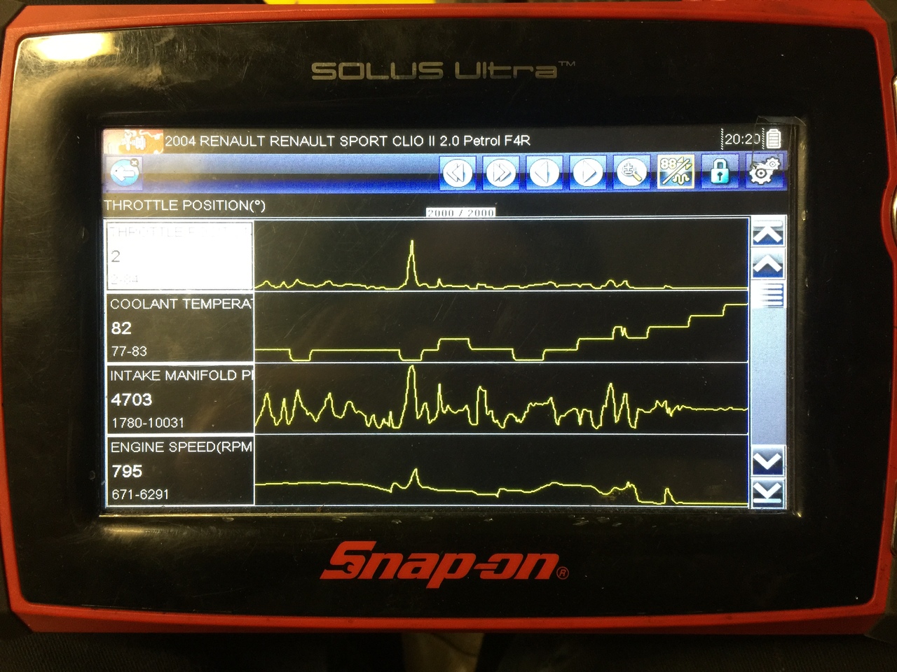

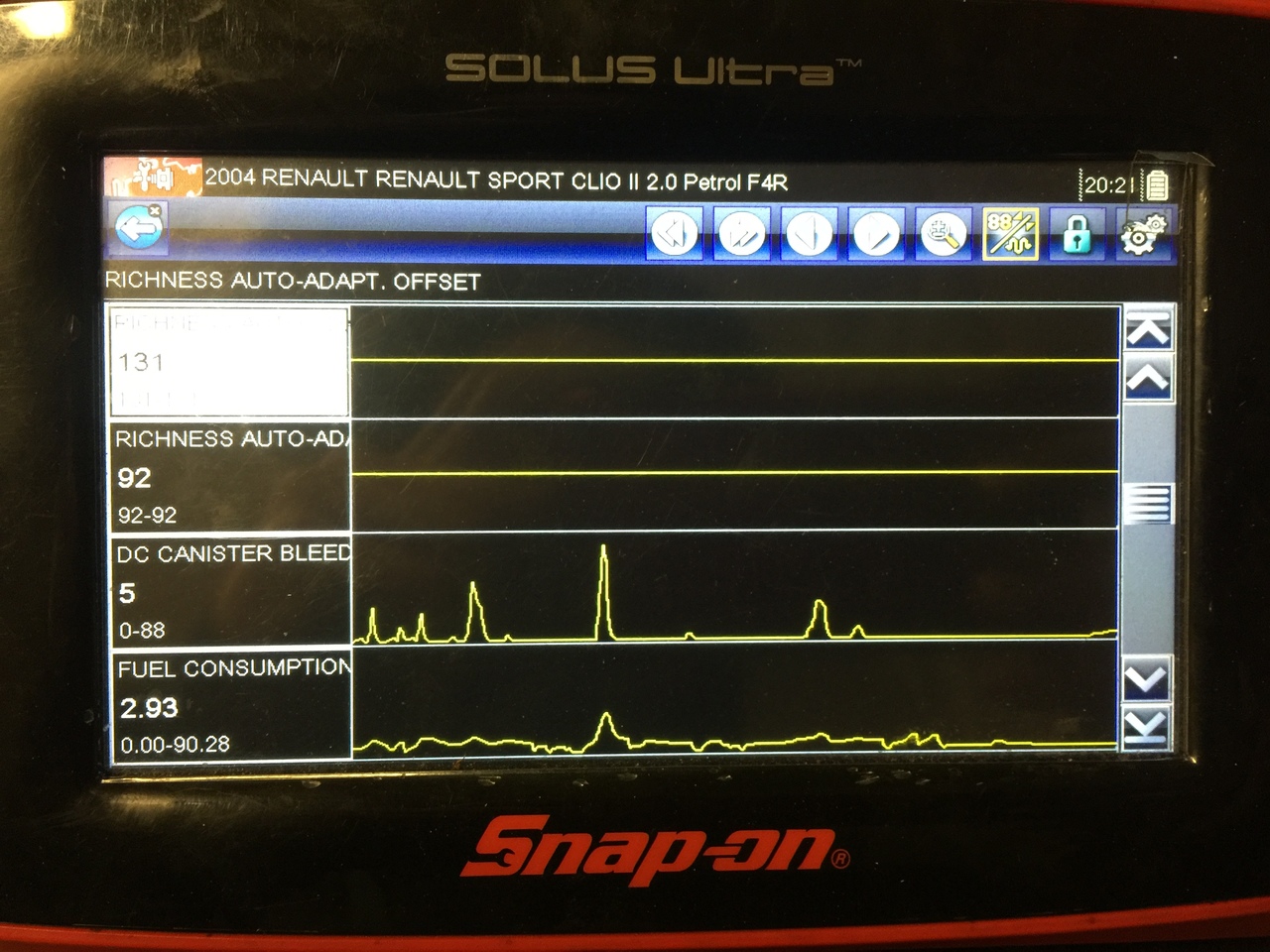

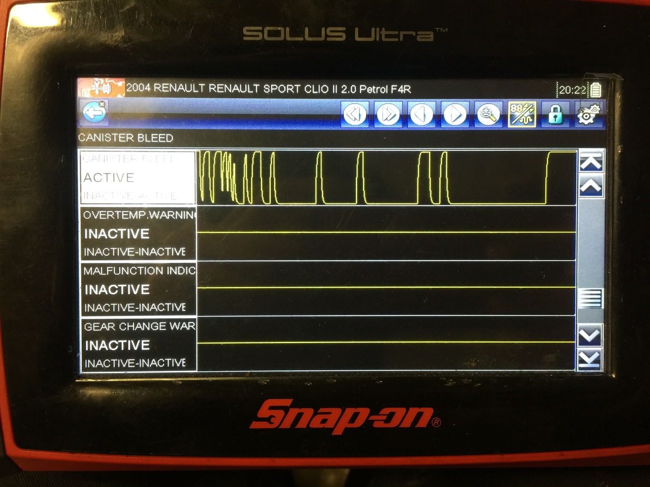

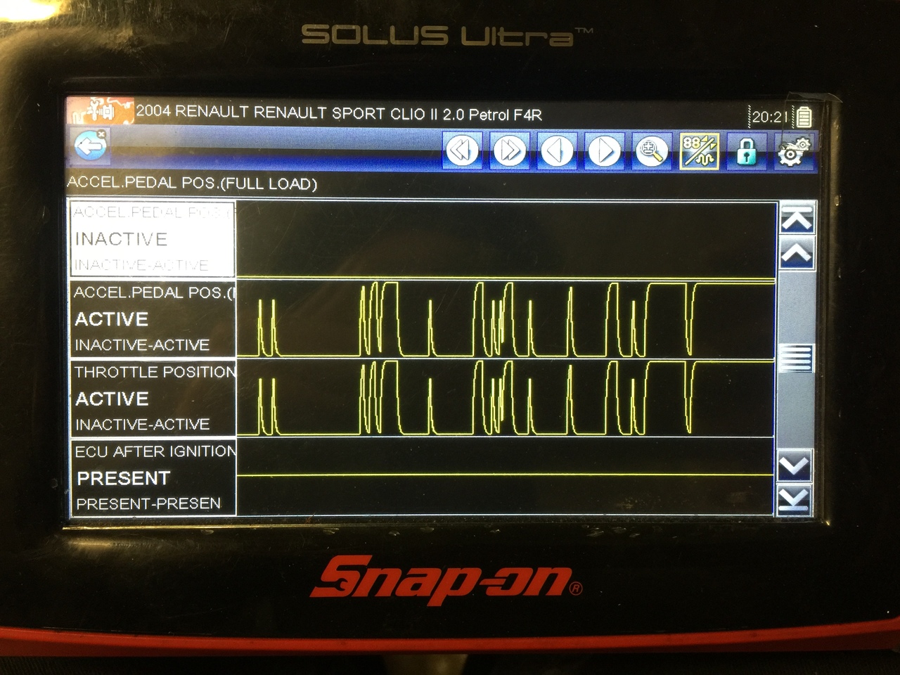

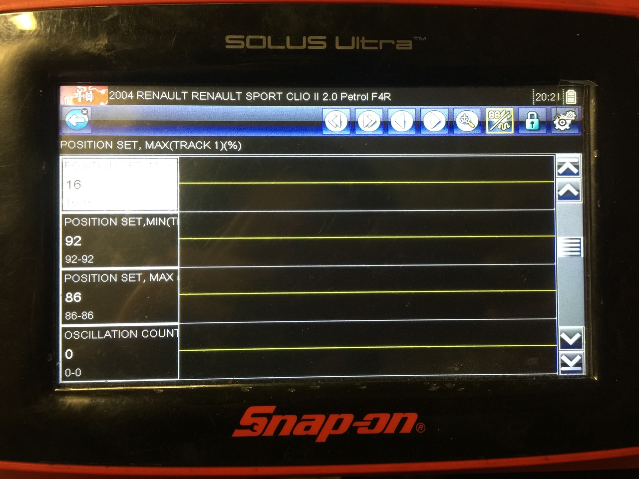

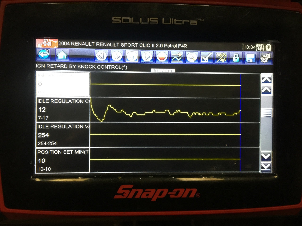

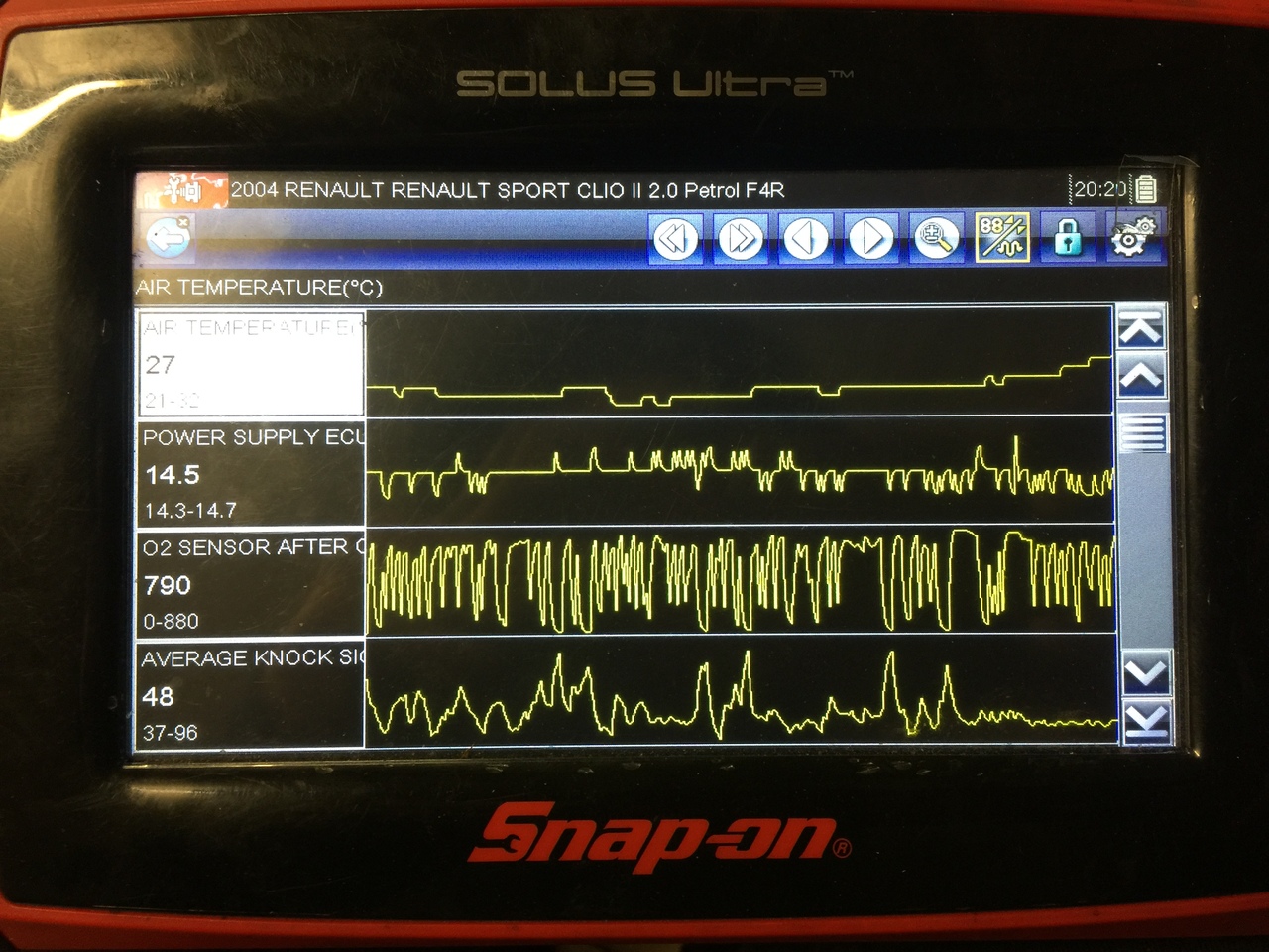

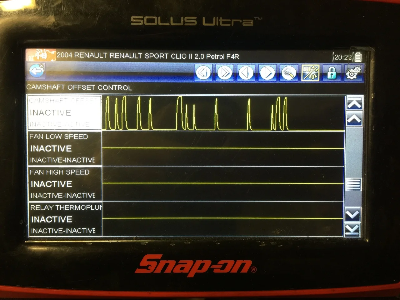

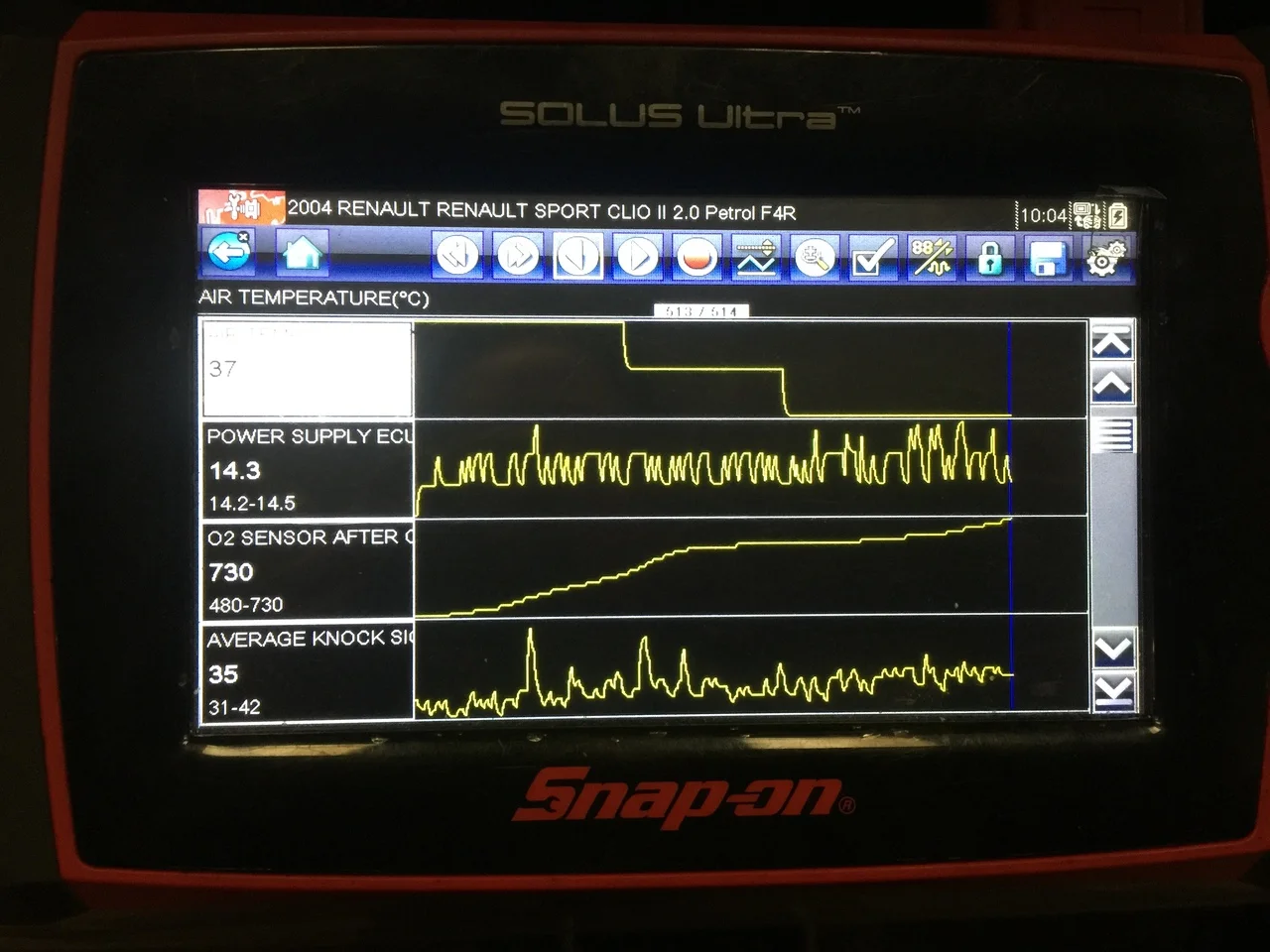

These following screenshots are from test run, reading the data as i go.
Apologies for the sheer bombardement of photos but it makes for an interesting read.
Thank you
The numbers:- left - lowest recorded (-) right - highest recorded
These engines are notoriously lumpy and run rich from cold. One thing standing out to me from those live readings is that the coolant temp never reaching 90 degrees. Maybe the car wasn't running long enough, but if it's not reaching proper operating temp then it's going to be constantly lumpy. It might be something as simple as a stuck open thermostat or dodgy sensor causing it to run like that.
O2 sensor readings sound fairly normal. Pre-cat will jump around as it's controlling fuelling. Post cat is just there to tell if the cat is doing it's job, but if it's decatted then it's going to be getting the same readings as the pre-cat sensor so should give similar readings if they're both working OK.
loom definitely needs a good check over, oil can be fun with can wires.

Checked loom fully. No obvious signs. Cleaned and replaced.

The manifold pressure concerns me. This is stated in mbar and if I disconnect the sensor with engine off the default value of pressure appears. You can see for yourself the actual lowest and high.

MAP signal shouldn't go much over 1000mBar - certainly no more than 10mBar above ambient.
Try swapping your MAP sensor with a known good one.
